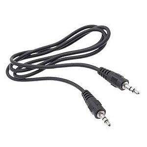

    Otherwise your "cheapest option" is:
    (and of course you'll need an approved car mount for it)

      Wow....300+ is quite dear. I did try the 3.5mm cable method, the quality was really really bad. Is 9w7 plug and play? Does it need vagcom?
