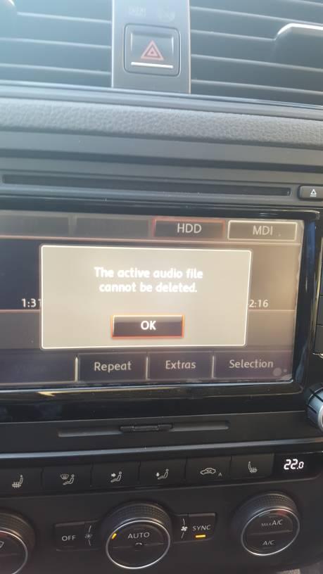

            • I have an issue with deleting the folders from HDD, which is really annoying. Yesterday I upgraded FW to 5274 from 5270, but it did not format the drive. I tried to downgrade the FW yesterday to 5218, but it was not installed properly and gave an error. Installed back 5274. Now when I am attempting to delete any folder from HDD drive, the message with "deleting files" is stalling for a while and nothing happens.
              Looking for any solution.

                You can't delete the last file it's a silly limitation.
                If you add another folder and file and then select that one first, then you can delete the one you don't want.
                The issue is it starts loading a file when you select it but don't play it, so I leaves an open handle to the file leaving you unable to delete it....

                  I tried to play media from USB flash card in order to not make a HDD active and delete the folder, did not work. Tried to play a file on HDD from one folder and delete another one, did not work. I even can't delete an empty folder.
                  Would downgrade from 5274 to 4120 work? Shall I try this one?

                    No that won't help.
                    If you want the HDD totally blank of music you need to format the partition with a firmware cd

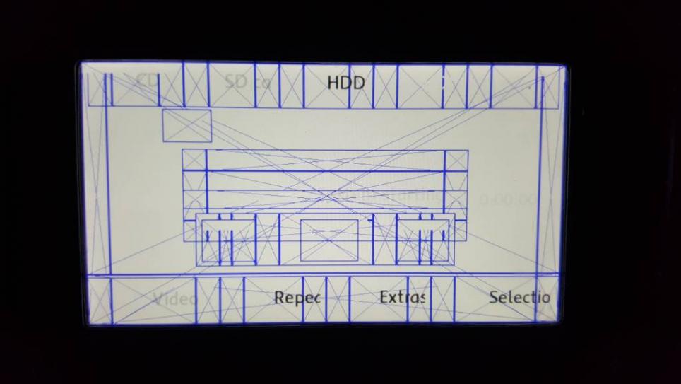

                        My RNS510 381B (japan) recently died and there's no text whatso ever on the menu. Sometimes it boots (without text) and sometimes it stucks whitescreen after boot image.
                        I'm trying to load the many firmwares from 5238 josi down to 1100 factory and modified as well as SWL fix. nothing works except stuck at SWL error 010306.
                        Is this HDD issue? I replaced a new same HDD but still the same. Some says it's the CD/DVD quality of the firmwares but i'm not sure. seems like its something else. maybe the firmware is not right for the Japan unit? appreciate your help and views. tq.

                          You need Japanese firmware.
                          Can't help you with locating that unfortunately.
