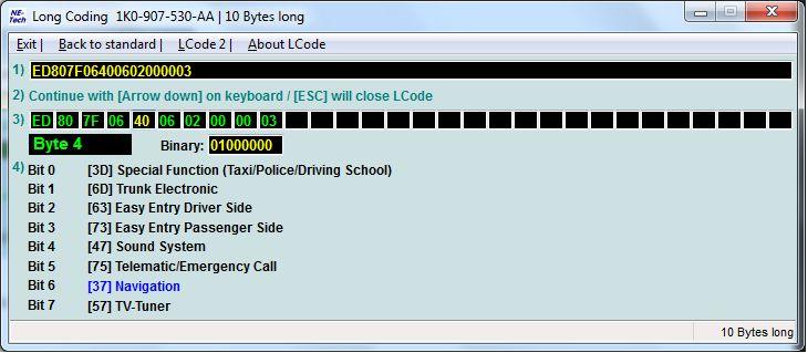

                    You should only have to tick the Navigation box (19 - CAN Gateway, Long Coding, Byte 4, Bit 6), then turn the car off and back on, and perhaps reboot the RNS510
                    Then go into module 37 - Navigation and check these settings:
                    An independent forum for Volkswagen Golf GTI enthusiasts. Forum features technical help, news, events reviews and humour! Join fellow Golf GTI owners online.
                    Unless something has changed since the MY10 Golf/RNS C unit.
                    Audi A3
                      Thanks for the response, appreciated. I had not done the first bit... BUT:
                      My equivalent screen above under 19 - CAN Gateway, Long Coding, (as well as mate's who has an R) looks very different to the above screen (screen shot here: https://skitch.com/javab0y/8dine/img-0219.jpg)
                      Click for large view - Uploaded with Skitch
                      Any ideas?
                      I did get the needle dance and the emergency contact button number change happening though!
                      EDIT: Found it, I didn't have to do the above Step 1. Just had to go into 19 and then go Into "Installation List" and then Select 37 Navigation and that's it!
