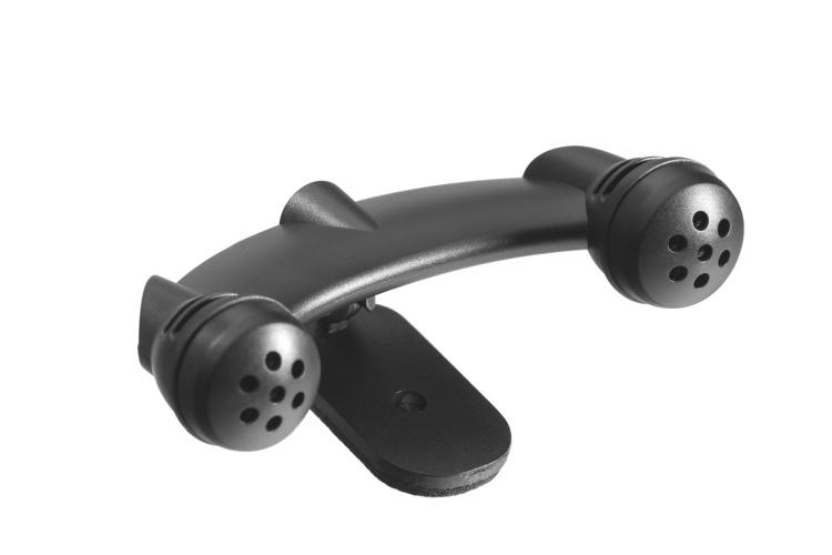

    on top of the steering wheel there is a Parrot brand mic that looks like this - it is sitting there loose - maybe they didn't install it properly:
    any advice on what bluetooth unit this is and whether or not it can stream music would be great!
