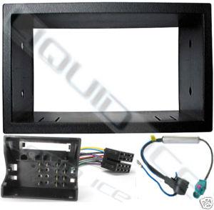

    I got a stereo fitting kit from liquid ice - comes with double din insert, harness adaptor and aerial adaptor - means no cutting of standard wiring to instal.

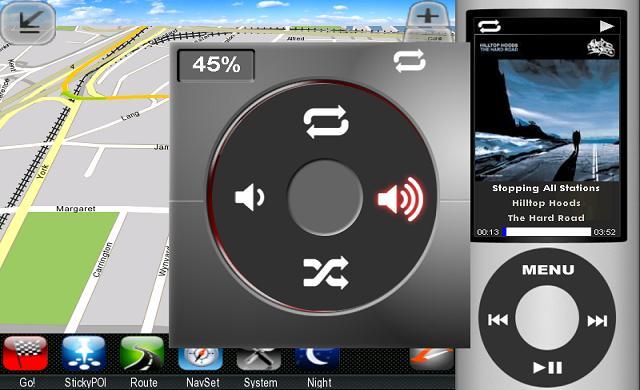

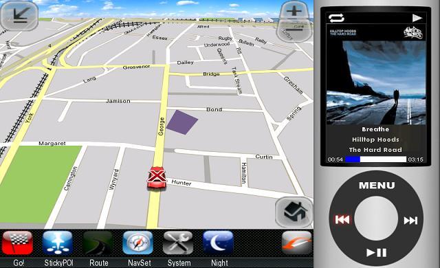

    I wanted to have both gps and music control on the main screen so i went for a ipod/gps look. The ipod allows usual control of music, fwd, rwd, pause, repeat, shuffle, volume, etc

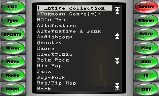

    I use a menu/play list combined to control basic functions - music selection, database update, mixer, video, radio etc

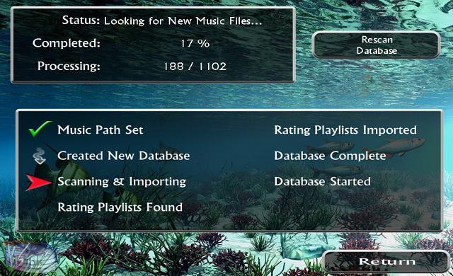

    For music selection i use RRMedia plugin which is a database program using the mp3 tags to store by genre, artist, album etc

      I have changed the skin on the front end - yet again. This is the good thing about the Road Runner front end - the skins are really easy to change - just a bit of photshop. note that the blue and the red are quite good matches of the nighttime colours of the dash
