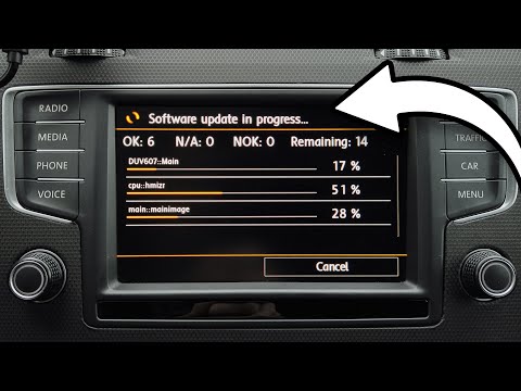

    maybe the excellent video from the venerable Mr-Fix below might help?
    Don
      Yes I've seen that but I don't get that far
