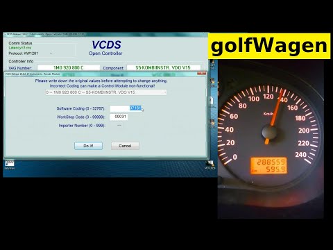

    I can't help with the bit about providing VCDS (it's a long drive from Melbourne) - but the video below may be useful in calming your concerns about the actual tweak process.
    Don

      Video basically illustrates procedure that I've described above.

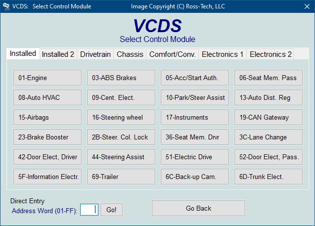

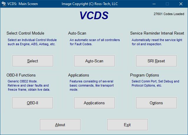

        2. Got to the Main Screen - click-on "Select" on Select Control Module
        3. Click-on 17- Instruments

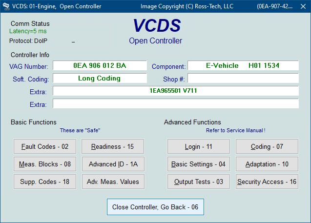

        4. The screenshot below is for the Engine module - but it's the same for EVERY module in the car. The ONLY variable across the various different modules is the information in green in the dialogue boxes on the upper part of the picture below
        In essence, VCDS works like this:
        • by selecting 17-Instruments (above), the software sends a request to the car to open-up the module that lives @ address 17 (which controls the Dashboard equipment). VCDS software also asks the module to return back basic information about itself. VCDS then uses this returned data to populate the dialogue boxes on the upper part of the screen above
        • I suspect that the screen layout is designed to convey a message to the user that ALL of the selectable option-boxes on the lower part of the screen only applies to the module with the information shown in the dialogue boxes on the upper part of the screen
        So bottom line = the fields in the screenshot above like VAG Number, Component, Soft Coding and Extra are ALL automatically self-populated for the selected module - in this case 17-Instruments
        Hope this helps - or at the very least, it doesn't confuse!
