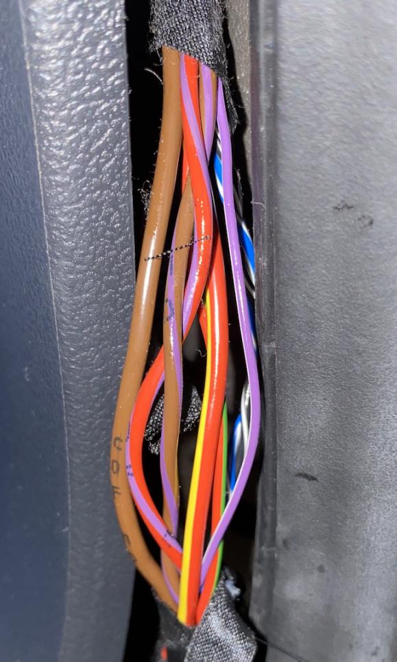

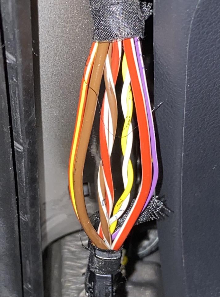

    I am trying to figure out what are the color codes of rear speaker wires in Tiguan 132TSI MY15. I found some information online mainly about VW Golf but nothing about Tiguan. Would anyone know what are the rear speaker wires at the below pictures?
    Rear Left Door:
    Rear Right Door:

    In case someone might find this useful:
    Left Rear Speaker: + Red/White, - Brown/White
    Right Rear Speaker: + Red/Violet, - Brown/Violet
