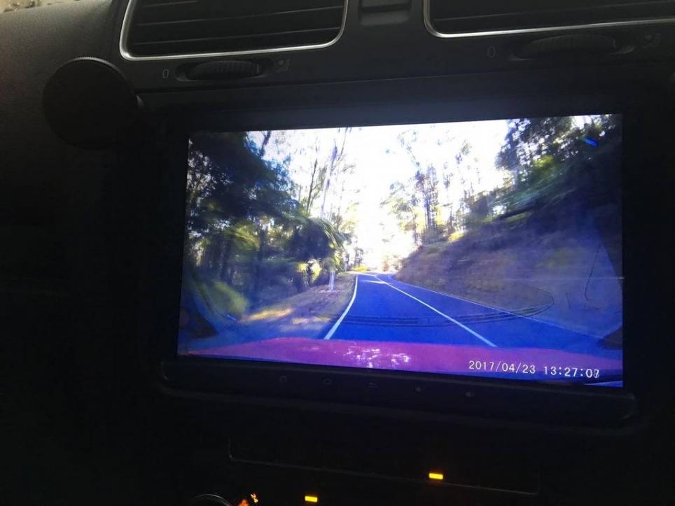

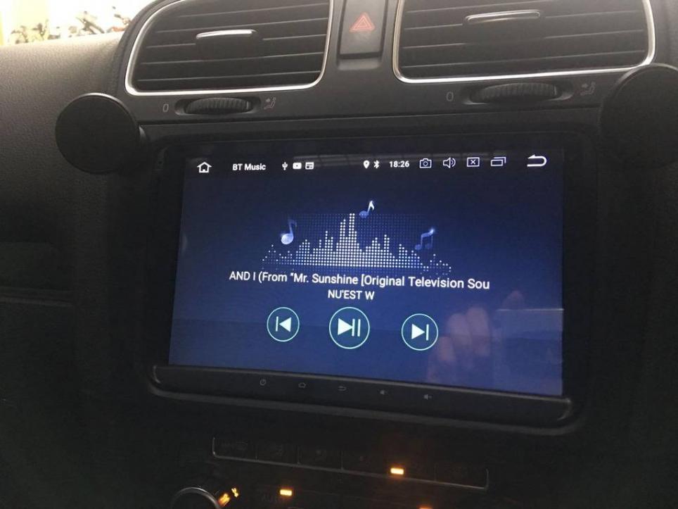

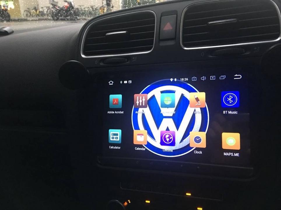

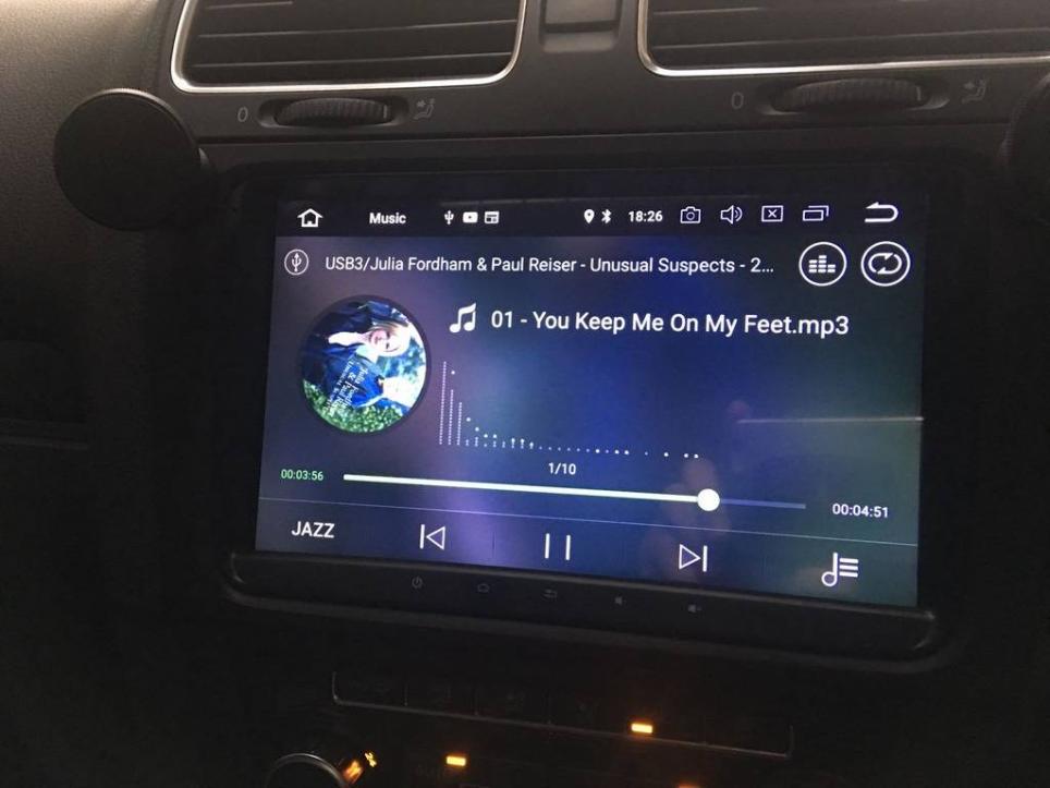

          unless you are committed to having the RNS in your car, you might be better off getting a newer headunit of which there are many on offer. My friend recently installed this headunit which he got for about $300 android OS. He reckons it sounds better than his old RNS and GPS can be updated often. unfortunately it came without a name
