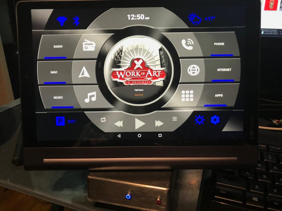

    Here's a pic and 10min Youtube demo. Hope it give you guys that have been thinking about upgrades an option to consider!
    Here's a bench-test pic with my custom raspberry Pi server sitting underneath.

        Video explaining and a demo!
        IceGrey MY10 R36 Sedan - Sunroof - Tint - Ipod - RNS510 NAV - 9W7 BT - Voice Control - Adap Cruise - Lane Assist - Front Assist - Adap Chassis - Omanyts 19" replicas 255/35R19 ContiSport 5P
          This works way better than I had expected, and it doesnt look too out of place in the age of displays popping out of dashes.
          It remembers last playing track and you can set a couple of the apps to auto start playing again a well. The only manual intervention at the moment is to start casting to the chromecast, but it's 2 easy button presses for casting and a quick flick on the Phone to tethering screen.

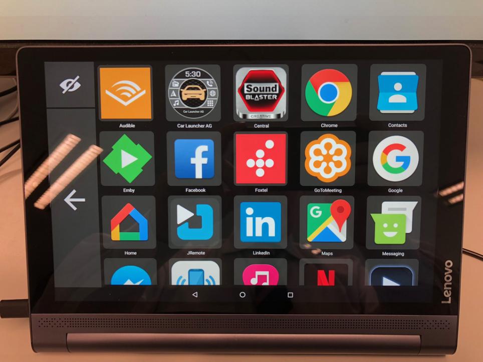

          The App Launcher that I forgot to show in the video. You press the Apps button bottom right. You can also set it to hide Apps you dont want to see in the car and it has an unhide button. (the eye in top left on the Apps screen)
          Car Launcher in the office by Hilton, on Flickr
