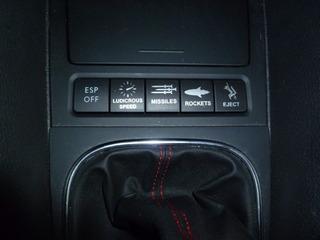

                Hmmm........ sometime soon, I will have to write a DIY thread on this forum about how to add rocket launchers and other more interesting stuff to a Golf - see picture below!
                Don
                PS: Flipper Dog: In my experience, the trick before I press either the "missiles", or "rocket" buttons is to make sure that I first press the "Ludicrous speed" button! The other important aspect of handling the new buttons in the picture is to ALWAYS make sure that the sun-roof is open before I press the seat ejector button (it gets pretty messy inside the cabin when I forget to do this)!

                    Originally posted by DV52 View Post
                    C'mon Don - keep it factual please. That "ESP Off" button is clearly fake.
                      Adam: Yes - you are entirely correct - this is not the place for such levity! And yes, you have been very insightful in identifying the "ESP" button as being a fake.
                      The mis-labelling of this button was a necessary subterfuge so as not to scare my passengers. The real label for this button (which I deliberately didn't use) was "Thermo-Nuclear" (our secret - don't tell anyone!)
                      Don
                        There you go. I was wrong. I thought it was the "evacuation" button. The reverse of the ejector seat. The evacuation button opens the seat base and your passenger is cleanly deposited correctly in the road where your rear tyres imprint themselves over the said passenger. This option is designed to be used where discretion is preferred rather than the more ostentatious method of ejecting through the sun roof.
