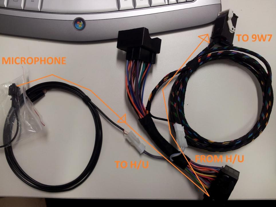

Firstly i have a MY12.5 polo GTI. I have installed my own RNS510. It is a h version built 6/2012 and has the latest firmware (4020). it all works fine but when i tried to use VCDS to enable the secret menu i had no luck. I went to
37 navigation-adaption and changed channel 50 to 1 (was 0) igot this info from a link i found here. is this correct? as i cant get to the menu. it only allows me to see AM,FM and system info.
Also is there any way to bring the directions from the sat nav up on the MDF like the golfs?
And lastly how do i get the voice activation to work. if i use the steering wheel button i cant command the sat nav. but if i press the start button i cant give it commands as it seems it not connecting through the mic.
