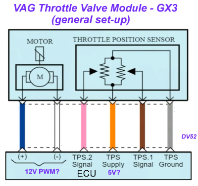

        My hunch (emphasis on "hunch") is that the motor in GX3 is driven by the more usual motor control protocol - Pulse Width Modulation (PWM).. It's not clear to me why motor-control on a throttle valve module needs the precision, or the complexity of stepper motor technology - particularly when stuff like engine rev control would appear to be better suited to a continuously variable signal that is typical of PWM. Plus, as shown in my wiring diagram below, the motor on GX3 has only two wires - stepper motors have multiple stator coils, so they need typically 4 x wires for motor control.
        As I said, this is my hunch, I'm not sure - so I'm more than happy to be advised otherwise! Do you have access to an oscilloscope? If so, maybe look at the waveform on a working GX3 to confirm the motor control protocol. You will find many examples of typical PWM waveforms on the electric internet. Please report your observations - for my benefit
        As for your substantive questions - this is my very cut-down wiring diagram for the general VAG set-up for GX3:
        I apologize if you already know this stuff (you probably do) - but GX3 is a classic example of what's known in control theory as a closed loop system. This system is also called a feedback controller because it has a feedback loop that controls the motor position to the set-point that's calculated by the ECU algorithm.
        From a circuit perspective, the pins that I call "TPS" in my diagram above constitute the feedback loop. As you can see from my diagram, the feedback circuit has its-own power supply which I have labeled 5V because this is the set-up on modern VAG vehicles. Again, I'm not sure how this power supply works on a 1.8T 20V engine - maybe it's 12V?
        So, with regard to your project - clearly the feedback circuit for the primary GX3 will be managed by ECU. I assume that the feedback circuit for the second GX3 will not be connected - is this correct?. If so, the second GX3 will use the feedback circumstances in the primary GX3 notwithstanding that it's actually located downstream in the engine's air-circuit! Is this a viable set-up for proper engine performance - I don't know?
        If it IS kosher to operate 2 x GX3s in this manner and if my PWM guess is correct - then I suspect that all that's needed is an interfacing device that uses the PWM drive signal from the ECU to the primary GX3 as an "input" to generate a second PWM drive signal for the second GX3 motor. In essence, the "interfacing device" for the second GX3 is functionally the same as an audio amplifier albeit the frequency response is very different.
        Again as a working assumption (meaning that I haven't actually research my hypothesis), I wouldn't think that my suggested "interfacing device" is anything special - it's just a normal, bog-standard, low-power, 12 Volt PWM controller. These are readily available - I'm sure that you will find lots on eBay.

          Thankyou very much Don. Yeah the idea was that the secondary pre turbo throttle would just slave its position to whatever the original one, with feedback only coming from the original. Yeah my stepper thoughts were just an assumption. If the throttle bodies are PWM then what you suggest would be possible yeah? First step probably would be to just reposition the original pre turbo and check that everything still runs aok. It could play havoc with the MAF signal, or it could cause MAP sensor errors as it'd be going into vacuum when the lowest it normally sees is atmospheric when the diverter valve opens. Once thats verified then I can look into running the pair. I have seen a pre turbo throttle on a bike engined hillclimb open wheeler. Can't hurt to try other than potentially overspeeding the turbo!!
