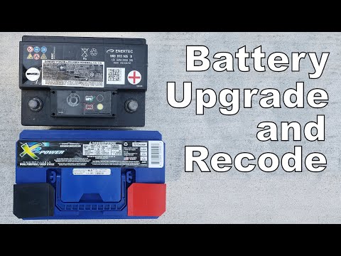

      There are videos on Youtube (done by Ross Tech) on what you need to do.
      Battery Replacement - Ross-Tech Wiki
      Fast forward to about the 5 min mark
