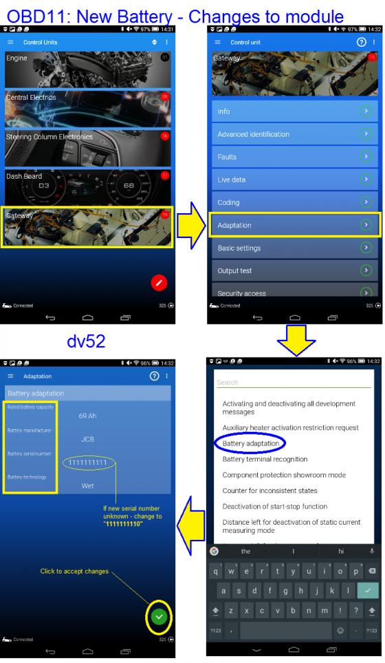

I had to replace the EFB battery in my Golf 7 GTI and upgraded it to an AGM battery. I need to code the new battery details and wouldn't mind changing a few other options. Only likely to use it on a single vehicle and mods would be minor. Would the Carista and OBDeleven allow me to code the new battery?
Recode Golf 7 new AGM battery - Carista or OBD11
Originally posted by StevieGTI7 View PostI had to replace the EFB battery in my Golf 7 GTI and upgraded it to an AGM battery. I need to code the new battery details and wouldn't mind changing a few other options. Only likely to use it on a single vehicle and mods would be minor. Would the Carista and OBDeleven allow me to code the new battery?
If so, here's how it's done

As an aside, if I wanted to put a standard lead acid into my Tiguan as a replacement for the existing AGM, does that mean its possible providing I reset the battery details? I'm aware there's probably capacity issues, but the AGM doesn't seem to last as long2012 TDi DSG Tiguan
