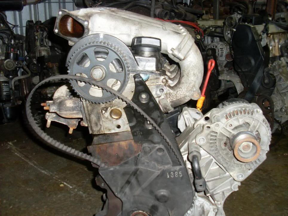

            I have heaps of the 8v type brackets.
            I`ll take a pic of one on a 16v engine on Monday.
            I`d probably want $50 for the Mount and $100 for the 90amp ribbed alternators. call it $180 and i`ll give you the bottom puley for the crank too. Then you just need a waterpump pulley and a belt.

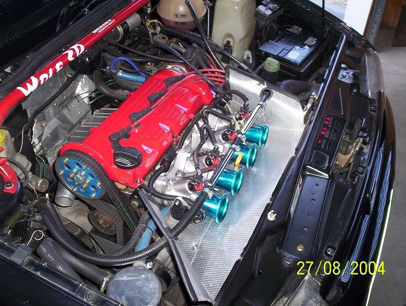

                  I had to get my manifold modded on the ITBd ABF to clear the alternator and later replaced it with a fcatory non-A/C setup, so no, most manifolds don't have enough upward rake to clear the normal Mk3 alt setup.
                  On the turbo engine, I have the stock setup, deleted a/c and PAS, 6PK1040 belt and VR6 w/p pulley
                  This isn't ideal in a Mk1, though, as the tensioner arm bolt rubs the chassis rail in most cases, depending on where you locate the engine (as in with the 15mm movement either way from the side engine mounts). I belted in the rail and smoothed it over on mine. Some people get around it by using v-belts, but that's just lame
                  On a carbed or ITBd engine, you really do need the proper non-A/C setup as it leaves far more space for an airbox or big filters. You also avoid some of the heatsoak from the alternator. This is a VWM Mk3 engine (look at all the space)
                  This is my engine, where the alternator is smack underneath that heatshield...

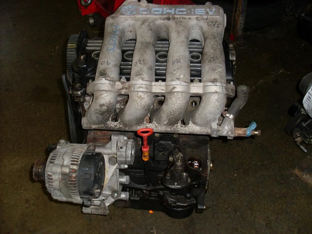

                      The 8v Kind I have that will fit your 16v, I`ll take a pic of tomorrow.
                      • #41
                        Originally posted by Golf Loon View Post
                        I dont have that kind Preen.
                        Beautiful. I'll await pics.

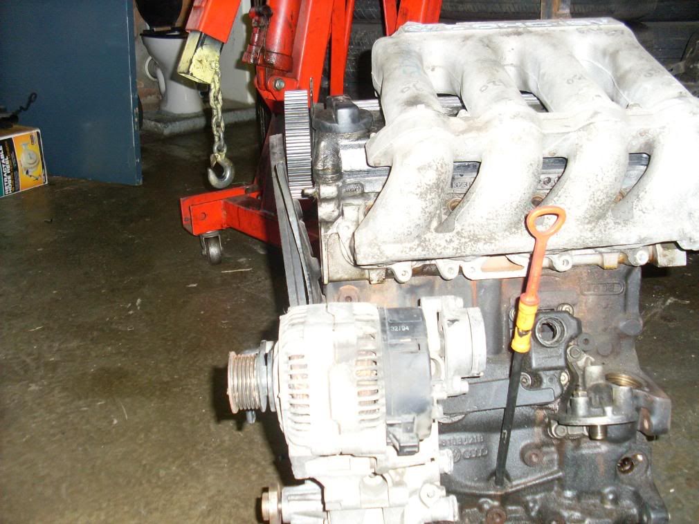

                        • #42
                          Here you go, KR Motor and 50mm intake and Mk3 alternator mount with AC provision.
                          • #43
                            That'll do me! Aslong as my carbs will clear it.
                            • #44
                              If they go upwards or straight out from the motor, they will fit. If they go down, they may not fit.
                              • #45
                                The mani has an upward rake.
