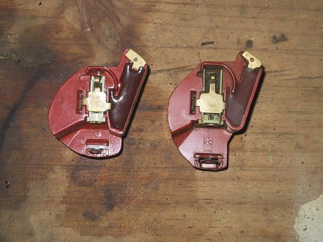

                            Just alittle info,
                            Some K-Basic sytem's still have a rev limiter incl. my 83 GTI. It's built into the rotor button in the distributor.
                            Early BMW's have this system as well. It's a pretty nifty setup. Basically uses centrifugal force applied to a predetermined spring load which create's a dead short through the dizzy shaft.
                              Originally posted by golfworx View Post
                              Just alittle info,
                              I've seen those in type 4 Kombis too. (Usually disabled).
