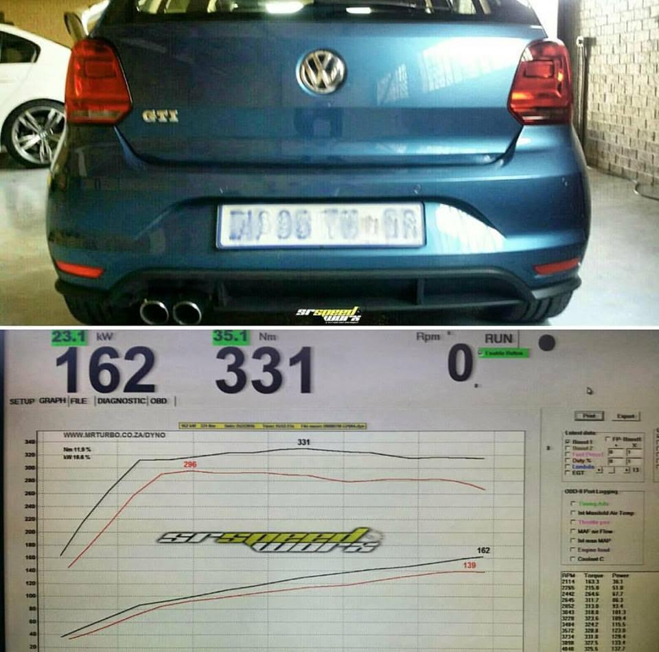

          George the Burger tuning rep in South Africa sent me a dyno result of a UK Polo with downpipe and JB1 - 191 kW flywheel.

            Yeah that's awesome performance for the price and with the added benefit of being removable/untraceable. BMS have some dyno graphs on their website for the 6C running on the included Map.
            JB1 VW Performance Tuner - BurgerTuning.com
