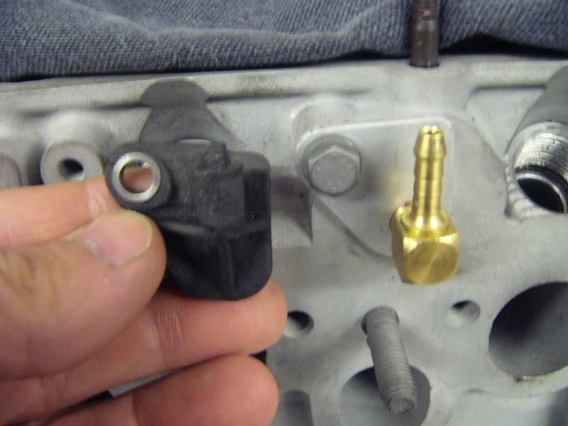

    Made up a new outlet plate. I'll hook it up and let you know how it all works out.

    Pete, I've run into the exact-same problem with my '88 DX head. I bought a polished and ported DX head from the UK and when it arrived, it was missing the plastic vacuum connector. The 'old' head has a metal pipe pressed into it instead (so I can't just transfer the connector across).
    Can you provide any guidance about how you got on with the solution pictured? Where did you get the fitting from and was it easy to press in...? It looks very effective.

      That all worked fine.
      I made the aluminium plat myself and the brass fitting was from Enzed.
      The fitting screws into the plate, by the looks of it, it's 1/4" BSPT
      I've got the taps to cut the thread of Enzed could tap a plate for you too.
