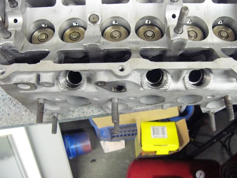

    We had some fun and games vacuum testing this head when I had it reco'd.
    It took a little while to figure out that there is a gallery that runs across the back of the head that connects the injectors together. I think this is what is refered to as the "AIR SHROUDING" system.
    I'm replacing the injectors, seals, insulators and their o rings.
    The head had the fitting that connect to this gallery blocked off.
    My question is How does this sysytem acually work and what is the gallery connected to? Vacuum?
    In this photo you can just make out the gallery between the injector holders.

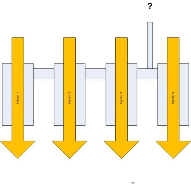

                  Here's a quick drawing of how it works.
                  Each injector is surrounded by a sealed chamber of air.
                  Each chamber is connected to all the others by a gallery drilled right across the back of the head.
                  There is a single connection to this galery at the back of the head which connects to ....?????
