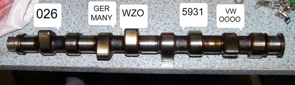

What cam is this? Suggestions for replacement?
  • What cam is this? Suggestions for replacement?
    The heads off white due to blowing a head gasket at Phillip Island. I thought I'd investigate cams while it's all apart. Can anyone identify this cam for me?
    Here's what I know
    It's hydraulic. Two of the lifters seem stuck which I'd already guessed from the tappity noises when the car was cold, I'll replace the lot.
    Engine is MK 2 1800 K-Jet engine no GX 095 597
    I'd like to know if this is the standard cam and hear your suggestions on replacements based on continuing to run the K-Jet with extractors and 2.5" exhaust. Porting and valves might be done too.

    I dont think its a G Grind, they should have a G on it.
    Probably standard cabrio cam.
    Put either a G Grind, I have if you need, or pm demoIII as he has a tasty can for sale.

        Depends if you want driveability as much?
        I know some Autotech cams can be had for about 120USD, these specs vary (of course) but something like a 270 sport, will be a nice strong cam, lumpier than a G grind, and work from about 3kRPM up to 7k+RPM. The bigger cams *may* require HD valve springs though. Should net about 10 Horse on a standard engine, so with some P&P + extractors and exhaust maybe higer comp ratio, you could be looking at comfortably 20 Horse I reckon.
        Anyways. That's just my opinion. Tim (Golfworx) knows his cam's. PM him if he doesn't chime in here, I'd take his word over mine any day!

            yeh thanks matt
            i got a 270 deg cam, quiet lumpy and it really does give so much more from above 3K rpm all the way through to 7k rpm! i was surprised that it got there cus with my stock one, for what ever reason i couldnt even reach 6K rpm
              With head work & oversize valve's etc., it comes down to how much you want to spend.
              Here's a mob in the states that port's a very nice 8V with some good flow number's. $800 US
              Down side it's for a JH US spec 8V & that it really need's 10+:1 CR & a decent size cam to make full effect.
              This place also does alot of nice mk1 part's to like a Spherical Shifter, Spehrical bearing ball joint Kit, Bump steer Elimination kit, Tubular Control Arms MKI & MKII etc.
              Check out their part's section.
              Also another place in the U.K. have have some very nice CNC head's with some even nicer result's.
              As far as I know the GX never came with a "G" grind cam as it was the low HP gti engine & as such came with a very low performance cam. It's also a hydraulic cam.
              The RV (high output) engine had the hydraulic version G grind which wasn't as big as the solid version
              The true G grind came in the DX solid cam GTI's like my 83 GTI & had a very nice lump to it & would start pulling strong after 3500rpm. Much more lumpier than a Autotech 270.
              283° advertised
              225° at 0.050"
              0.423" lift
              Just letting you know that your not alone with this engine code, my old beater engine, which I fitted to the GTI is a GX too!
              GX engine cam - I don't have the advertised duration only these
              duration @ 0.050" 210°/209°
              Lift - .393"
              Lobe center's - 110°
              I fitted a Autotech 270 to my beater engine & made a nice difference. Also fitted Autotech's heavy duty valves spring's, Vernier Cam pulley & new OEM lifter's, which goes without saying.
              Duration: 270° at 0.1mm check,
              Lift: 0.449"
              112° lobe center
              Has alittle lump to the idle & has good manifold vacuum.
              A word of warning though with big cam's & K-Jet. If it's too lumpy, the airflow reversion can upset the airflap causing very poor performance. I remember someone fitted a airflap off another vehicle (can't remember which one) which was thicker & heavier which eliminated the problem.
              If I stick with the 8v hydraulic, I'd like to try a TT 276° with a Auto tran's & 3000rpm stall.
              276° Advertised
              234° @ 0.050"
              .449" Lift
              110° Lobe Center
              Another note is that if you pick a cam with over .449" lift, you may have to clearance the lifter bore's. but if the head's apart, then this can be done quite easily.

                Thanks for the info, it's options I'm after, your feedback is great.
                I think the approach I will take is that I will build another motor next year with all the trimmings, so for this build I'll just go one step further than it's at currently.
                If the Hydraulic G Grind or Autotech cam is known to work OK with the K-Jet, I might head down that path for now.
                For the headwork I've had an initial chat with my head guy and we'll see what he can come up with. I'll pass on your suggestions.
                At this stage I don't want to go down the radical modification path too far, what I'll try and establish is a setup that has been seen working in the past.
                I'll save the major engineering work for the project motor later on.
                That said, I'll up the valves if I can and port to match.
                I'll get the head and manifold tanked and media blasted, those K-Jet manifolds look like a bugger to clean out otherwise.
                Keep the suggestions coming! If I get the head setup right I can always play with different cams later on.

                  No problem's Pete. Glad to help out.
                  The major difference's were compression & cam's as advertised.
                  GX 8.5:1 85HP,
                  RV 10.0:1 112HP
                  When I measured my GX corrected, it was as follow's
                  Deck height - 1.00mm
                  Head gasket height - 1.65mm
                  Piston Crown Volume - 17.69cc
                  Deck Height + Gasket Volume - 13.6609cc
                  Cyl. Head Volume - 30.00cc
                  Compression Ratio
                  Deck Height + Gasket Volume - +13.6609cc
                  Cyl. Head Volume - +30.00cc
                  Total Combustion Chamber Volume = 61.3509
                  Swept Volume - 445.398
                  = 506.7489
                  Total Combustion Chamber Volume - +61.3509
                  = 8.2598:1 Compression Ratio.
                  My setup's been tried & tested, although it hasn't been on a dyno for quite sometime, but from ET & MPH with only the spare removed, I've been told it's on par with a US Spec G60.
                  Roughly 100WHP.
                  Mine's a GX with the compresion raised to 9.4246:1 Corrected & balanced with the clutch/flywheel assembly.
                  - Autotech 270 Cam
                  - Autotech Heavy Duty Valve Springs
                  - Autotech Vernier Pulley - retarded 1-2°
                  - Autotech Intermediate Pulley
                  - Stage 1 Ported intake manifold from this bloke http://www.scientificrabbit.com/
                  - Match Ported Audi Throttle body
                  - Volvo 240 2.2L Fuel Distributor & Airflow sensor flap assembly, swiss cheesed airbox, K&N air filter & rocker cover breather blocked off. Now routed into a filtered Powerade Bottle! Yeh Yeh, I know, but it works!
                  - Late Model stock GTI distributor without vac. advance. Big Difference. (Can't remember ignition timing spec, approx stock 3° ATDC)
                  - HD 210mm clutch kit
                  - Very old Hurricane 4-2-1 Extractors
                  - 2" exhaust system, hotdog (can't remember the length) & straight through offset rear muffler with 2.5" tailpipe
                  - 4 spd Stock Diesel gearbox with a ABD short shift kit & weighted shifter rod.

                      When it comes to building engine's, I like to keep detailed record's of what get's done & what goes into them.
                      The engine was rebuilt in 98, so it was a far while ago now. Has clocked up over 370+k with only a headgasket failure.
                      I wouldn't suggest skimming the head super thin to raise the CR, as this can cause mixture & ignition problem's.
                      I ended up fitting new piston's which had a smaller volume & higher deck height.
                      I should have posted this up before to save confusion
                      Here's all the dismantled & assemble spec's
                      GX Engine
                      Bore - 81mm
                      Stroke - 86.4mm
                      Swept Volume Per Cylinder – 445.398cc
                      Engine Capacity - 1781.582cc
                      As Dismantled/As Assembled
                      DeckDeck height -
                      1.00mm/0.60mm
                      1.65mm/1.65mm
                      17.69cc/11.27cc
                      13.6609cc/11.5989cc
                      Cyl. Head Volume -
                      30.00cc/ 30.00cc
                      Compression Ratio
                      17.69cc/11.27cc
                      +13.6609cc/+11.5989cc
                      Cyl. Head Volume -
                      +30.00cc/+30.00cc
                      =61.3509/=52.8689
                      Swept Volume -
                      445.398/445.398
                      =506.7489/=498.2669
                      +61.3509/+52.8689
                      Compression Ratio
                      = 8.2598:1/9.4246:1
                      Cam Specs – Stock GX
                      In Opens 15°BTDC
                      In Closes 55°ABDC
                      Ex Opens 55°BBDC
                      Ex Closes 15°ATDC
                      Duration In + Ex 250°
                      Lift @ Lobe .360”
                      As you can see, a Autotech 270 is a much bigger cam.
                      If you just going to fit a Hydraulic G Grind, I wouldn't bother about HD valve spring's, just lifter's. But on the other hand, if the engine has had a hard time for most of it's life, new spring's wouldn't be such a bad idea.
                      Just out of interest sake, the Autotech 270 is $129.95US. They should post to OZ.
                        Ok, that makes sense, thanks for taking the time to write it all up.
