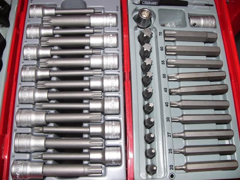

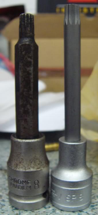

                Here you go they're not mythical.
                On the left we have a very worn out Kinchrome and on the right a new Teng Tools one.
                Everyone sells Kinchrome, even Bunnings!
                Teng Tools are distributed by Ryans so Repco, Bursons etc shouldn't have any troubles getting them.
                My local auto shop Summit Auto in Boronia stocks a big range and will take individual items from a full kit if you only want a specific tool.
                Here's a couple of Kits
                Spline, Ribe and Torx bits.
                Pete
