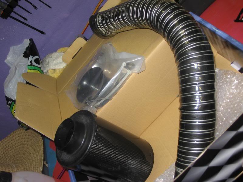

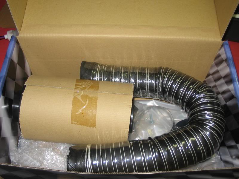

    It's a DRiFT branded carbon fibre CAI, basically a BMC CDA rip off
    Stickered at $269 at AutoBarn, $169 later and it's in my garage waiting...
    The box:
    The insides:
    Looks like it includes just about everything you need to mount it up nice too, but we will see soon enough:

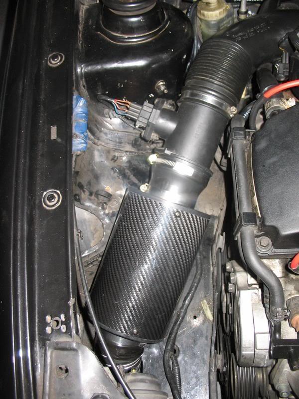

          OK I got impatient and went and bought some extra hose to move the carbon canister:
          Under the MAF I have redirected all the piping back towards the firewall (I also took the chance to replace a the dodgy bit of red piping that was in here before:

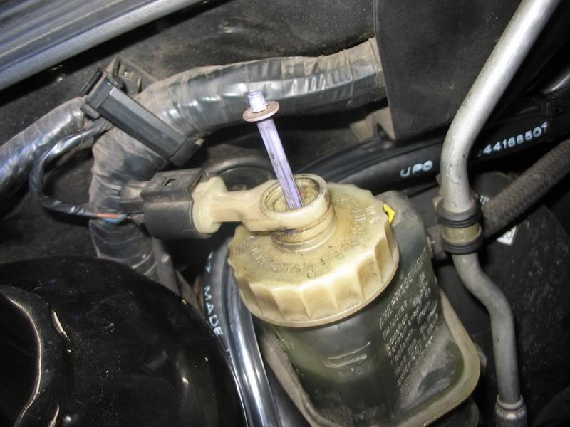

          From here is runs behind this fluid bottle:

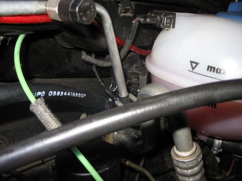

          Along the firewall:
          Then behind the expansion tank:

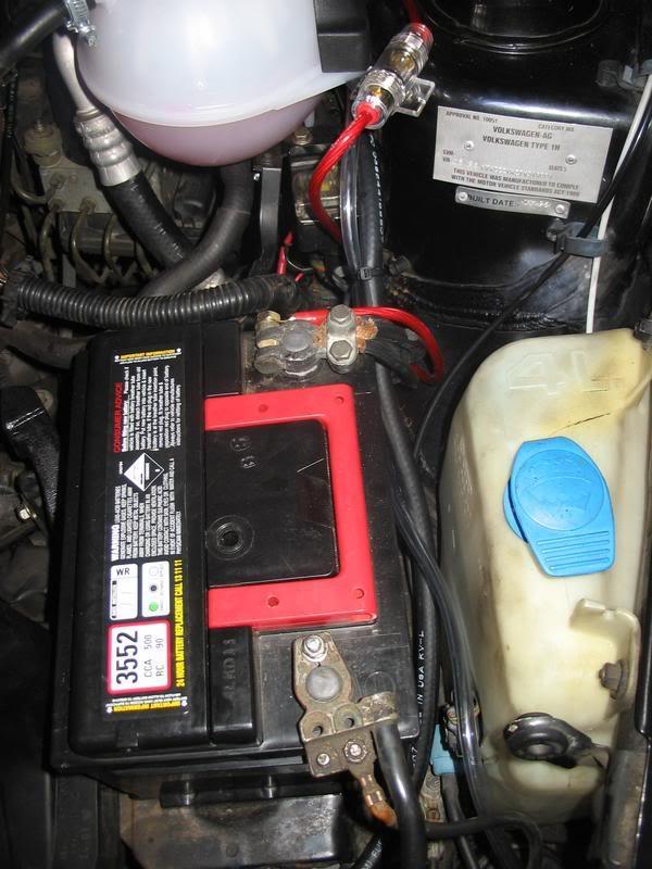

          Round the battery:

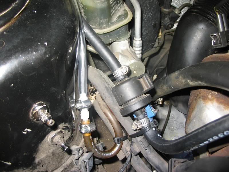

          And down to the relocated carbon canister:
          It doesn't *quite* have the same mountings on the otherside, but it's close enough that it works nicely.
          All new hoses have been cable tied back and away from any potentially hot bits.
          And the new filter installed:

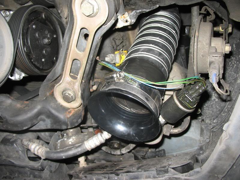

          From underneath it touches the AC pressure switch, not really happy with that and I want to move it into the front lower air dam, but I don't know if there is enough space. I might have to get a more flexible hose so I can squeeze it through the gap:
          The downside. It is DAMN close to the ground (about 1 - 2 inches up under the front lip). It seems that it does suck up a small amount of water so it's something I will have to keep an eye on. Being that I want to move it to the front air dam anyway I would reduce that issue...
          Although the question still stands, even if the intake is in that front air dam, can it pick up much water, or enough to cause issues, in normal driving and assuming I'm not stupid enough to try and drive through a river??

                        I can't say that I can say "WOW What a difference it make!". In fact going from a pod to this about the only thing I notice is the induction noise is a little more throaty. Power still seems to be as good as it was. One of the major benefits for me was that the car is now that much more legal with an enclosed air box. Sure, by the time your pulled over and have the bonnet open your well and truly in the **** anyway, but at least it should make NSW pink slips an easier process (not that the guy I go to cares too much).
                        Install was very easy, most of the time it took me was driving back and forth between home and AutoBarn when I realised I needed another part
                        What you need is about 3 meter of each hose type, 9 hose clamps (if you replace them all),two hose joiners and of course the air filter and any adaptors you may need to connect it up to your current air intake. IIRC I used a 2.5" -> 3" adaptor.
                        The next step for me would be to take the MAF housing out and cut the screen out of it. Something I'm toying with, on one hand I think it's a level of protection for the MAF, on the other I think if anything worth talking about is getting through the air filter I'm pretty much screwed anyway. As for how much difference it makes?? Still trawling the net looking at opinions.
                        On the upside, driving round Sydney in the pouring down rain over the last couple of weeks hasn't been an issue with an air filter sitting so close to the ground. I am very mindful of that point and try to take it a little easier in the wet (as opposed to my normal foot to the floor driving style) in the hope that less water is being sucked up. I'm also on the look out for large bodies of water across the road and try not to drive through them. For the moment I think that short of driving through a creek I will be right.
                        In reality I may be being overly paranoid about the air filter, if anything I should consider one of those valvy things that stops you flooding your engine with water if you do manage to submerge in the intake. Or I could always loose the extension pipe when it's really raining, which is about a 60 second job. Another point to note is that it isn't supposed to rain all that much in Australia anyway, so I should have few(er) days to be paranoid about when we get out of our current [overly] wet season.
