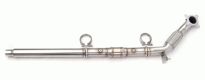

                  Most aftermarket downpipes will mate to the stock cat back as you can see here by our SPM GTI DP. It comes with a reducer section
                  As for sound. That depends on the car you drive. A GTI wont be much louder with a DP but a Golf R generally will be.

                    Since I can't see a flange on that end. Does that mean it needs to be weld? I have gti mk6
                      Most of them just clamp up. No welding required.

                          the mk6 GTI has a clamp like this connecting the factory DP to the rear exhaust section. It is re-used to mate the two.
