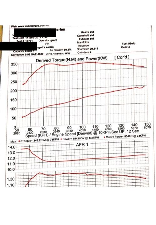

    hi, in case u were thinking of tuning your golf r.. here are my results almost 195kw at all wheels. i hope this helps!
    current tune on my car are as follows:

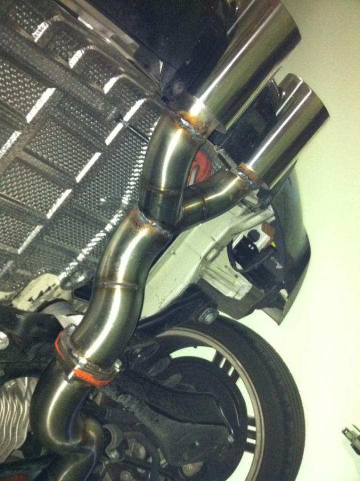

    full 3 inch (ramp autogroup), intake (forge), high pressure fuel pump (APR), diverter valve(forge), and bluefin stage 3 tune.
    Impressive jubei ... i was also intending to have a Bluefin , CAI by Forge and TBE with Adrian, but had to back off due to budget. May I ask if you are running one or two mufflers? How's the noise levels? alloys rock !!! I'd still like to push through with the Wintake as a start. cheers and hope to see your ride sometime in our roads .....

        i'm running 1 muffler. the noise is perfect. not too droney, i was afraid it was going to annoy the heck outta me but it worked out well.

              Also what was your max torque?
              YAY I got my R!!!! White, recaro seats, 19" wheels, bluetooth, reverse camera
                Sorry just asking if I am reading it correct at 350nm??

                  Nice result. Any idea on the boost level?
                  Yeah, the torque is at the bottom 346.2nm.
                    Spiking to 24 and holding 21-22psi. Your torque seams a lil low, I might be wrong though I thought most stock Rs have around 340ish nm. Mine is getting 470 nm while some of the others the place I had mine done at are close to 500 nm but they have fuel pump and intercooler.

                      From the dyno readouts ive seen from BPS, their dyno reads low on power but is very generous on the torque. Ive seen about half a dozen dyno sheets from BPS tuned Golf R's and they all have the same traits.
                      At the dyno day in Sydney earlier this year, there were a good 20 or so Golf R's and also several Audi S3's in all different levels of tune, including bone stock cars.
                      The stock ones made around 160-165kw and about 300nm
                      Stage 1 cars were mostly around 180-185kw and 320-330nm
                      Stage 2+ and custom tuned cars were around 200-220kw and 400-420nm.
                      My car made 204kw and 354nm with stage 1 tune but i had stage 2 parts (dump pipe and intake).
                      Hard to really compare results accurately with your cars, as the readings vary from one dyno to another.

                        Very true but didn't think it would be so much different. I understand all cars and dynos are different and you always get I bit of variation. Just didn't think it would be over 100 nm. I have heard bps dyno is a lil low on the kw side but didn't know it was a lil high on the nm.
