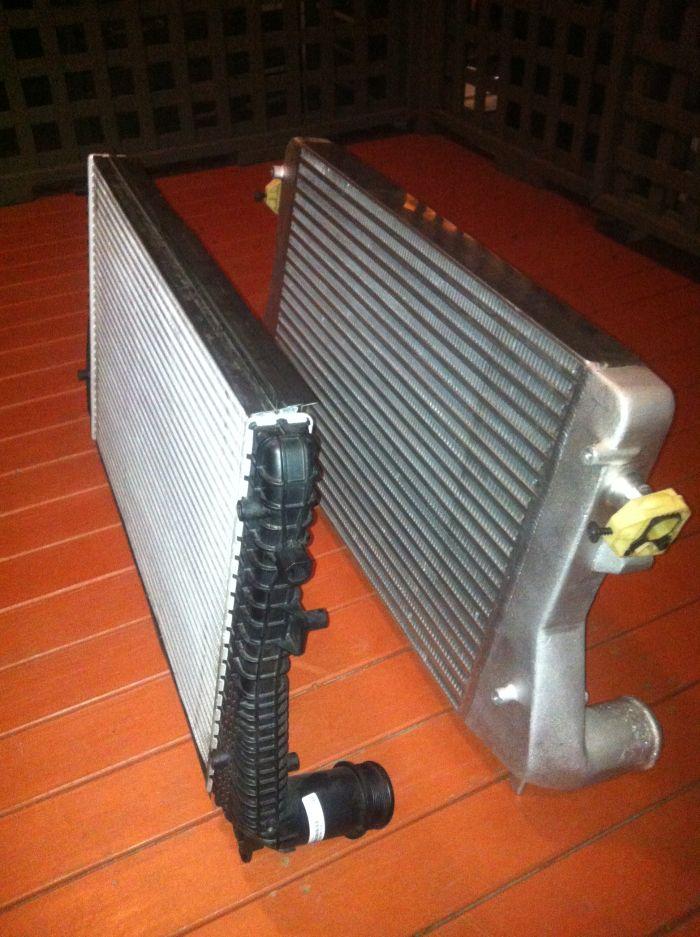

    Im not 100% positive, but id almost bet my right arm that the intercooler in the Passat 2.0 TFSI is exactly the same as the Golf R / Golf GTI etc which looks like the one in my pic below.
    IF this is the case (and a good poke around from you would be able to confirm the approx size/shape of the intercooler) then any of the upgrades for the GTi/R would also fit your Passat.

    or the one i personally fitted recently, the THS replica intercooler for just over $400. More pics and details here if you are interested: THS Copy Intercooler review and installation pictorial semi-DIY
    Stock intercooler on the left - new intercooler on the right:

            ^ those 600 x 300 x 73 cores wont fit in the stock intercooler location, and will be far too big to fit in front of the radiator (going off my car) because of the crash beam and mounts etc for the bumper bar. Scrap the 600 x 300 x 76 core idea.
            Honestly, get under your car with a torch and have a good look - it will take you 10 minutes to see if the shape of your stock intercooler and pipes is the same as the pics on my link above. If so, then any of the intercoolers from my previous post will work.
