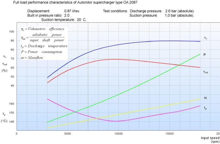

The toyota SC14's go for around $400 (roughly?) but dont forget other costs too.
