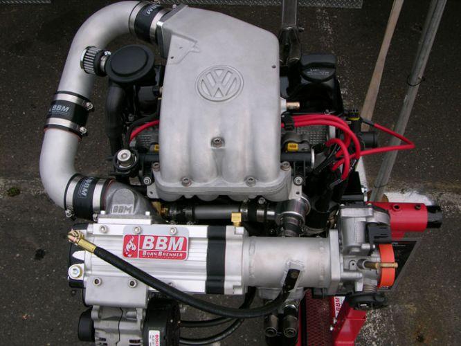

                      Guaranteed to outperform all available 8V turbo kits.
                      The complete bolt-on Stage I kit bumps up your power by nearly 60% 177+ bhp 180 Torque! Put your 2.0L cross flow on steroids and have some fun! Latest BBM4201 Software Updates Included, compressor unit capable of up to 300bhp
                      sounds good, cross flow engine tho...

                            Would the Bahn Brenner MK2 type not fit the MK3 8V ?
