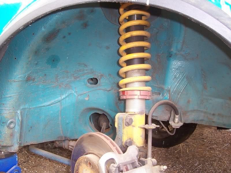

 Next time I am up at my shed I will get some pics of the adjustable spring seats that I fitted to the the stock strut tubes. (Well, really Bilstien tubes but they were the same as the stoks externally. Cheers, Andrew Par 6 Golf GTI. Coilovers, BBS CH Wheels, APR'd Par 6 Golf GTI. Coilovers, BBS CH Wheels, APR'd
 Watch out with too low a springs on std strut lengths. Read earlier in this topic, you will run out of travel very easily. beware!!!! Par 6 Golf GTI. Coilovers, BBS CH Wheels, APR'd Par 6 Golf GTI. Coilovers, BBS CH Wheels, APR'd

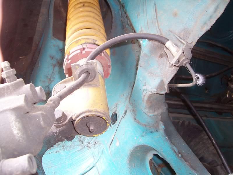

 I will get some pics of gunters front strut setup this weekend because if you are going low you have to cut and gusset the rhf section above the driveshaft as it will foul the bodywork. Par 6 Golf GTI. Coilovers, BBS CH Wheels, APR'd Par 6 Golf GTI. Coilovers, BBS CH Wheels, APR'd
 Heres some pics of "Gunters" front spring setup. The struts originally had the std size seats but we remonved then and fitted some threaded seats, available at "race type shops". Note that just behind the brake pipe I have cut out and gusseted the inner guard section to give the driveshaft clearance. You must do this if you are going low and driving around the roads or tracks.
