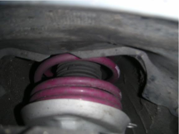

                        Please, don't cut the spring. Either spend some money to get proper springs. It's your life, it's stuffed up rebounds rate, stiffness and strenght. For sure it will damage ur strut and shock.

                        Here's the pic of my spring and strut, the coil at the bottom is closely packed and compressed. and standard one is more separated.
