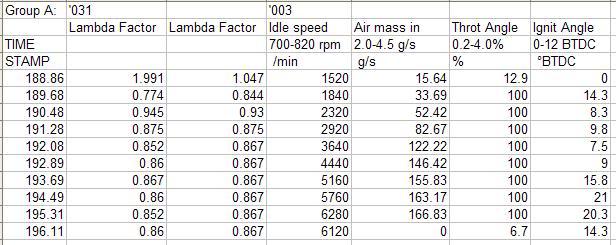

                            Yeah, thats what I saw. Apparently the Vag-com guys are across this.
                            So with the ongoing adaptation, am I likely to experience this with all tunes? If I change to a tune that cant be turned on / off like the APR is, can you reset them in the same way?
                            I don't really understand why my car looses power over time, I sure don't baby it.

                              Totally agree here to align the throttle body you must do it with adaption on all the models, it wont be right to let it just set itself. Ive done a AEE polo today that has old technology like AGU and it wouldt behave till physically alignedwith the software, i wouldnt do it any other way anyway having said that. back to the original issue, you say you are losing power over time, im with Guy here how are you measuring your power? Are you watching a boost gauge or are you feeling its just getting down on power??? you ae on stage 1 right??? have you actually seen it getting down on power or is it just feel, gauges and requested and actual dont lie really , feel will. you might be itching to go to the next level mate. Im a firm believer on gauges, and of course what he ecu is requesting an the actual. Do a log on 115 for requested and actual, do 114 and you will see the duty cycle of N75 and like Guy says 030,031,032 to check your fuel trim.
