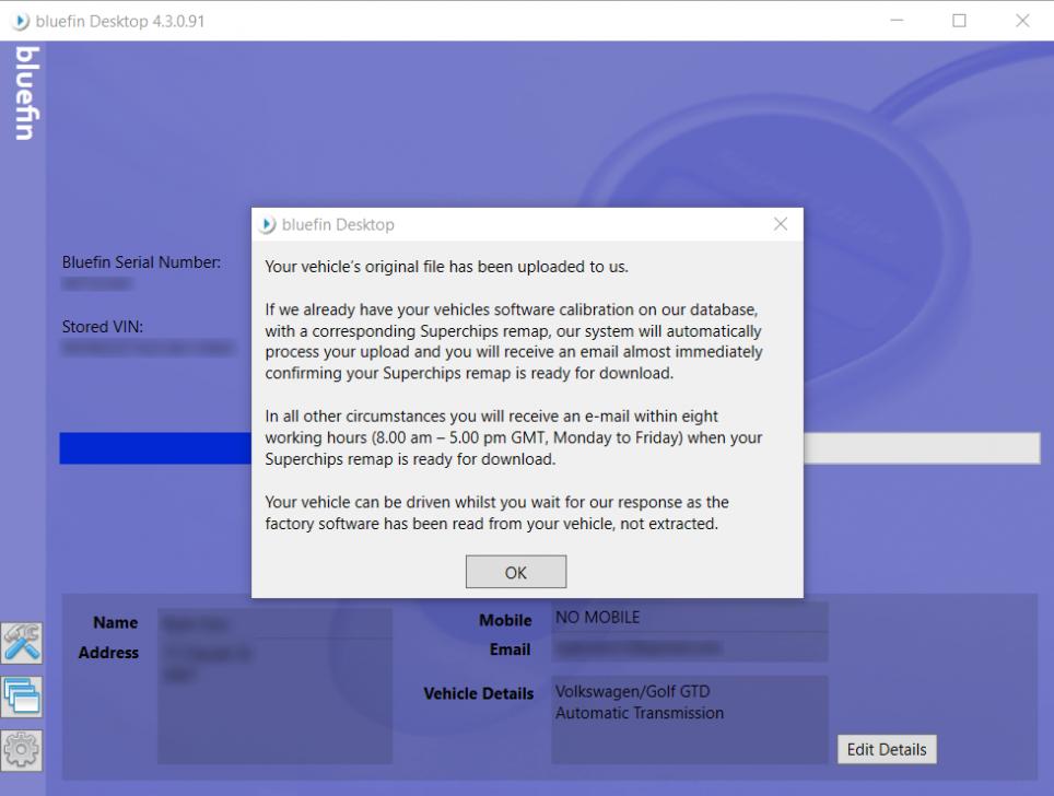

    The package includes the handheld device and mini-USB cable, a computer with internet access is all else that is required. Video instructions are also available on the Superchips website and the process is identical for most vehicles. Of note, the MK6 GTD and TDI also require a different handheld device (VAGH-T) than the GTI (VAG-T) as they employ a newer ECU. Installation is intuitive with instructions on the handheld’s screen in addition to clear prompts on the PC software. It’s is as simple as downloading and installing the software from the Superchips website onto a computer and plugging the handset into the OBD II port on the car where it leads the user through the steps to back up the stock map.
    Once back up and connected over USB to a desktop or laptop with Bluefin software and internet, the device begins uploading the map to Bluefin servers, and a modified map is emailed to the user’s specified address. Though the software states that the new map can take up to 8-hours to receive, mine was emailed almost instantaneously. The new map is then loaded onto the handheld after which the device contains both stock and stage 1 map. It is now able to load these maps onto the car and the user is able to switch between the two as they see fit. The whole process took me 20 minutes and toggling between the maps only takes around 5 minutes with no computer necessary. The handheld can run diagnostics on certain vehicles, however, I was not able to find this function on the Golf.

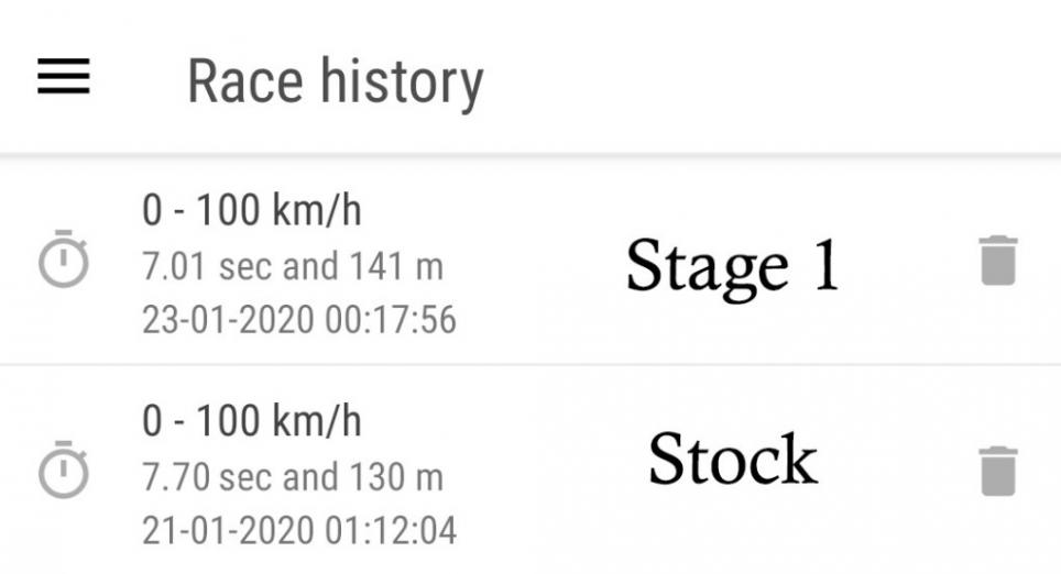

    But let’s talk about spirited driving, that’s why we’re really here! As is, the map promises a 28bhp and 59nm increase over stock to produce a total of 202 bhp and 417 nm. Note, these are the peak differences between the Stage 1 remap and the stock map, not the difference between each at peak output. Still, that’s the power of a stock GTI with an extra 180nm. Switching to manual and letting the engine run to the cusp of redline made every iota of that power bump noticeable. A few weeks ago, I switched to considerably grippier Michelin Pilot Sport 4’s over the stock Continental MC5’s and have experienced almost perfect traction since, I can’t recommend these tires enough. However, with the tun, traction control was working through first and second. The car accelerated with new ferocity through these gears and continued pulling hard through third. The car was perkier and more willing to rev with noticeably more top-end. Where the stock map seemed to fall off above 4000rpm, the new map kept power longer with only a small fall-off approaching redline.
    Jonathan noted that I shouldn’t expect a night and day difference and sure, it’s not transformative, but the upgrade was immediately noticeable. Butt dyno aside, I did take some 0-100 measurements using a GPS phone app (Speed Logic). I can’t guarantee whether the road was perfectly flat so times will vary, however, it does serve as an effective comparison. Stock figures quote 8.1 seconds though, with stickier tires, I was able to beat that and achieve 7.7 seconds. Testing again on the same stretch with the map, this dropped to almost 7.0 seconds flat, a figure that almost matches a stock GTI. In comparison to that vehicle, the GTD feels faster as it pulls harder through a shorter rev range, however, overall the GTI remains the quicker vehicle despite having a statistical disadvantage. Nonetheless, the Stage 1 remap enhances the dynamics of a car that is already huge fun while simultaneously benefitting drivability and with minimal impact on economy.
