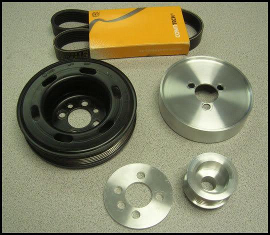

        The issue with the ebay pulleys is that alot of teeth are not really "in sync" or filed down after they are machined.Once completed the rough machined parts are put in boxes and shipped to the customers.
        Reality is you get what you pay for...
        With mine you will see that the pulleys are machined,then smoothed so that the teeth dont bite the belts then anodized....
