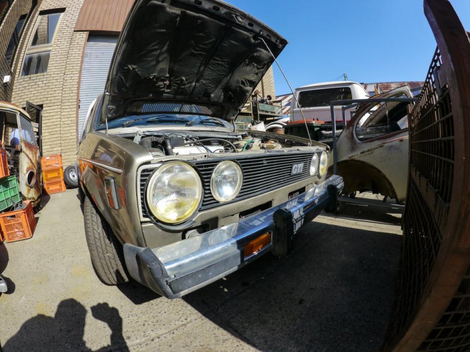

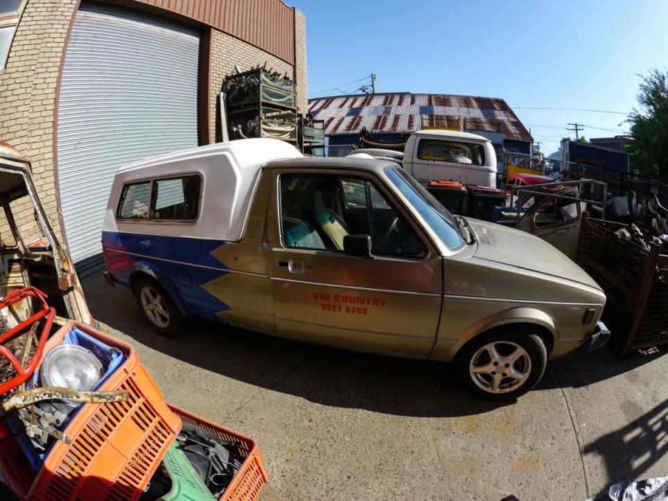

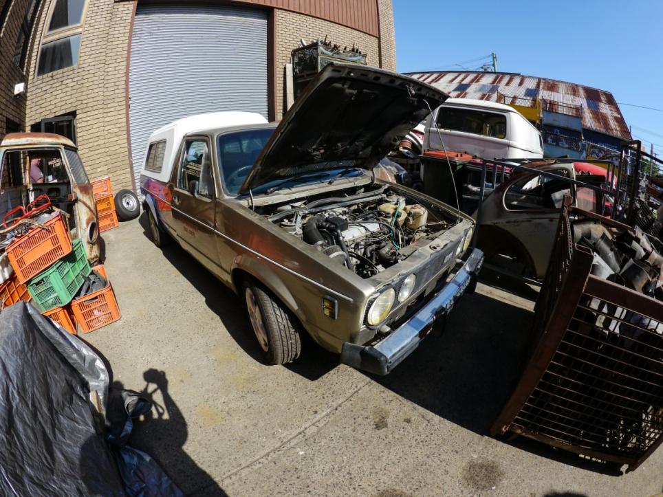

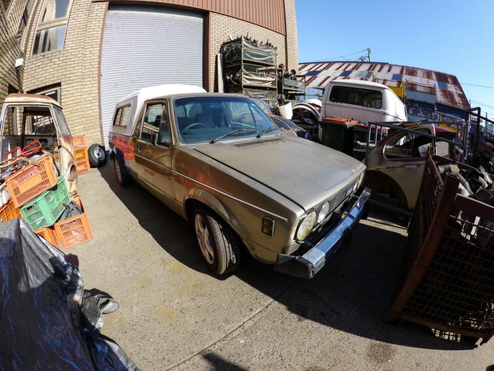

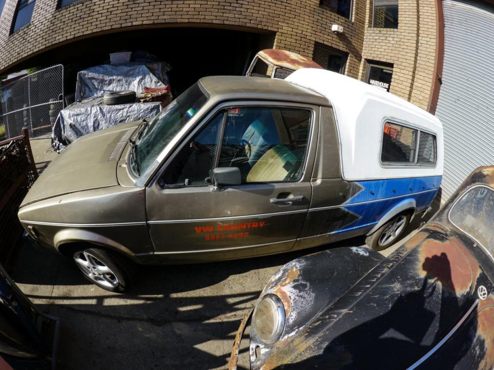

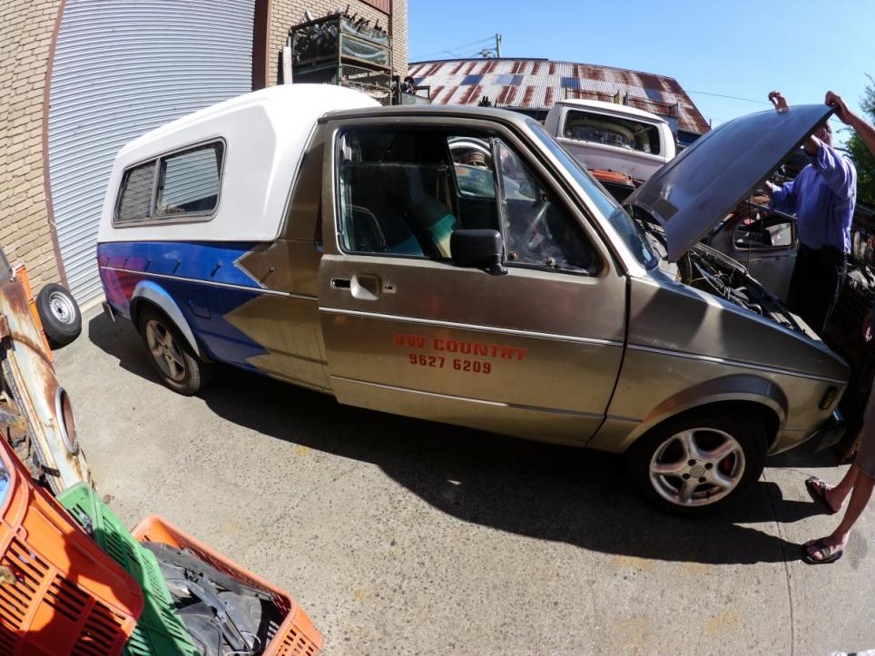

    Didn't bring any trophies home from DOVW this year but I did get this......
    It's quite an odd ball. Will have to get it home before I can figure out it's heritage.
    Appears to be US spec with RHD conversion.
    It's got a 2E motor running on LPG - seriously dodgy conversion.
    Stock fuel tank is missing, I'll probably have to make 1 from scratch.
    Rust in the usual places, nothing I haven't tackled before.
    Canopy will be for sale, I don't think I want to use it.
    Came from a NSW country VW shop that went out of business last year.
    Not sure what the plan is yet. First job will be to address the bodywork issues.

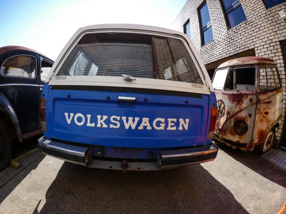

        That Blue back end.....WTF??!?!
        Velly
        '91 2.0 8v GTI
        Originally posted by DubSteve
          Oh, it's full of WTF. (and rust)

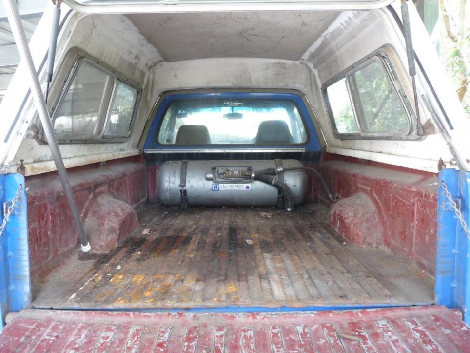

          LPG? seriously? The 2E motor still has it's injectors and loom attached even though it's gas only.
          It's got a 5 speed box but they didn't have the right gearbox mount so there's a bolt welded to the chassis rail to hold the gearbox up.
          If this is an example of VW Country workmanship I'm not surprised they went out of business.
          I doubt I'll ever know the full history of this thing.
          I'm sure there will be many more revelations when it comes home and I pull it apart.

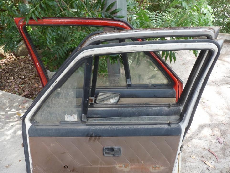

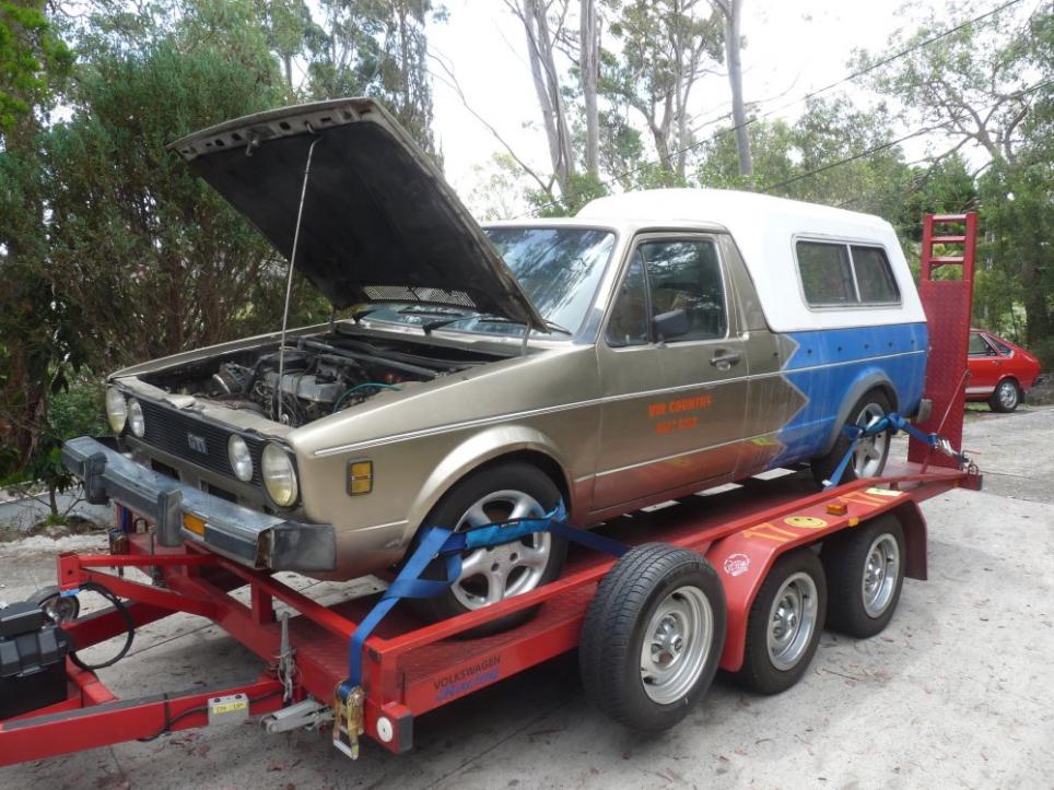

                        Got it home OK.
                        There's a lot of rust up front, I think I'll just buy in the rust repair panels from heritage and replace as much as I can.
                        The bed is wavy but not rusty.
                        Bonus doors in the back.

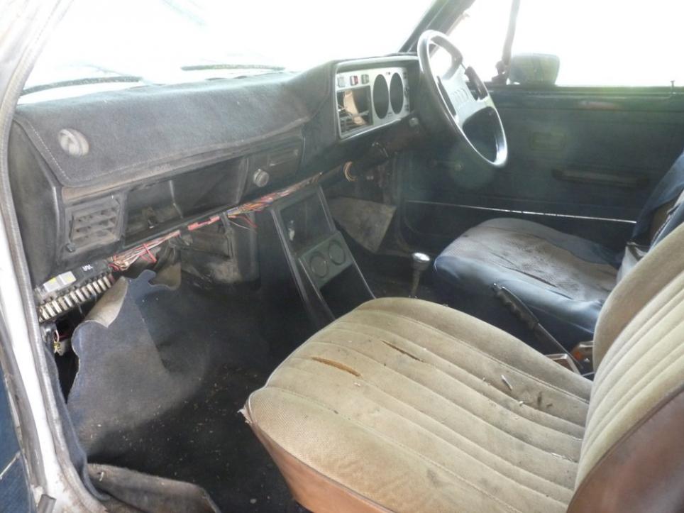

                        Uncracked dash! It's one of the hard plastic ones.
                        No door on glovebox.
