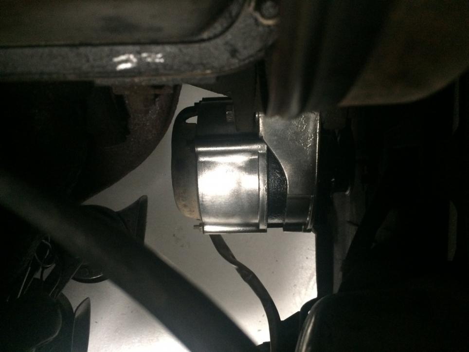

Dragged the battery home, charged it up and drove back to the mechanic. Checked the alternator and this was causing me all the drama "not charging".
Now I have this shiney little guy
Excitedly got all back together and went for a drive............

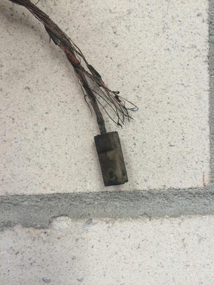

Then we found this......
Now with some dodgy wires replaced the battery was charging.

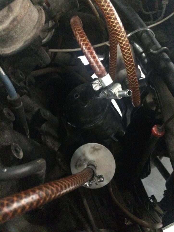

Now for the fuel issue.
This little thing is a fuel return valve,
we by-passed it and took the car for a drive, car had plenty more go abut was still running out in higher rev range. Fuel Pump?????
will change these out next week and see what the out come is.

Does it have the diaphragm pump mounted on the block? Looks like thats what it should have with the fuel setup you have. You dont want too much fuel pressure to the carb. If its running out, it might be the pump. They are good for the stock carb and if you can find a good working 2nd hand one you'll be right. I think you can still buy them new too.
Have a look on vagcat for the part number.'07 Touareg V6 TDI with air suspension
