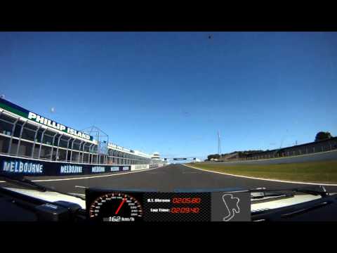

Here's the video of the round 4 flying laps. Lap 1 is the fastest of the day.
I think I can knock at least another second off that if I get a bit braver in turn 1.
Previously I'd brake and change down to 4th. During yesterdays runs I figured out how to get through there in 5th with sufficient RPMs but I think I'm braking too hard and could go in faster.
I'm having a few issues with the GPS data for the other rounds, I'll try and upload some more videos tonight. Be sure to watch them in HD with the volume turned up79 MK1 Golf Wreck to Race / 79 MK1 Golf The Red Thread / 76 MK1 Golf Kamei Race Car

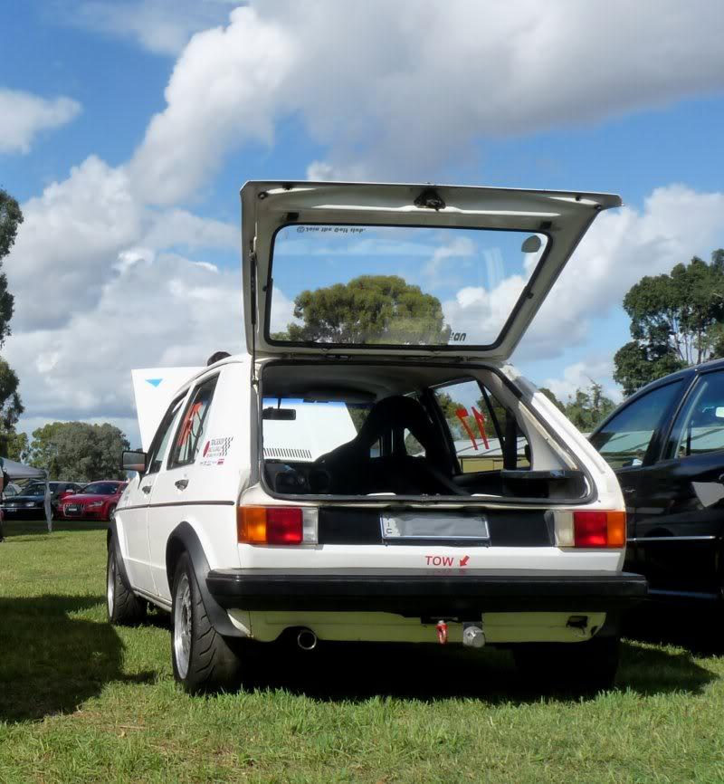

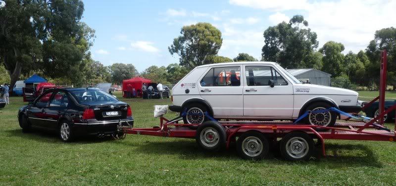

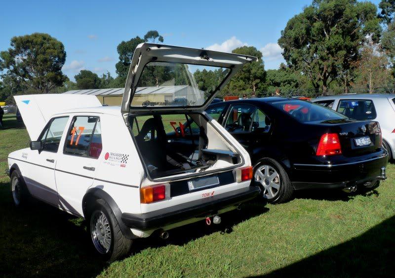

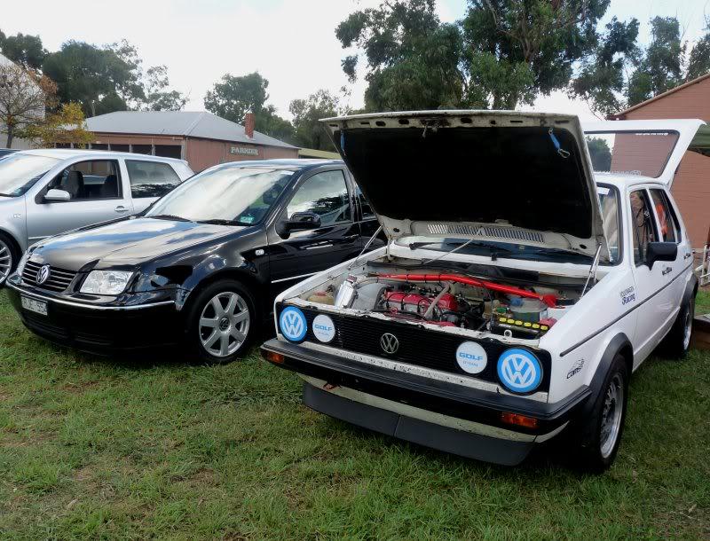

Bit out of sequence, but here's white at SEDF.
