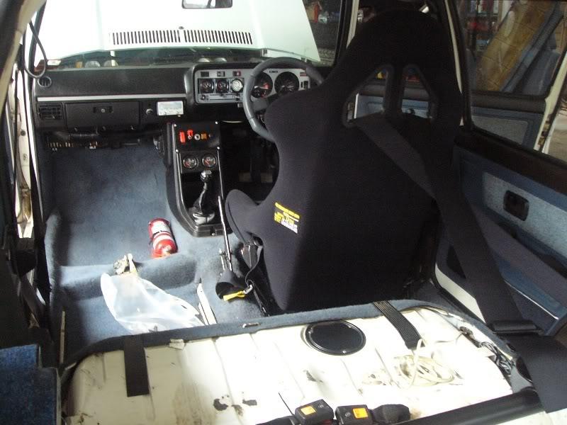

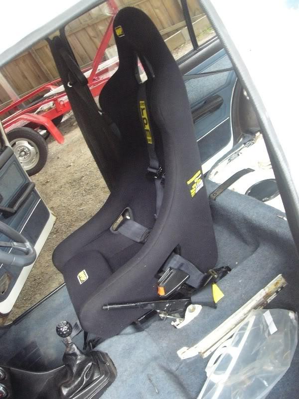

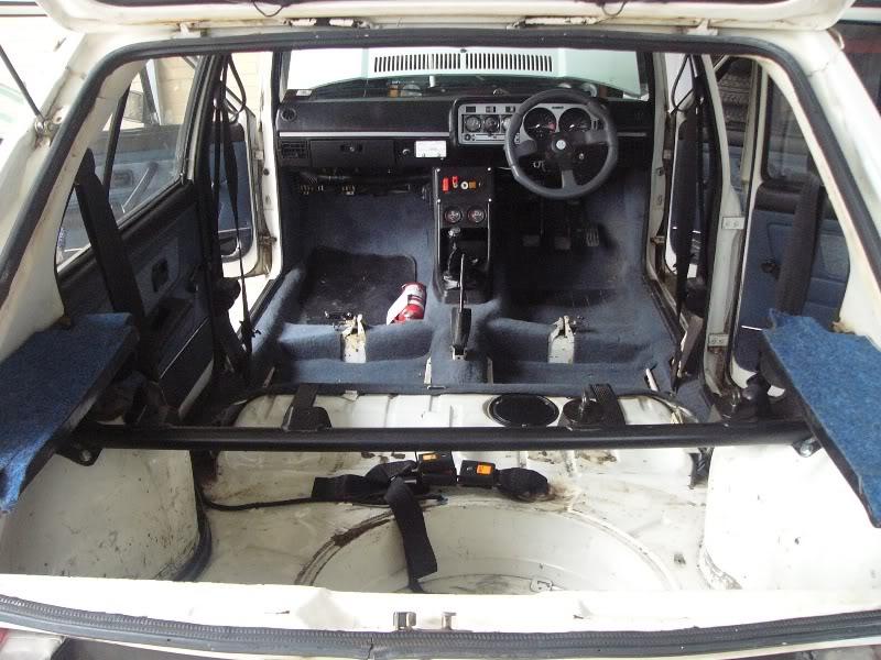

Just getting ready for tomorrow.
This is the new seat all mounted up. Managed to get it even lower than the last one whilst still using the factory mounts.

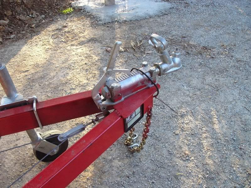

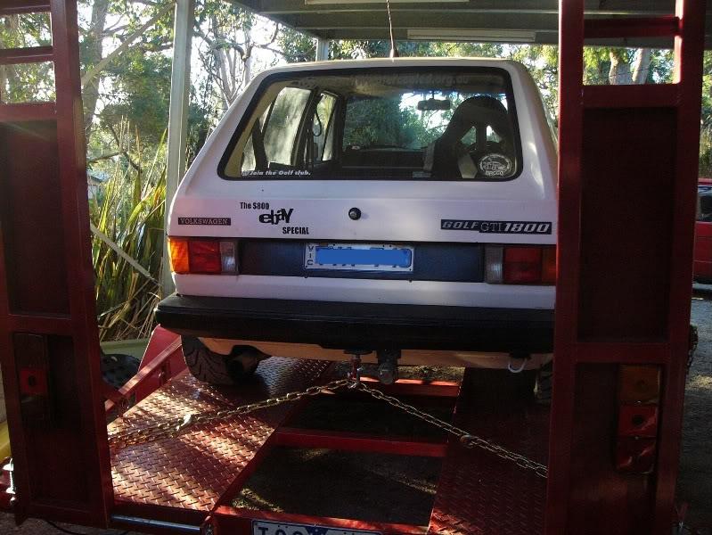

This is the finished trailer too by the way.

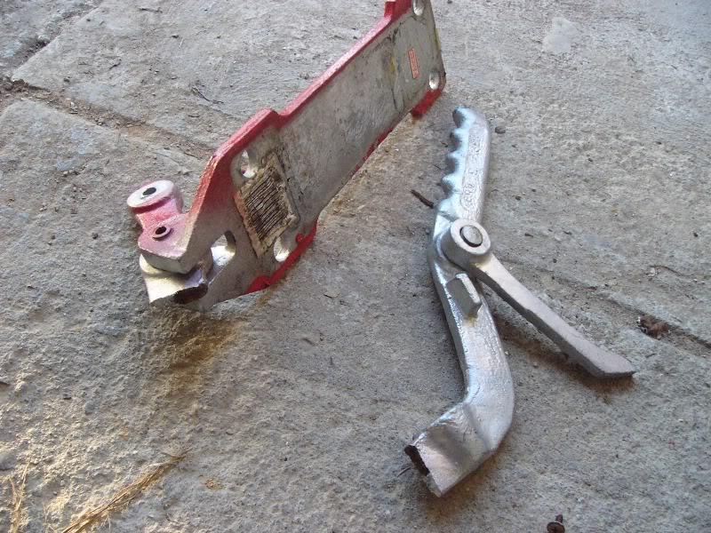

Had a bit of a mishap with the trailer brake lever. It snapped clean off while I was setting the handbrake. It's clearly been fractured for a while. Just as well it didn't fail in service. Forunately SuperCheap had one in stock.
All Fixed.

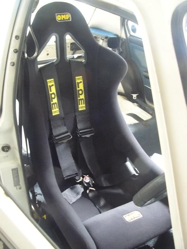

Great project, looks like it will be a heap of fun, just one thing, am I seeing things correctly in that you have your harness's crossed over each other from the harness bar through to the seat?
If so and your car is going to be tech inspected it will fail with them setup like this. Left harness through the left hole looking at the back of the seat right harness through the right hole, any other way and you will have to change it.
You can always check out the CAMS manual online for any info like this on how safety equipment has to be set up.
Cheers Al

Originally posted by quozl View PostGreat project, looks like it will be a heap of fun, just one thing, am I seeing things correctly in that you have your harness's crossed over each other from the harness bar through to the seat?
Cheers Al
Thanks for the heads up. I'll straighten them out to avoid any confusion trackside.
