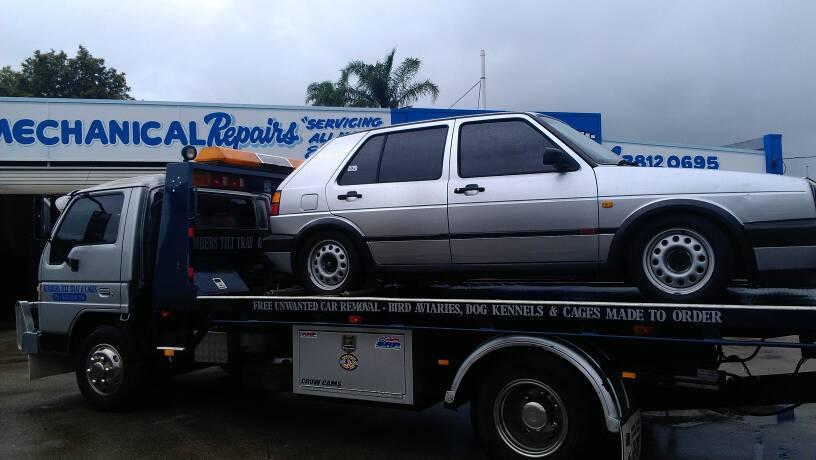

    Massive fuel leak, stuck far away from home and no money to pay the mechanic.
    My life rocks.

        Fuel has some how managed to get in to the throttle body, in to the oil and in to the air box. Sooo... its over fueled and pumped it into the cylinder, and then pushed it back out of one of the intake valves? I don't know how else it would get that far up the intake.
        At best it will be oil change, drain out throttle body, manually turn over the motor with no plugs to try to clear out the fuel... no time to do it today of course, and no time tomorrow.

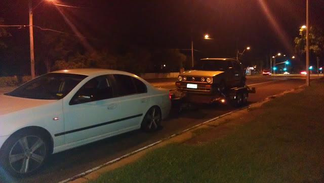

            Don't have the money for them to spend hours and hours diagnosing it, so going to have to tow it home until I can figure out what the problem is...

            • #21
              Feels good to have her home... now I just have to figure out whats causing the problem.

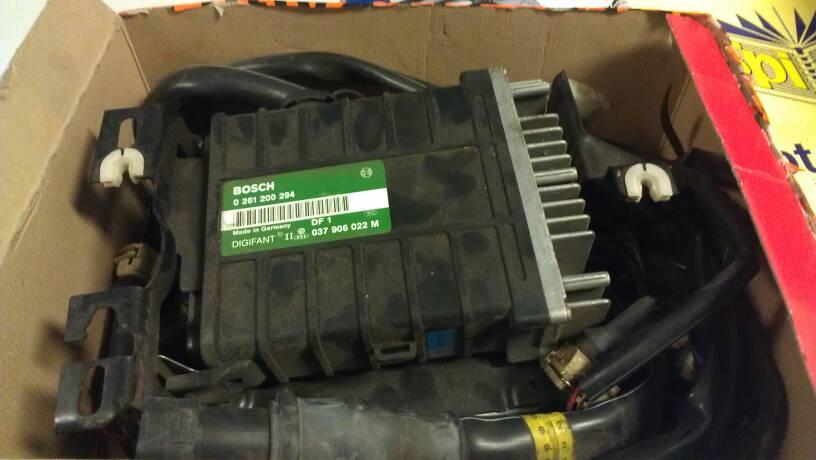

                New loom to replace the custom rodent special and new ecu to replace the current dodgy one.

                              And as I had hoped, oil change and new plugs has it sorted. Ecu was indeed the issue.
                                Great to hear, that'll be that cars 3rd ECU!?!
