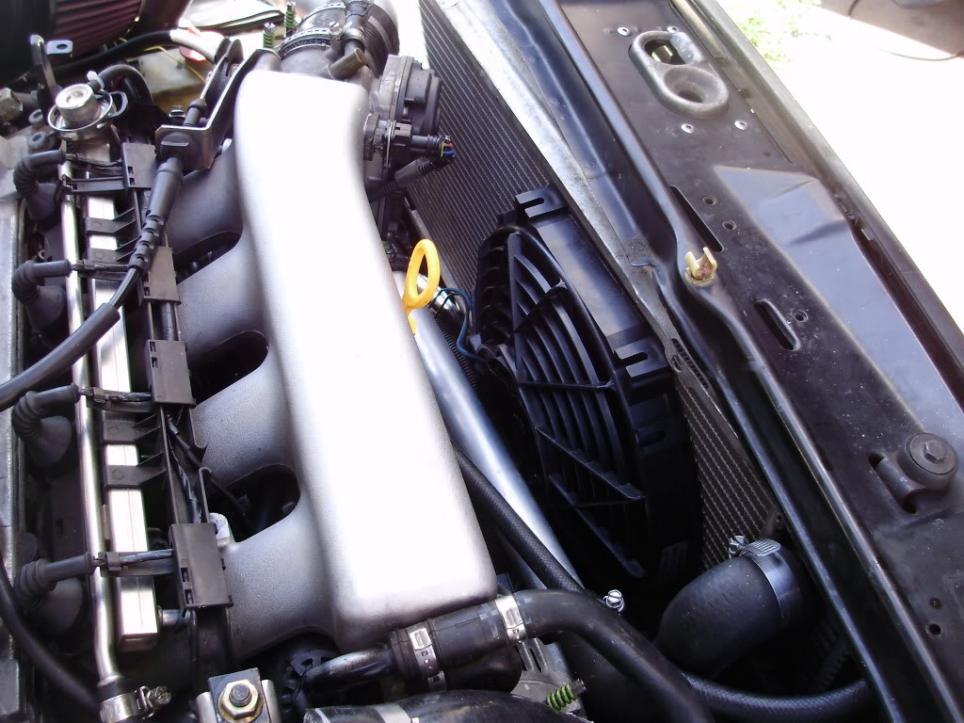

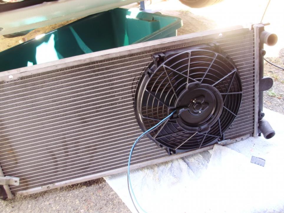

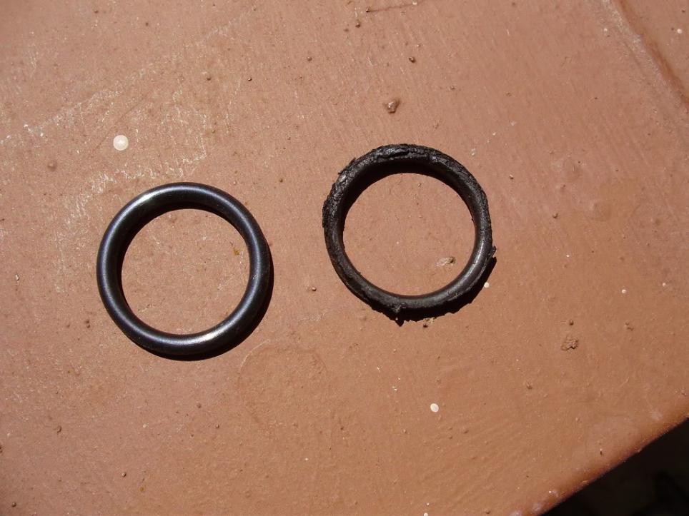

                              • In the meantime, I did a few little jobs the other week. The front steel heater pipe was leaking water where it goes to the block on the front.
                                Check the old o-ring!!!
                                Then I took out the rad and mounted up a fan while i was at it.
