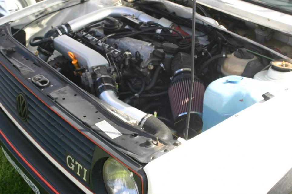

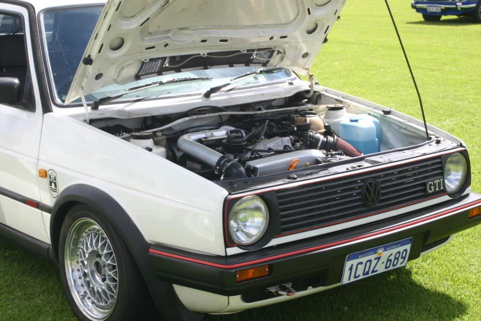

It Begins: The S3 1.8T into my '85 Mk2 GTI
nice one fella! Not long now!VW: it aint just a car, its a way of life

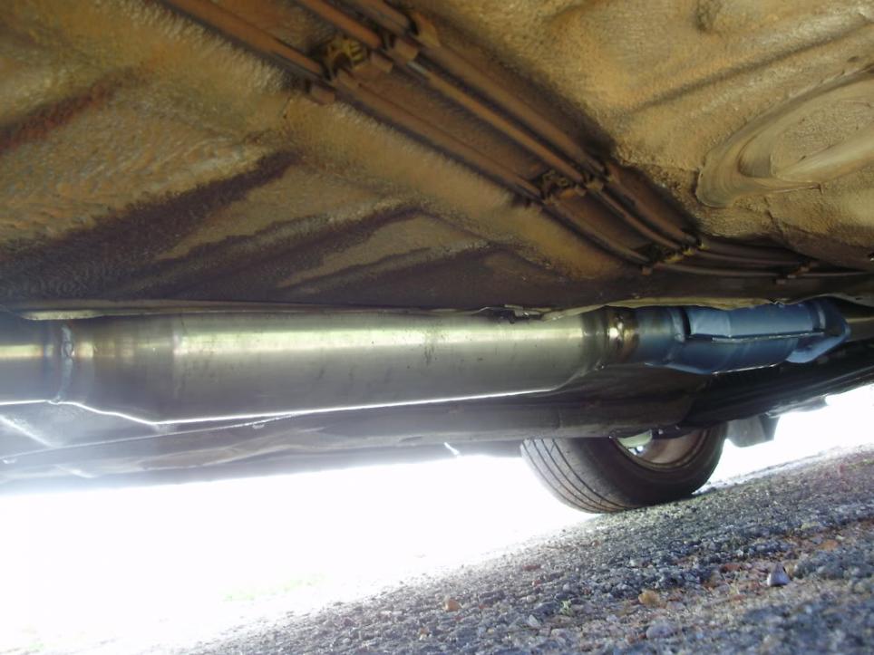

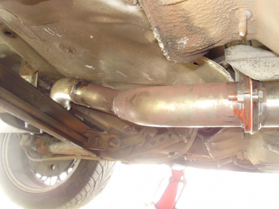

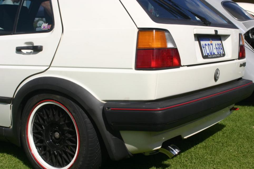

took some snaps of the exhaust while i was under there. 2.5" all the way, big resonator, high-flow sports cat and a Lukey rear muffler. Almost sound standard heheh!
I got them to weld on my stainless downturn tailpipe too.

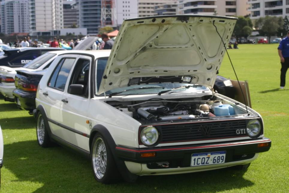

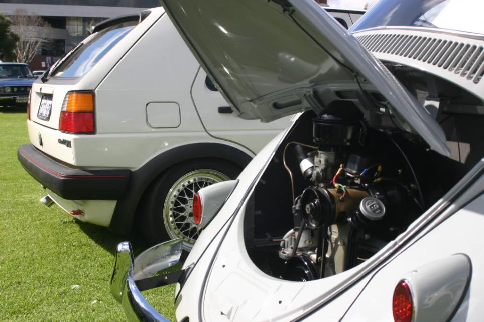

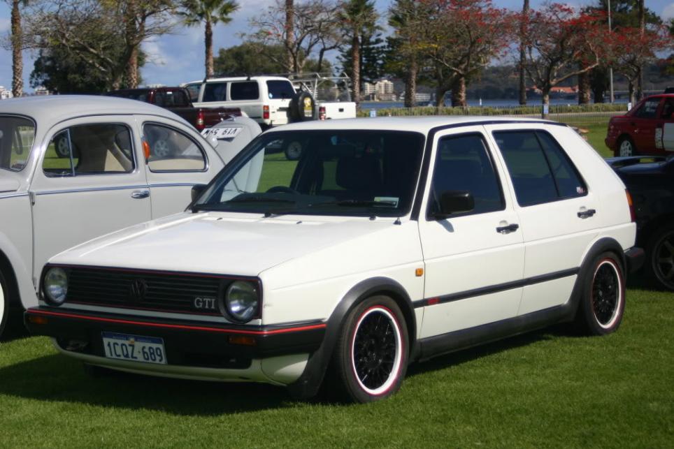

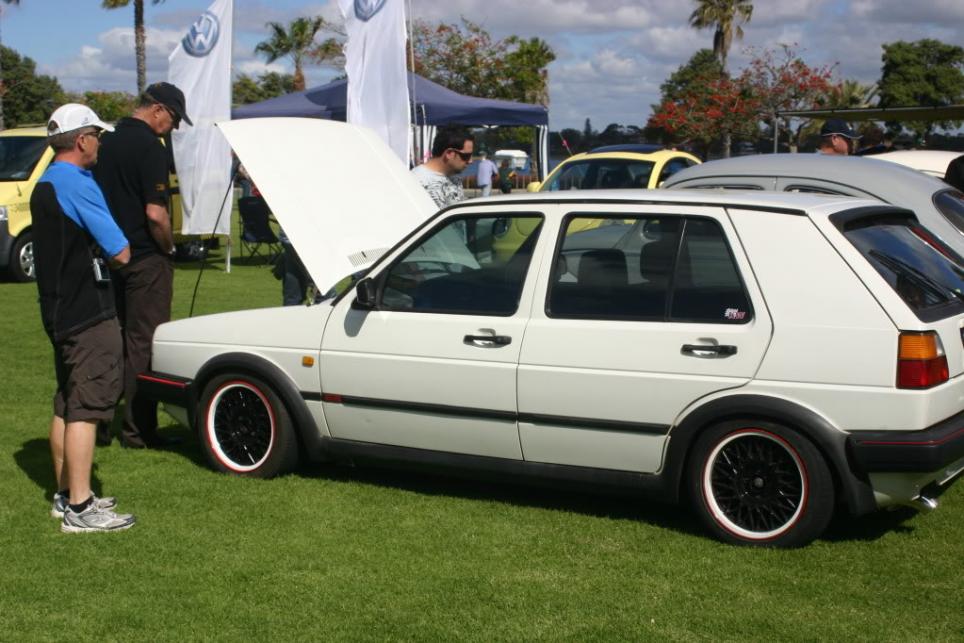

I went to the TargaWest special stage at Langley Park today and parked it up with VWCWA display. Had lots of curious punters crowding around it which was pretty sweet to see. I took some pics which i'll stick up here later.-1990 Mk2 GTI 5-door with AMK 20vt (260hp @ wheels)
TargaWest display pics as promised.

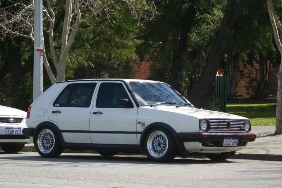

So yeah, obviously I did the big to small bumper conversion with the metal lower panel painted with a spray can and soldering on the later indicator plugs to suit the big bumper terminals, and used electrical tape for the red pinstripe (just for now haha)!
Just need to find a nice straight lower splitter...-1990 Mk2 GTI 5-door with AMK 20vt (260hp @ wheels)

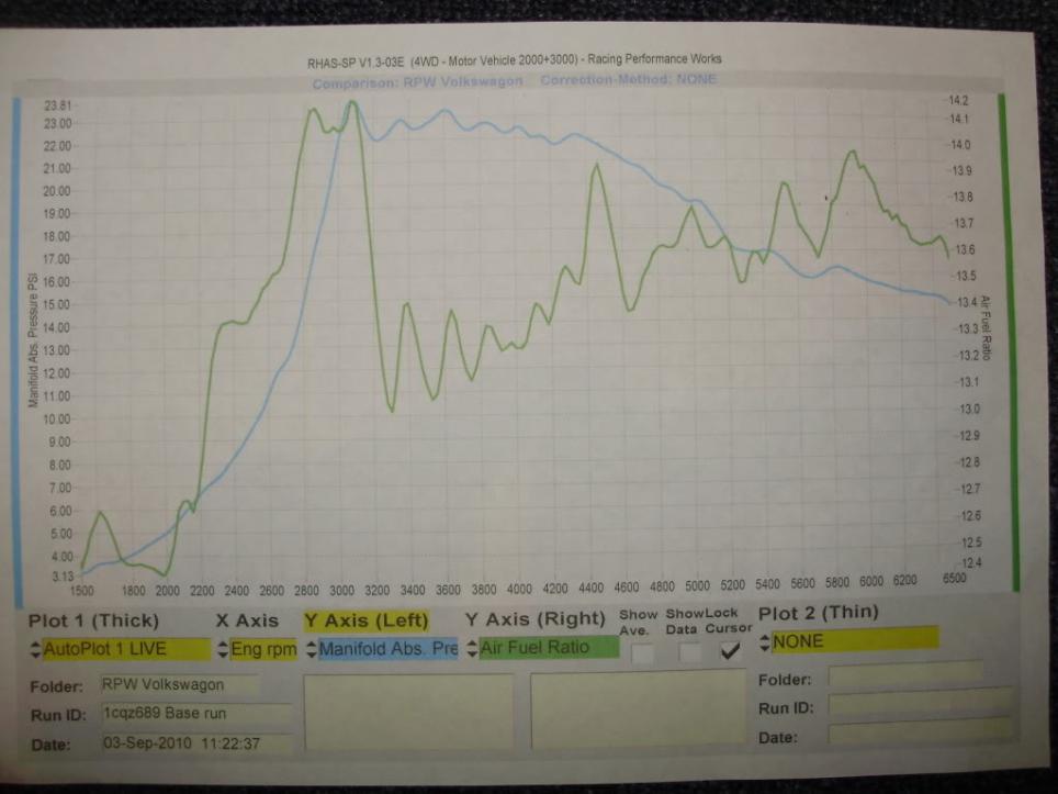

Well after changing the tank and spending $330 on a fuel pump, there is absolutely no difference and it still runs hell lean on boost. Dave at RPW reckons it has to be ecu map related looking at the behaviour of the boost/fuel mix graph.
Pretty pissed off. I fired off a slightly frosty email to QPEng and they are sending some sofware files to map the thing. So much for "plug n play"!
Here's the printout. Any thoughts???
My next jobs are to replace anything related to fuelling; all the vacuum lines from/to the MAP sensor, the fuel pressure reg, I think i'll delete the mk2 fuel accumulator as it's not necessary, and I'll try a new oxy sensor too, although that only really functions during closed loop running (off boost), and its fine down there. Coupled with the tune, I'm hoping that should sort it out once and for all...

Wade, Having thought about it, I am going to agree with your dyno man. You should be able to prove it pretty quickly, once you have the tuning software. A good read of Dave Walkers book will see you right.
I'd add 20% everywhere on boost just as a quick check. It'll blow a heap of smoke most likely but you'll know straight away. You can trim it out then.
