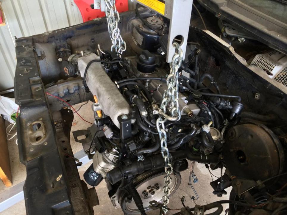

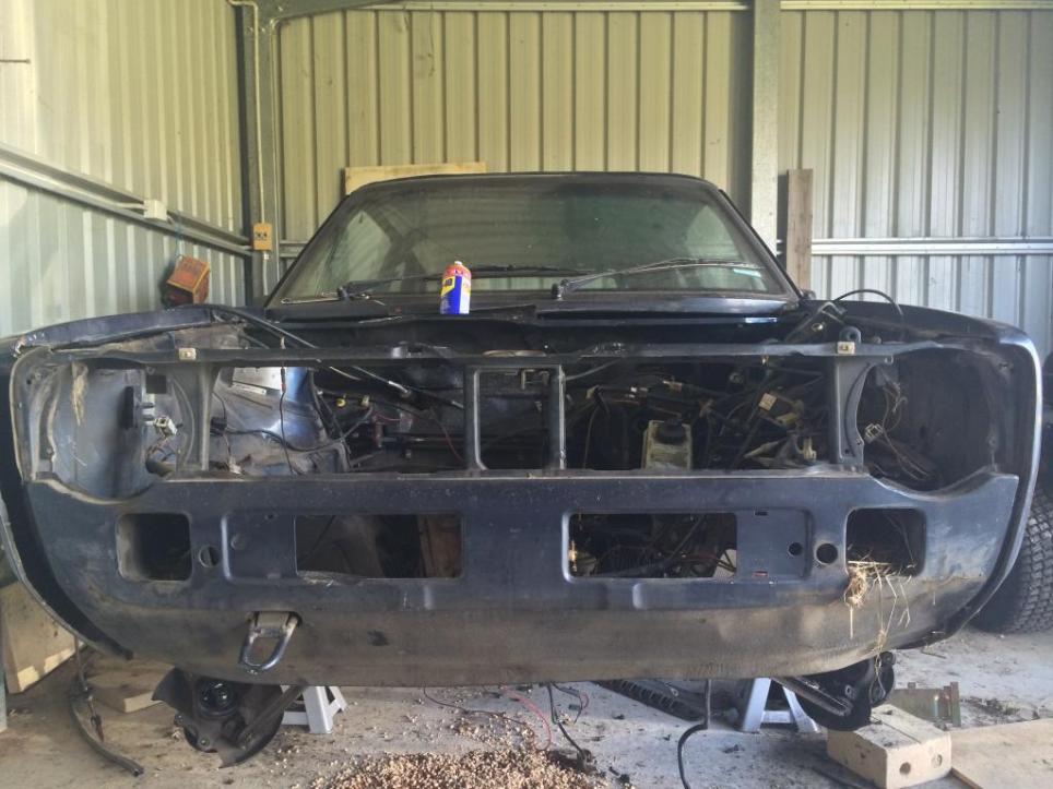

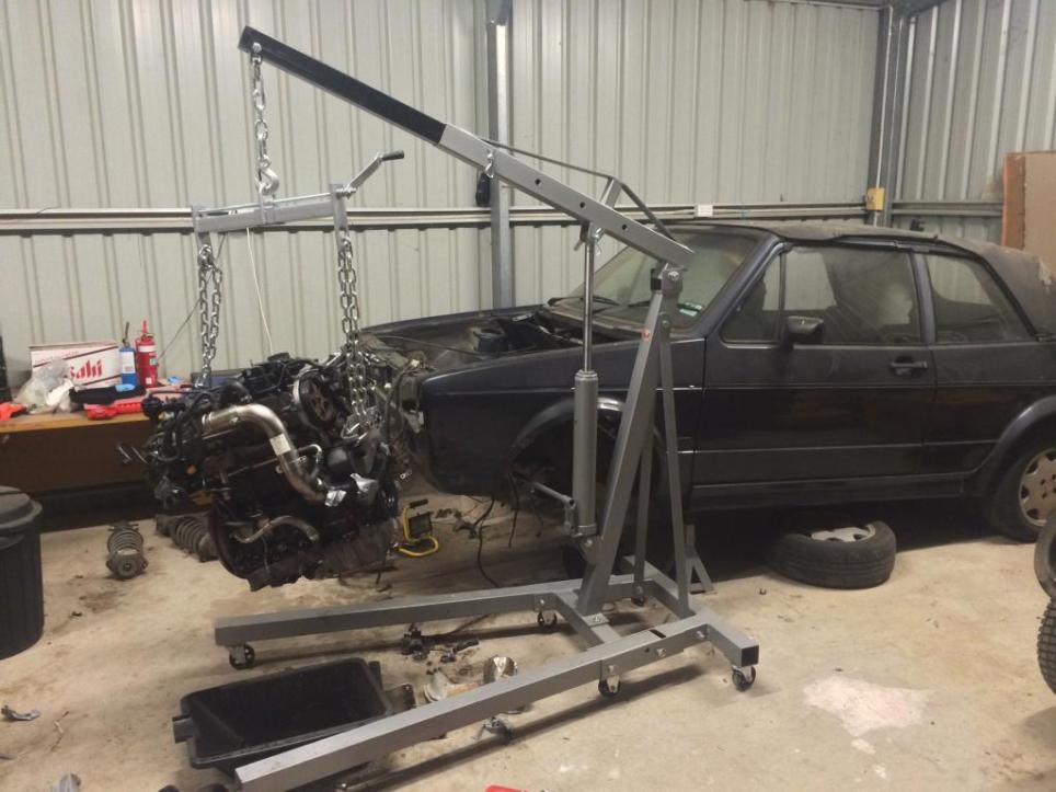

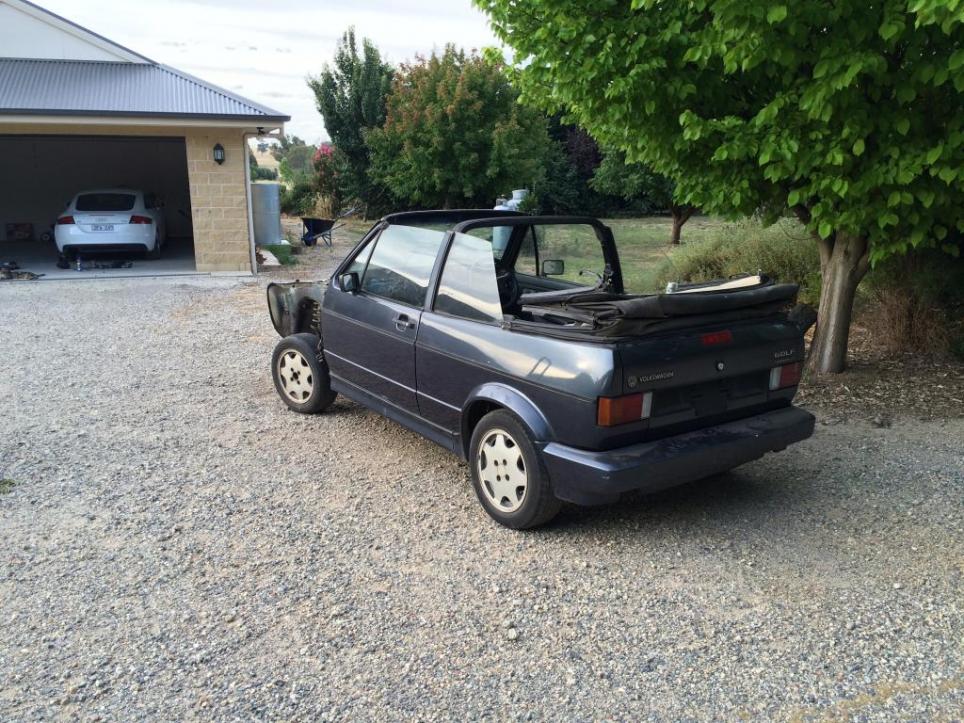

Bit of an update on progress to date regarding stripping and sourcing parts:
Here's how she's looking at the moment - only a few more things left to remove before I can start working on painting the bay.
I've managed to sell pretty much everything I'm not using which is great - only really left with the block, pistons etc from the 8V - everything has sold really well both here and in the UK so it's helped me fund the rest of the build for sure. I pretty much paid off the cost of buying the car with a handful of parts.

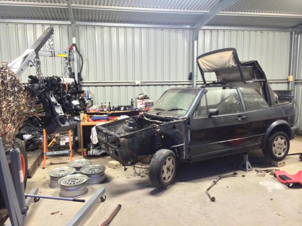

Thought I would update as I've had nothing to do at work all day.

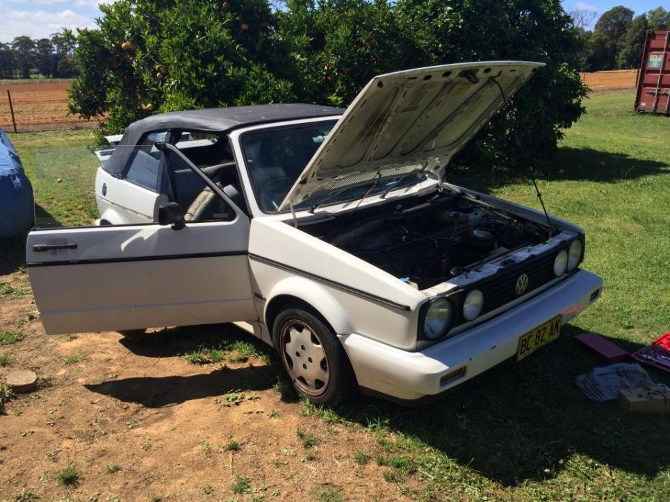

Drove 1500km round trip to steal the roof and a load of other parts from this poor thing:
The guy is wrecking it because the clutch has gone - first thing I did was look at the bulkhead and surprise surprise - the cable had destroyed it. A $20 fix to save a 100k cabby that was in great condition. Such a shame!

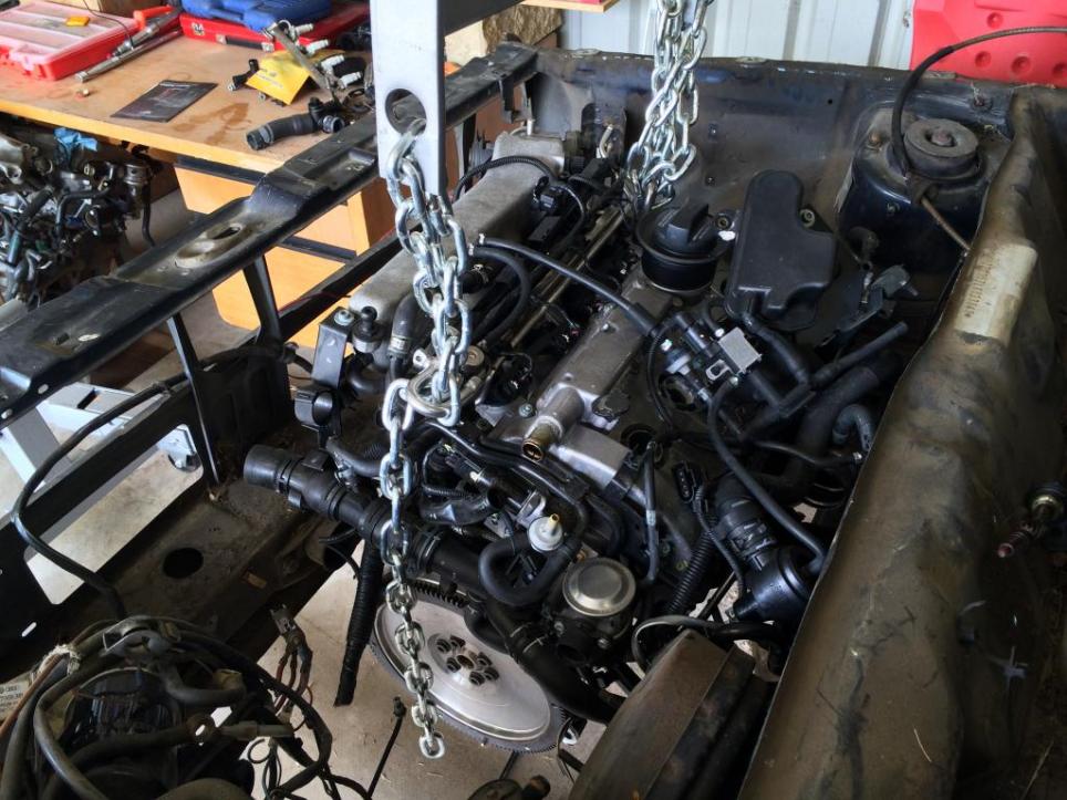

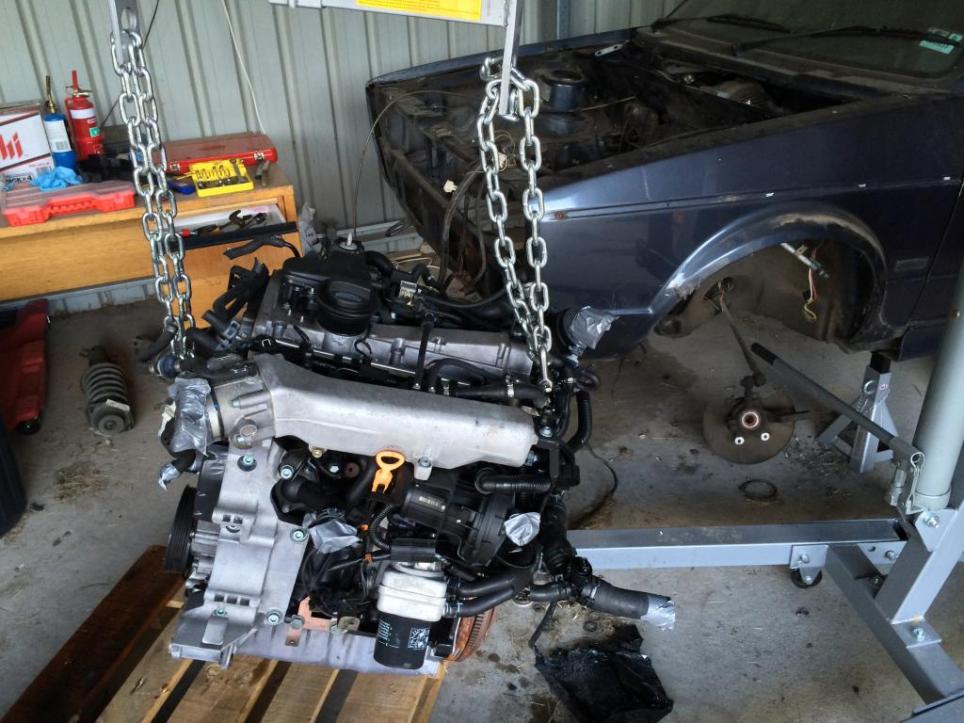

Also bought what was described as an AGU engine - turned out to be an AWU - ahh well. Either way it had only done 79k and looks pretty immaculate!

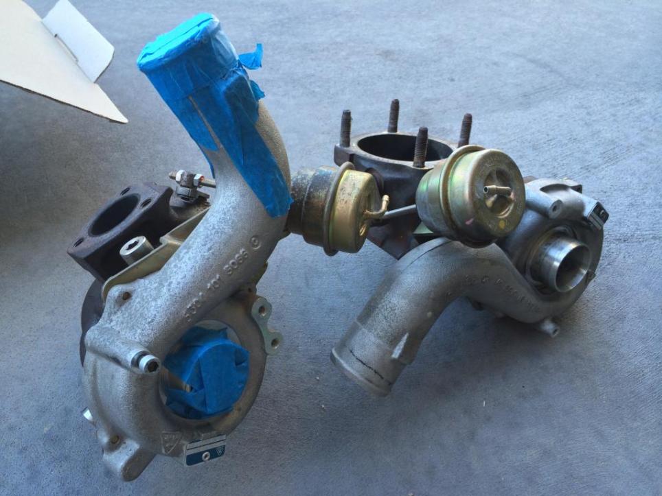

Within a few minutes of uploading the pic to social media I'd already sold the turbo off it which was handy as I already had a K04-001 in the shed.

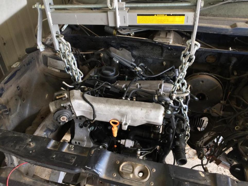

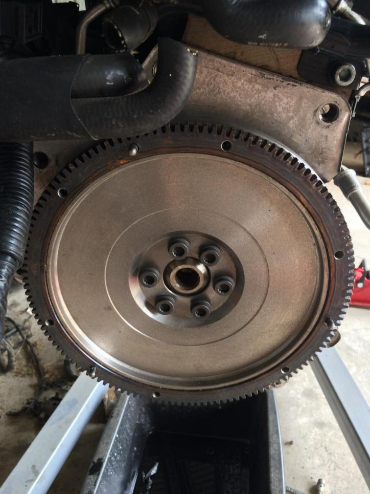

My dad just arrived from the UK with a suitcase full of parts - like this darkside lightweight SMF setup - got that all bolted up to the new engine.

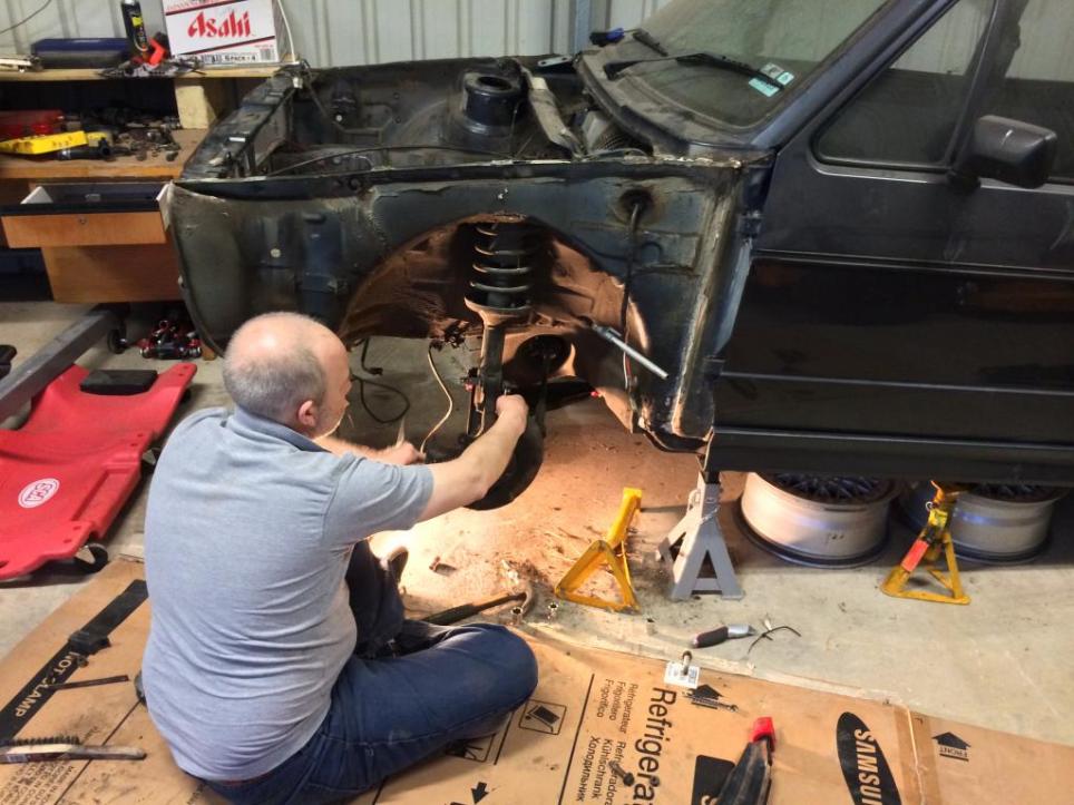

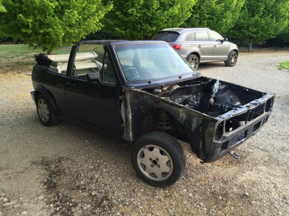

We've now put the struts, control arms etc back in to make it more of a rolling shell in prep for paint.

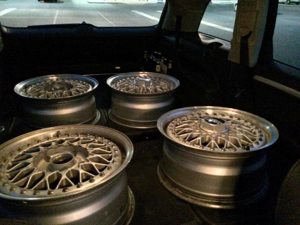

And yes you probably spotted the token BBS RS hiding under the car!

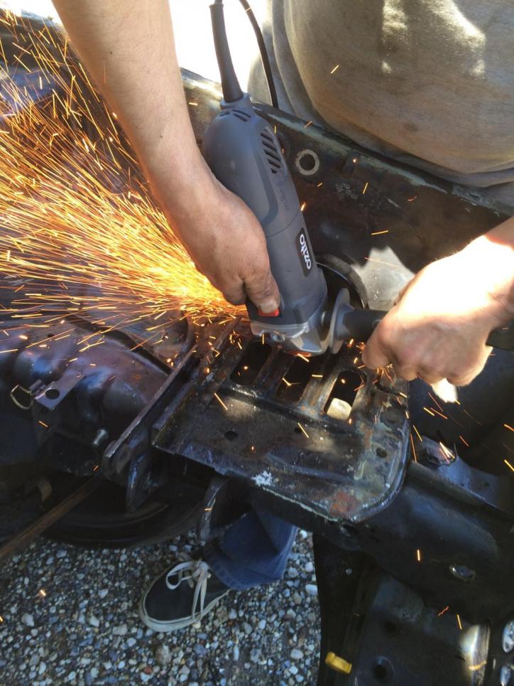

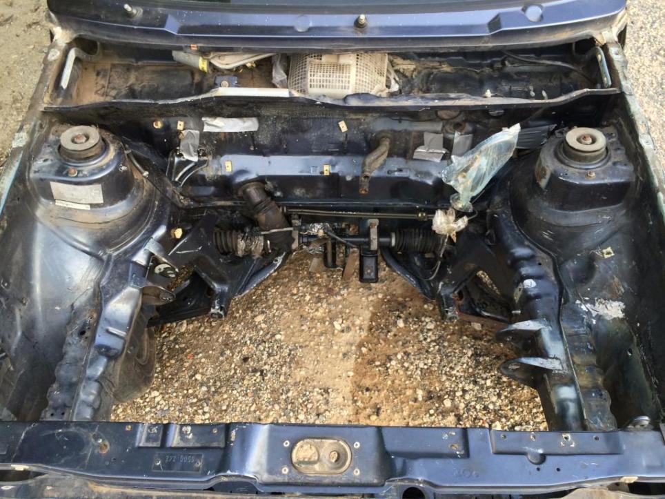

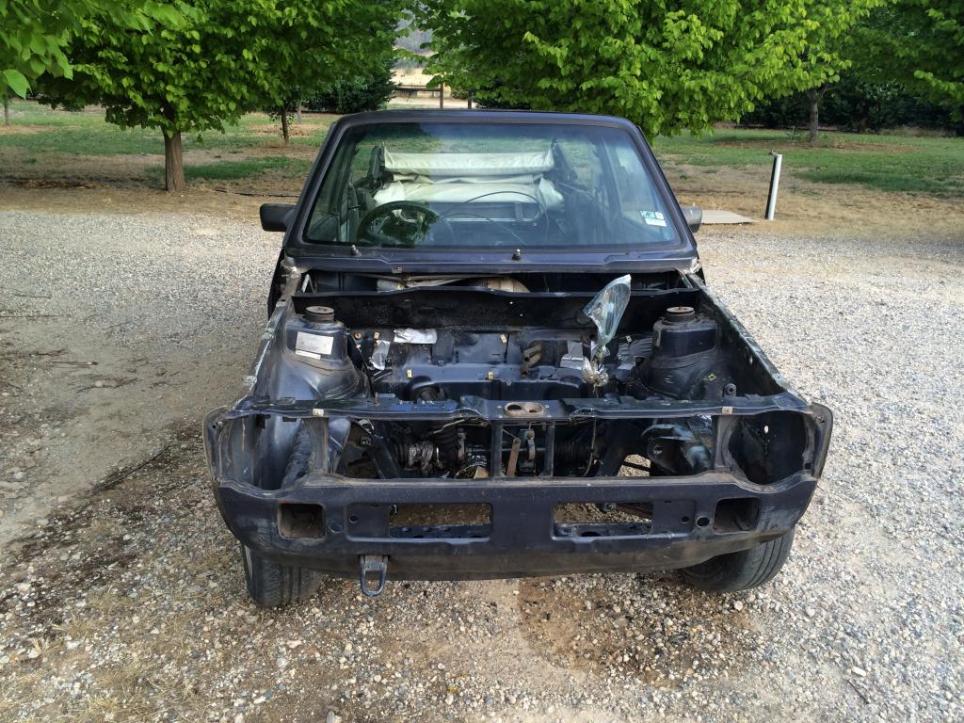

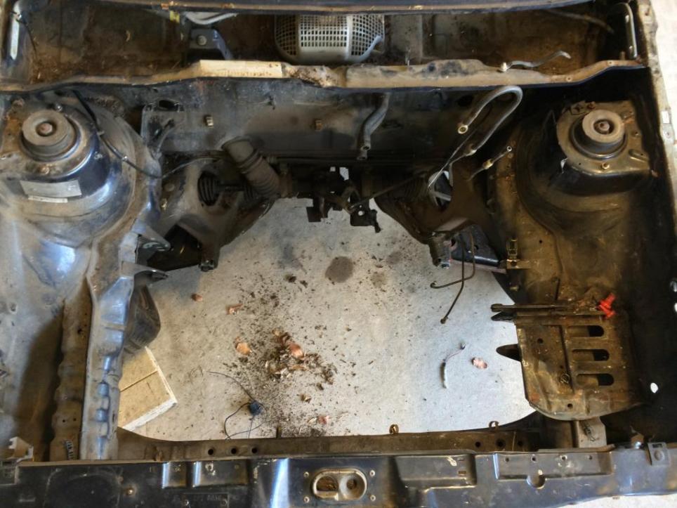

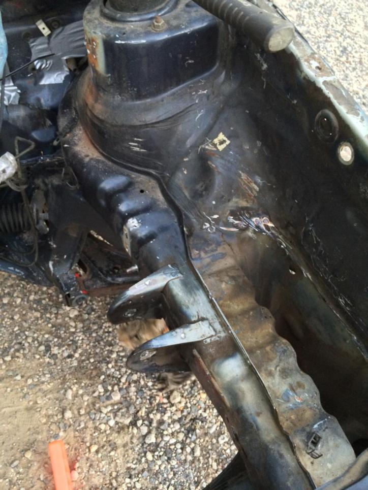

Got the grinder out over the weekend to remove a few things I won't be needing for the build. First to go was the battery tray, then coolant reservoir bracket, air box bracket and other random bits. Car looks heaps cleaner and love that you can properly see the gearbox mount now.
It was so motivating getting the car out of the shed and back on 4 wheels. Damn the mk1 cabby is such a nice car to look at! Even half dismantled!

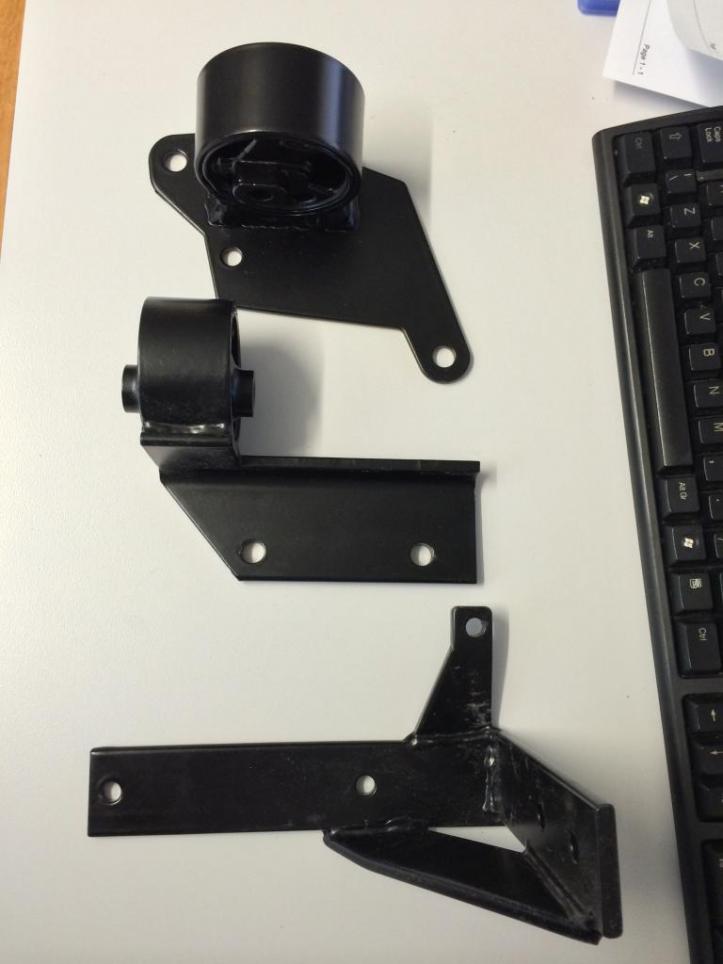

Next steps now are to get hold of a 16v timing belt tensioner and get that on the new engine along with the engine mount and I can start getting things mounted up and ready to go!2019 132TSI Tiguan

I have done the hyd tensioner delete on my Polo and it wasn't just the tensioner itself you needed. Check what you get in the IE kit.Originally posted by nightphotographer View Post
