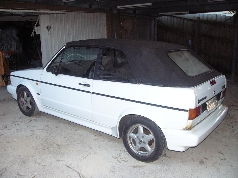

A friend of mine, Ian, purchased Linda, as he's decided to call it, off the forum last week.
Ian will take over the story once I get this out of the driveway.
My working on it is conditional on it appearing at Day of the VW in November.
Previous owner is Gary who goes by the name of Geeza around here.

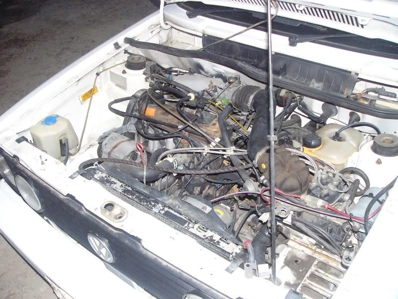

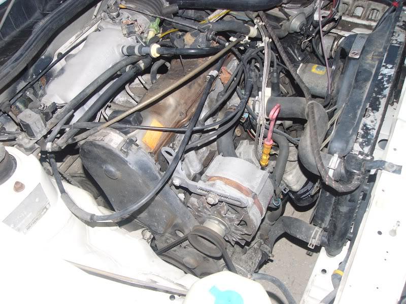

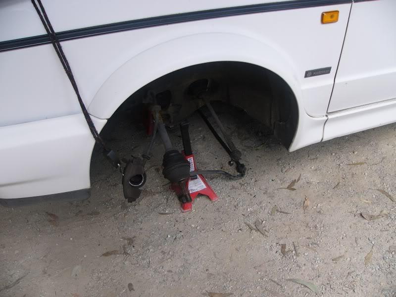

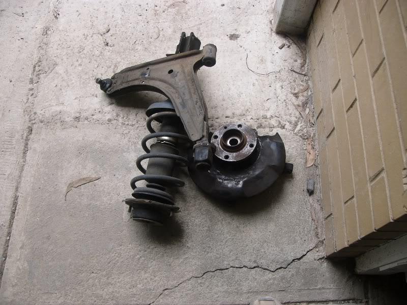

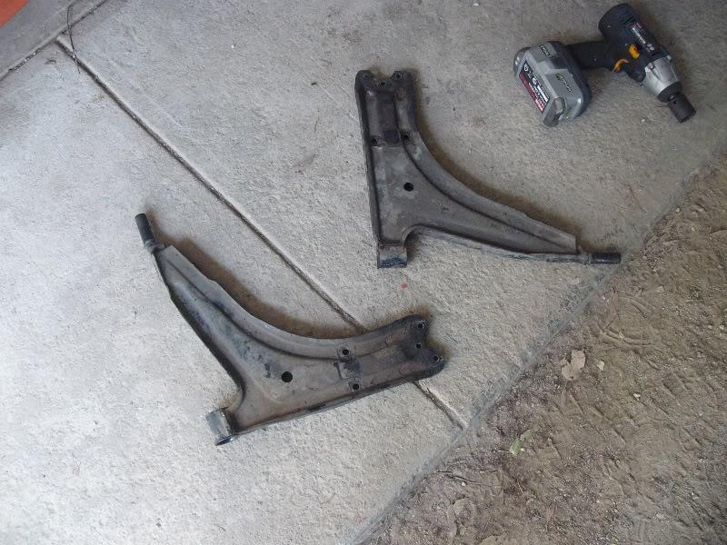

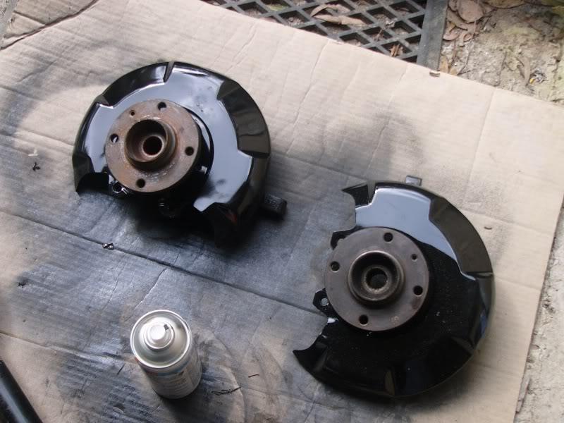

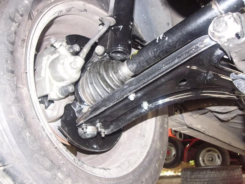

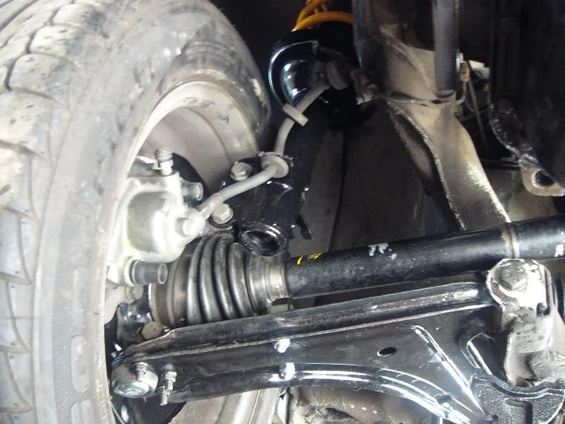

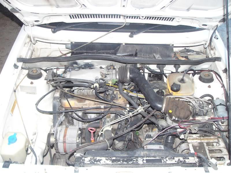

I offered to help out with a quick mechanical refresh prior to the the RWC.
This weekend we -
Machined the discs
Fitted new pads
Cleaned callipers and un-froze the slide pins.

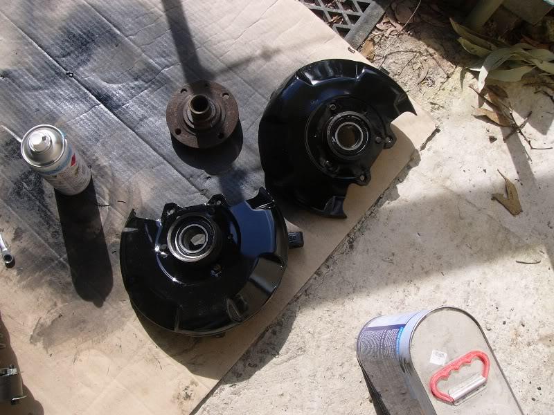

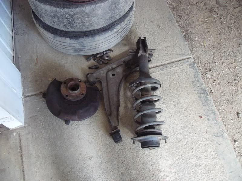

Replaced both front wheel bearings

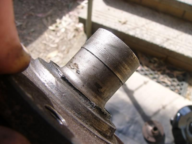

Replaced a stuff drive flange.

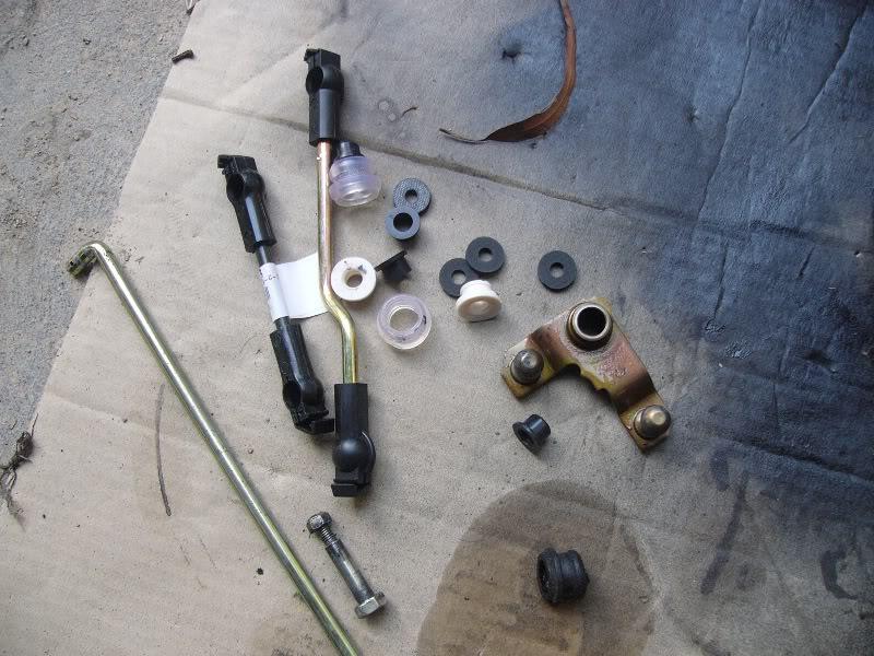

Re bushed the gear linkages
Replaced ball joints

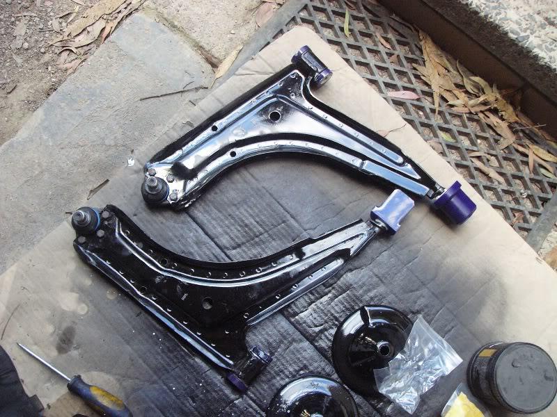

Re bushed front suspension arms with urethane bushes.

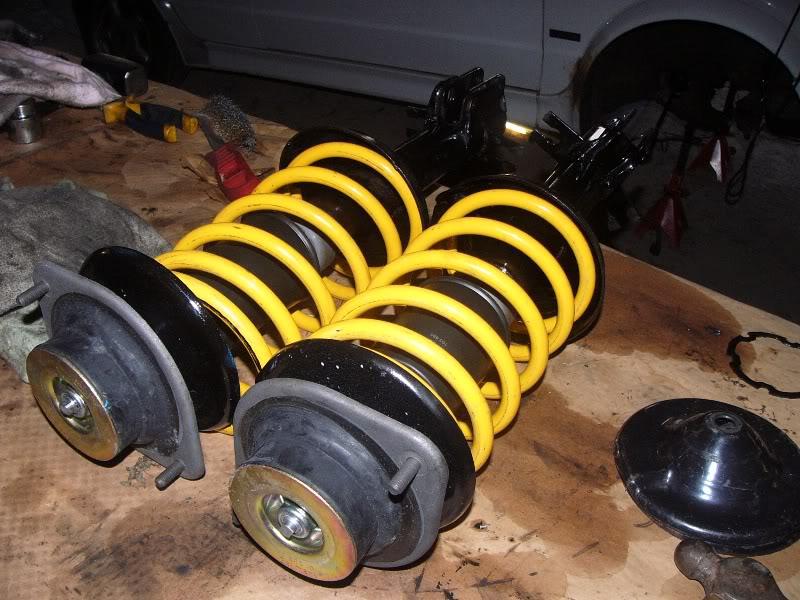

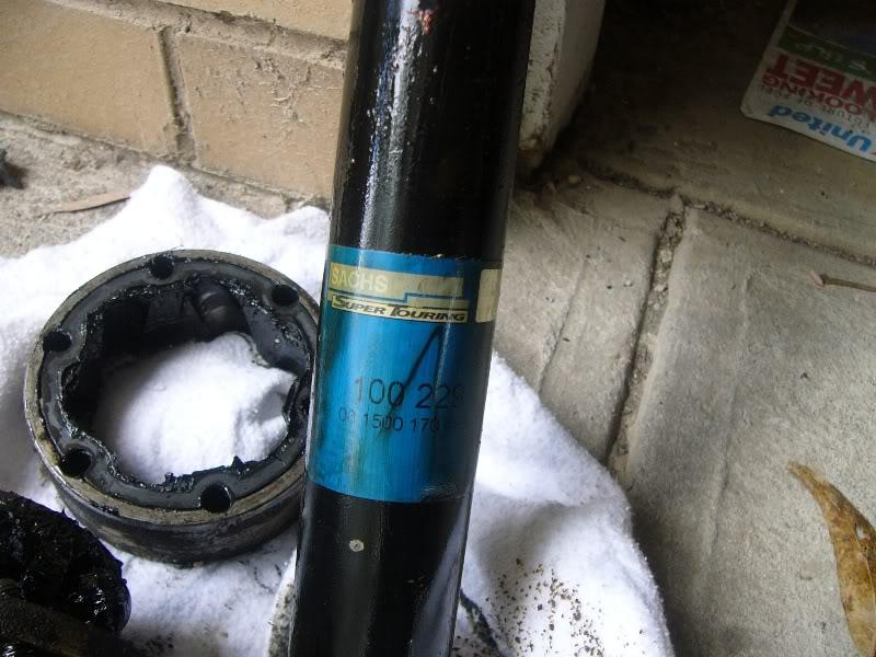

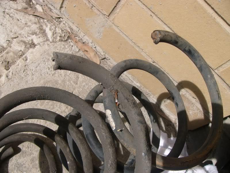

Installed the new AC Delco shocks and King springs that came with the car. Front and Rear.
Installed new strut tops.
New oil cap
New Fuel cap
New spark plugs
New coolant cap.
replaced one exhaust hanger.

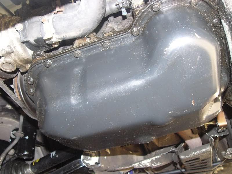

Oil change
Coolant change.
Brake fluid flush.
New tie rod ends
New steering rack boots

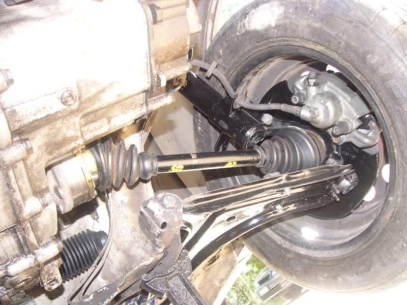

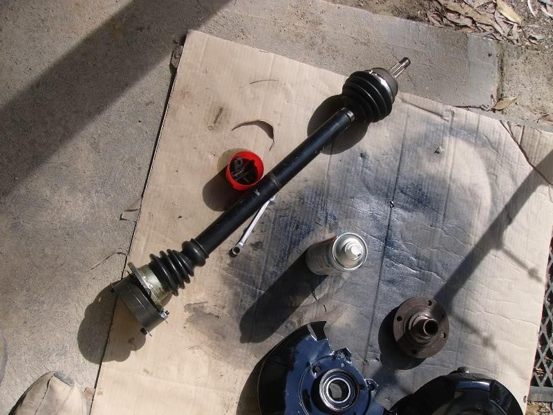

Cleaned and repacked CVs.
Changed wheels (for the moment)
Inspected rear brakes and repacked / adjusted wheel bearings.
Replaced a moulding clip.
Replaced bush in accelerator pedal.
Corrected attachment of cable to accelerator pedal
Lubed accelerator cable.
Adjusted accelerator to achieve full throttle (was only opening primary throttle.)
