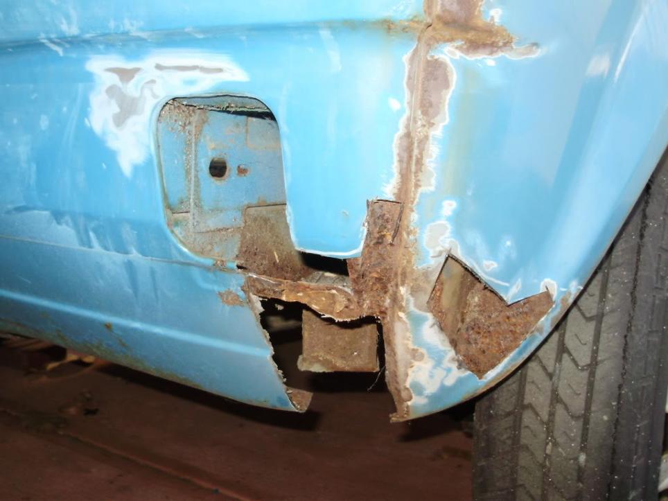

    Yeah they are finished. I just kept the good bit as spare panelling for future dings if they happen. I have complete immaculate doors to replace them with.
    It was a shame as they were straight as apart from the gaping holes!!

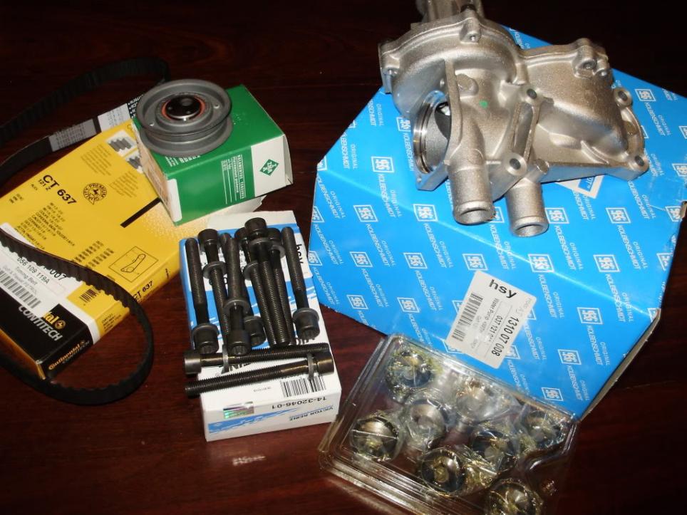

        A few goodies arrived... and some engine parts from work.
        I'm using the old EV/SD engine from my Grey '86 mk2 GTI that i had saved from that misadventure.
        The EV is of course the 8valve "big valve" head (with mild cam), and the SD bottom end is the 1.9 from an Audi 80. Good times.

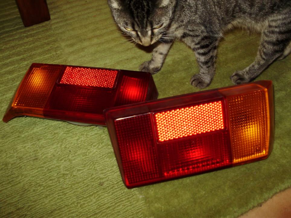

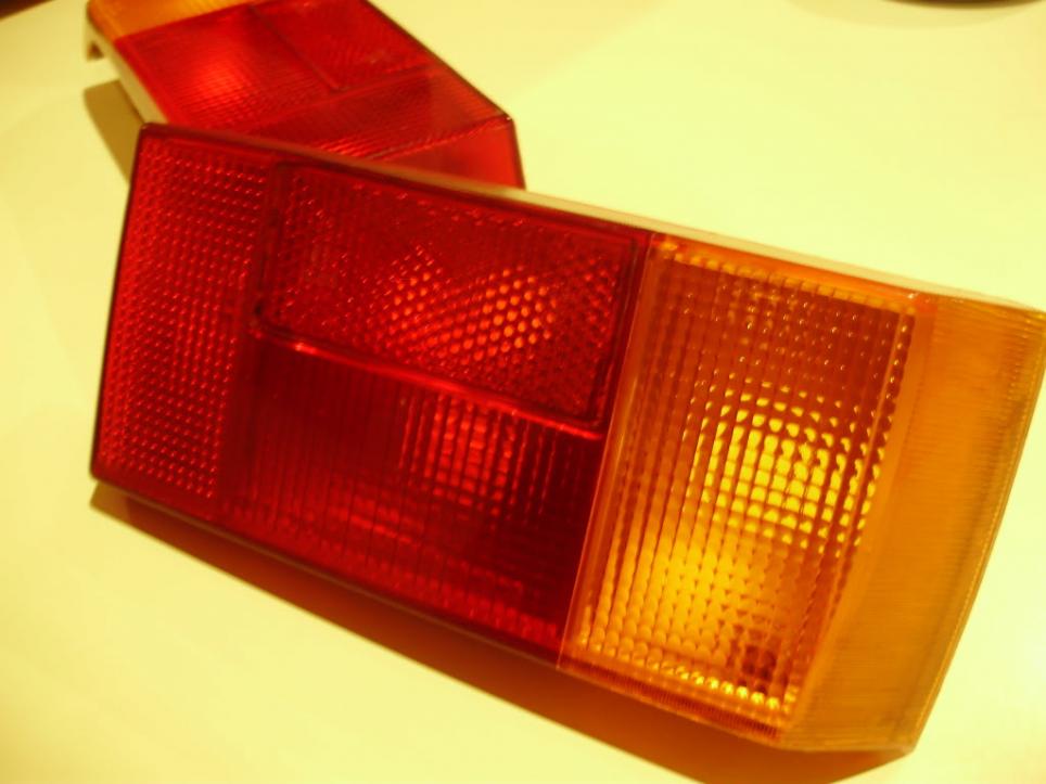

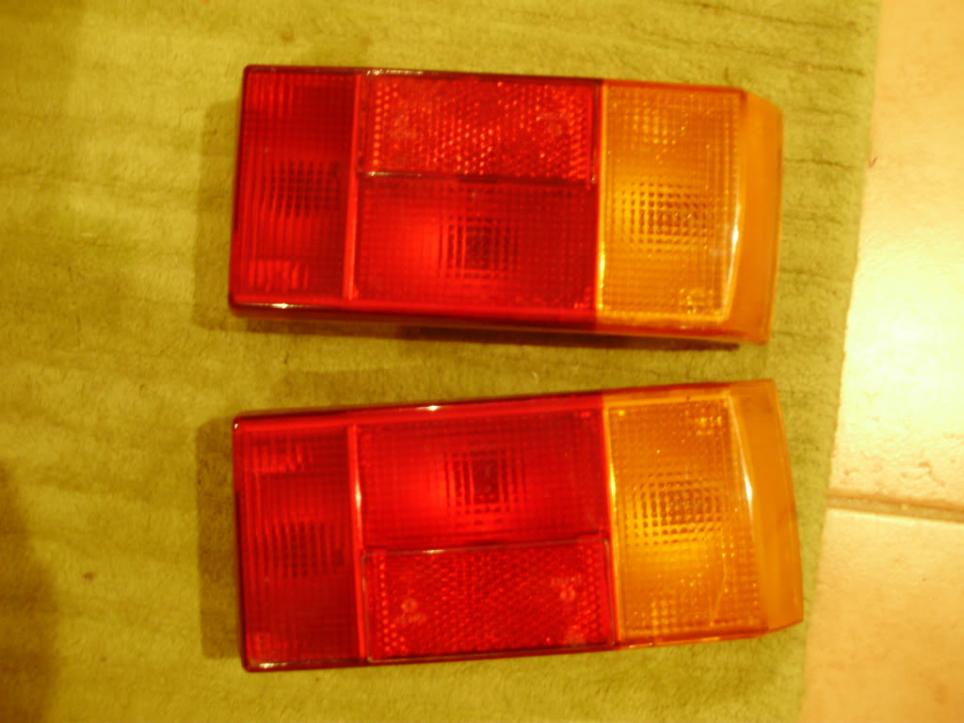

        Early Genuine 'postie' red tails...

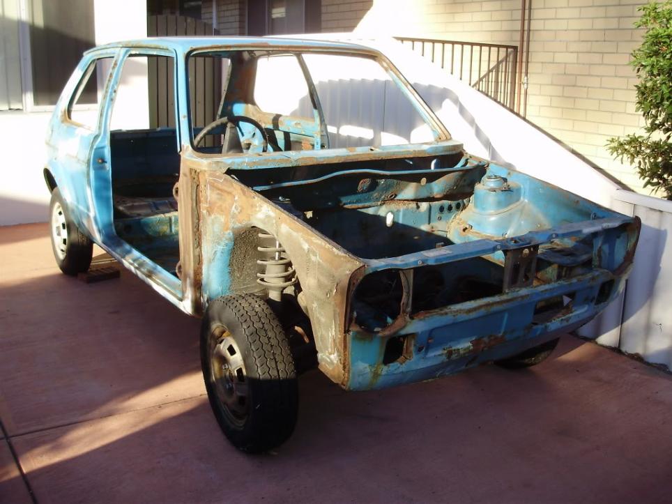

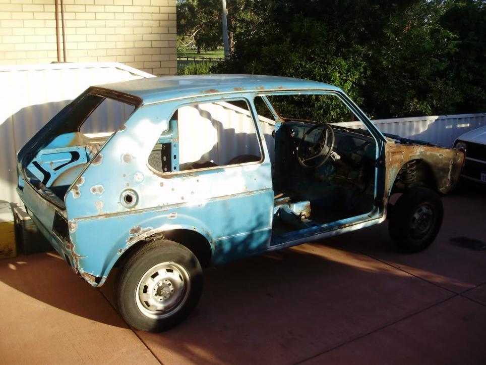

        ...and more surgery to do. The car is actually totally stripped apart from suspension, steering and fuel tank. There's a lot to do!!!!

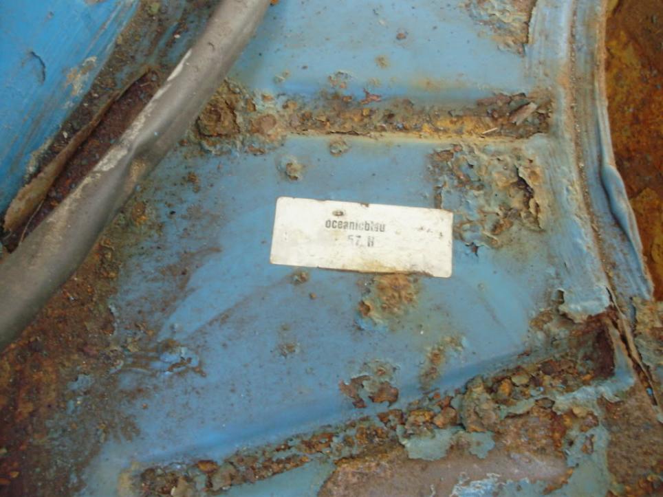

        Still has original paint code sticker 'Oceanicblau L57H' (oceanic blue) aka 'Reef Blue'

        • #19
          Where on earth did you mange to source the tail lights from?
          I'm having trouble finding anything except altezza style small lights at the moment.
            Ebay uk Pete. They are polished/cleaned up 2nd hand. Small crack in one of them but other than that they are good.

                I made a little job list with the help of Guru Grant:
                1. Light blasting/wire wheel at home to expose the bad bits clearer
                2. Cut out rot
                3. Weld in replacement bodywork
                4. Take down to Diamond Blast and blast the whole body & panels
                5. Bring home, blow/suck out blast media, apply phosphate to metal
                6. Apply Dinitrol rust converter in tricky box sections
                7. 2pak epoxy primer
                8. Cover up, and save $$$$ for final painting!
                In the meantime:
                Rebuild EV/SD engine and k-jet bits.
                Hmmm, jeez thats looking scary!!

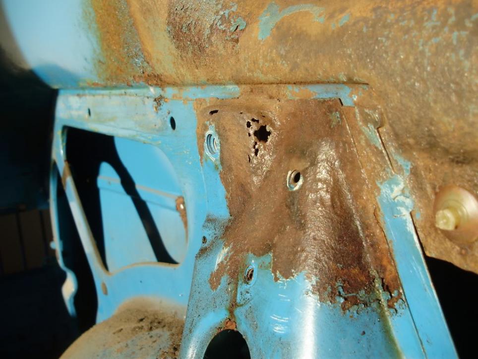

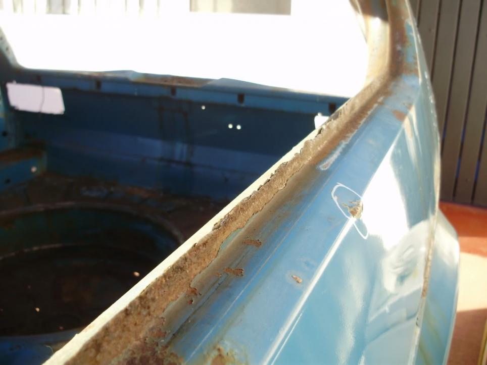

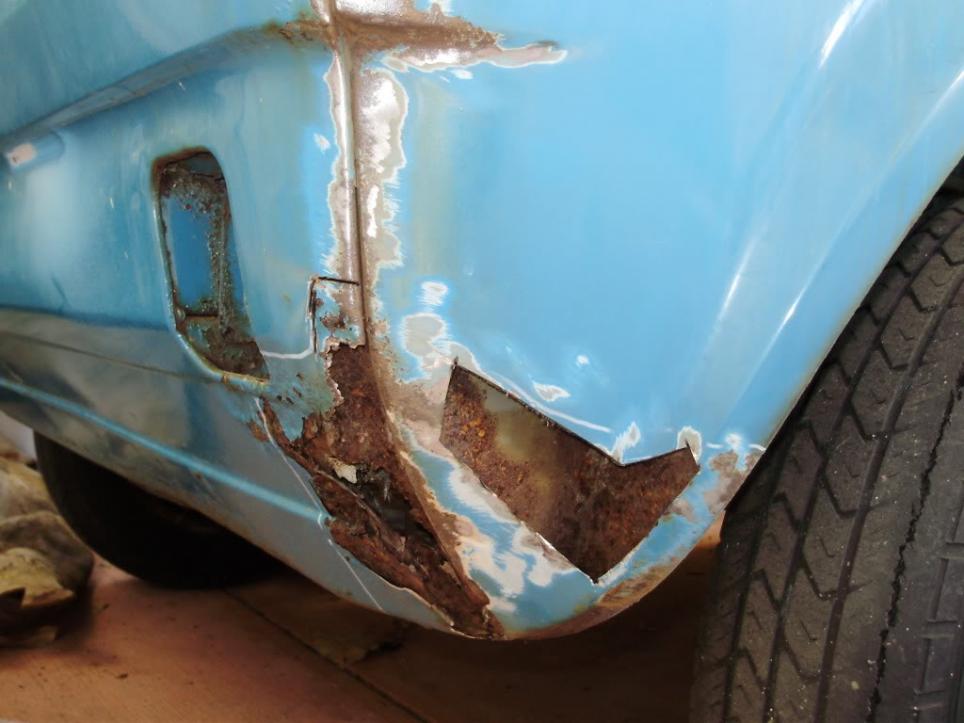

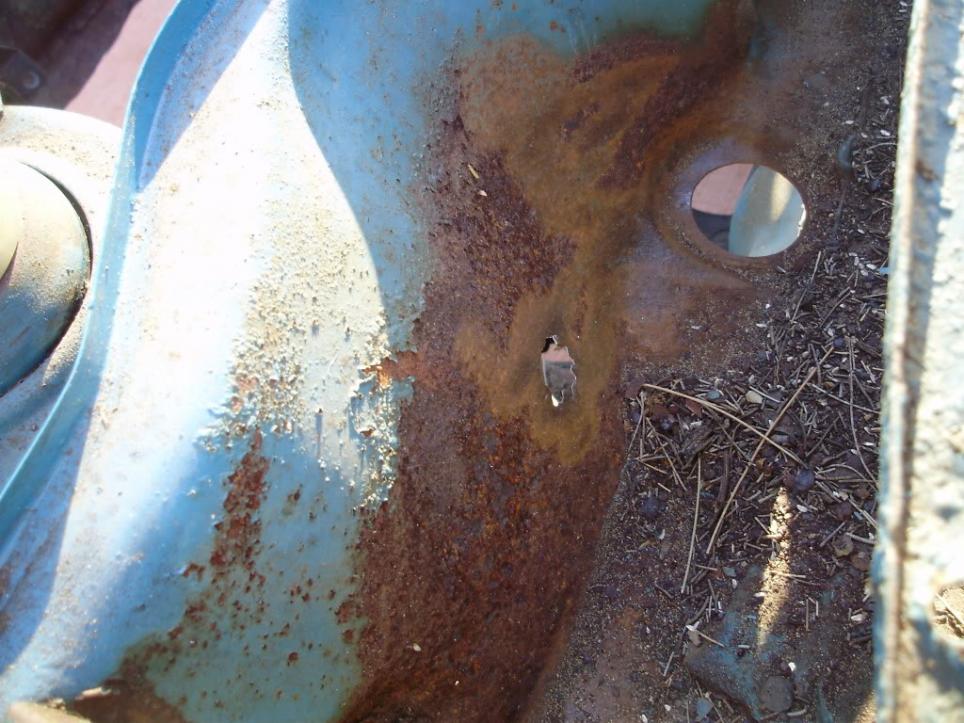

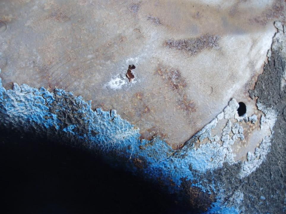

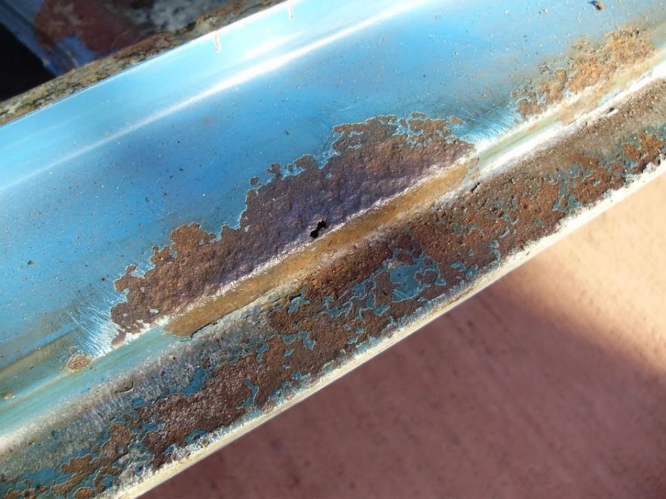

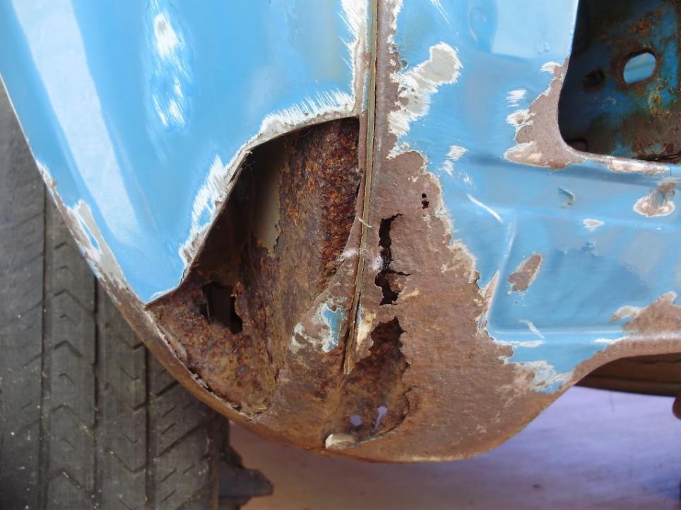

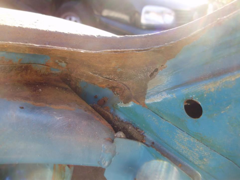

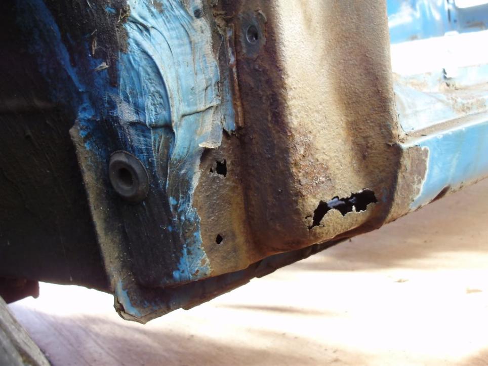

                        RUST RUST RUST
                        This is going to be fun.

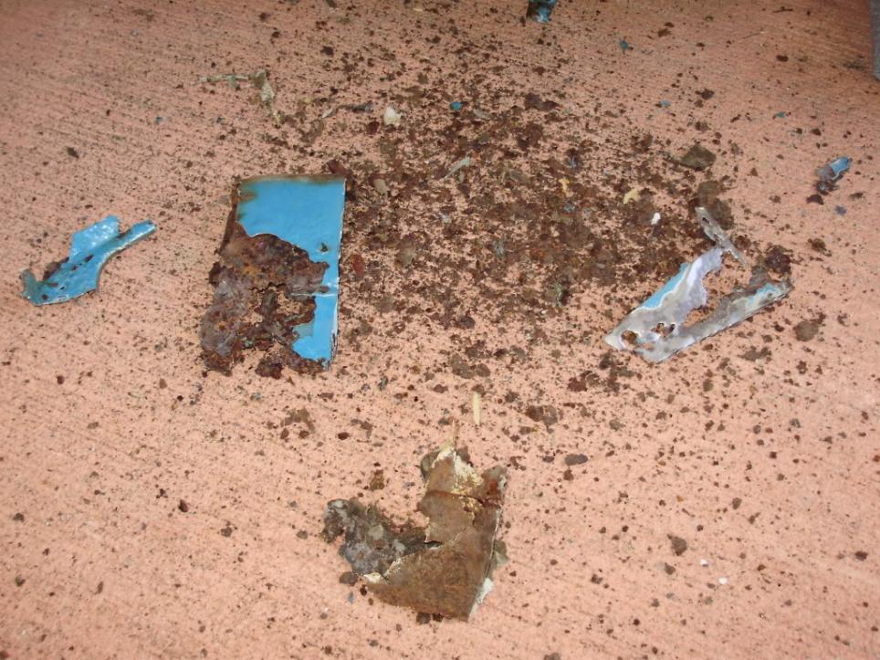

                        So all in all, lots of severe pitting and holes. I'm amazed at how thin the original steel was in places.
                        There's going to be a lot of money going towards grinder/dremel discs for this!!!
