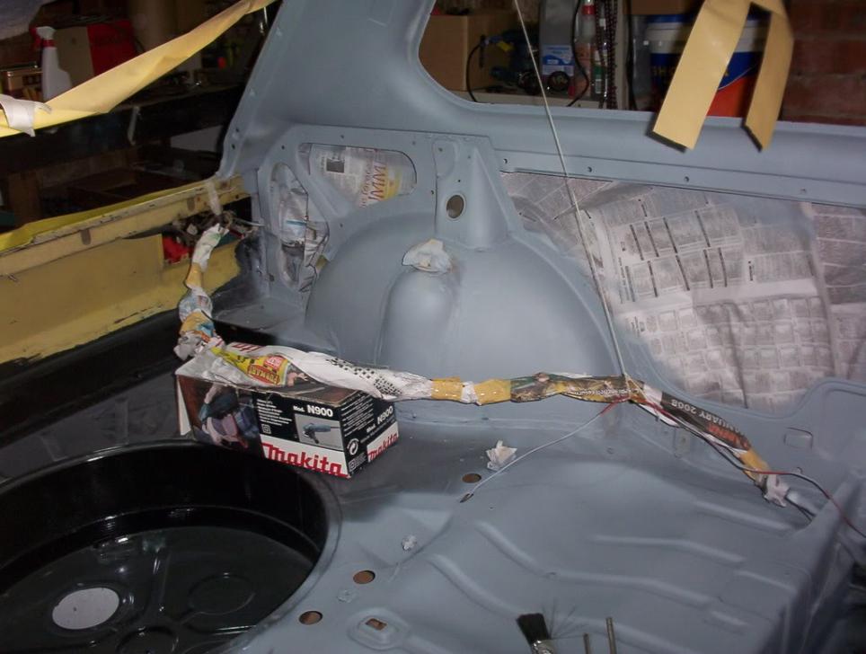

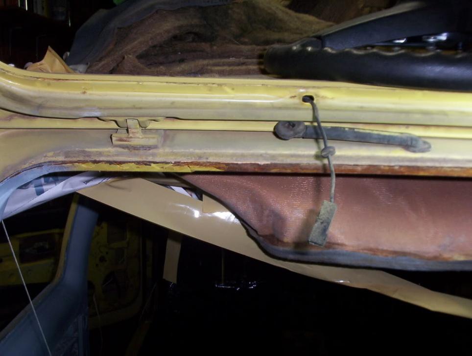

          Do I need to cut this wire ????????
          I'm sure a lot of people here has removed their Mk1 hatch, but I spend half an hour and still can not decide if i need to cut this wire in order to remove the hatch. Any idea ??
          btw, some update pic of my project
          nice coat of POR15 at all front
          POR15 at the rear, prime all vertical panel before new black top coat. The car will be black at the end.
          • #20
            Looking Good Eric, Did you get the bootlid off? You need to cut the wire , but leave enough, so that you can rejoin.

              ya i'm trying to take the bootlid off, i guess i have no other way except cutting the wire then .. i must say VW somehow is really over engineering
              • #22
                You could pull the wire out of the hatch but make sure you pull some string through as you remove the wire so you can get it back in.
                Gavin
                • #23
                  Gavin
                  I can see the wire run all the way to the fuse box, cutting it could be easier.

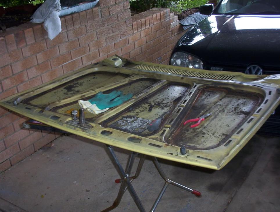

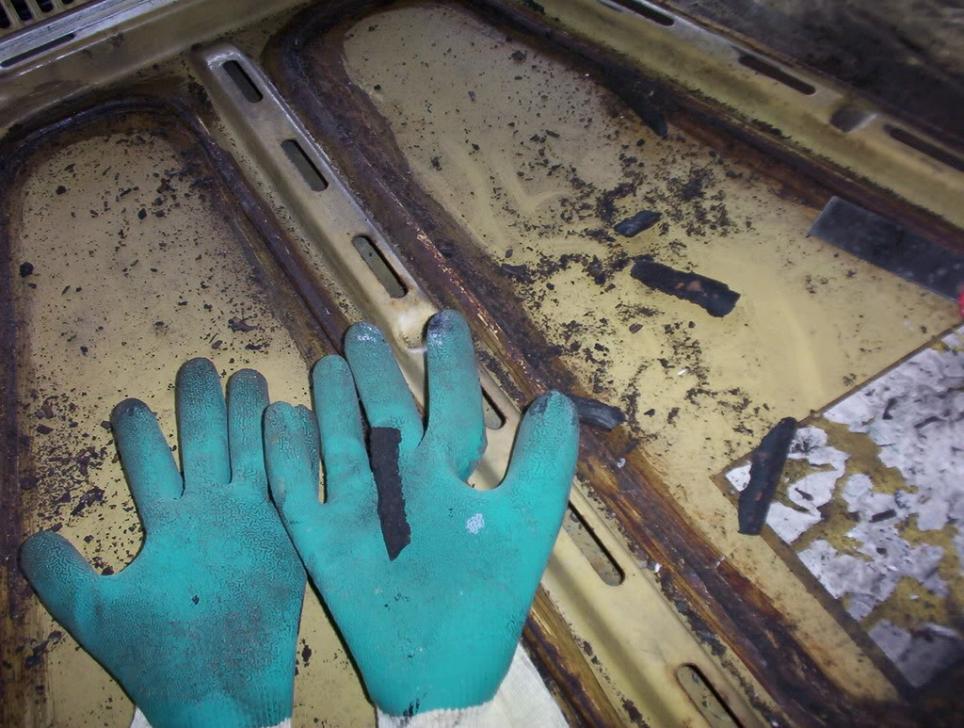

                    What are these filling material ?
                    cleaning the bonnet at the moment and notice these filling material between the skin and the frame, anyone what are they ?
                    They are dry and hard so I suppose I'll remove them all. After I repaint should I worry to refill them ? I think they are not just plastic filler cos it has to be heat resistent.
                    Ideally I should separate the skin and frame to properly clean up, but I don't know how to weld and don't have money to pay for smash repairer

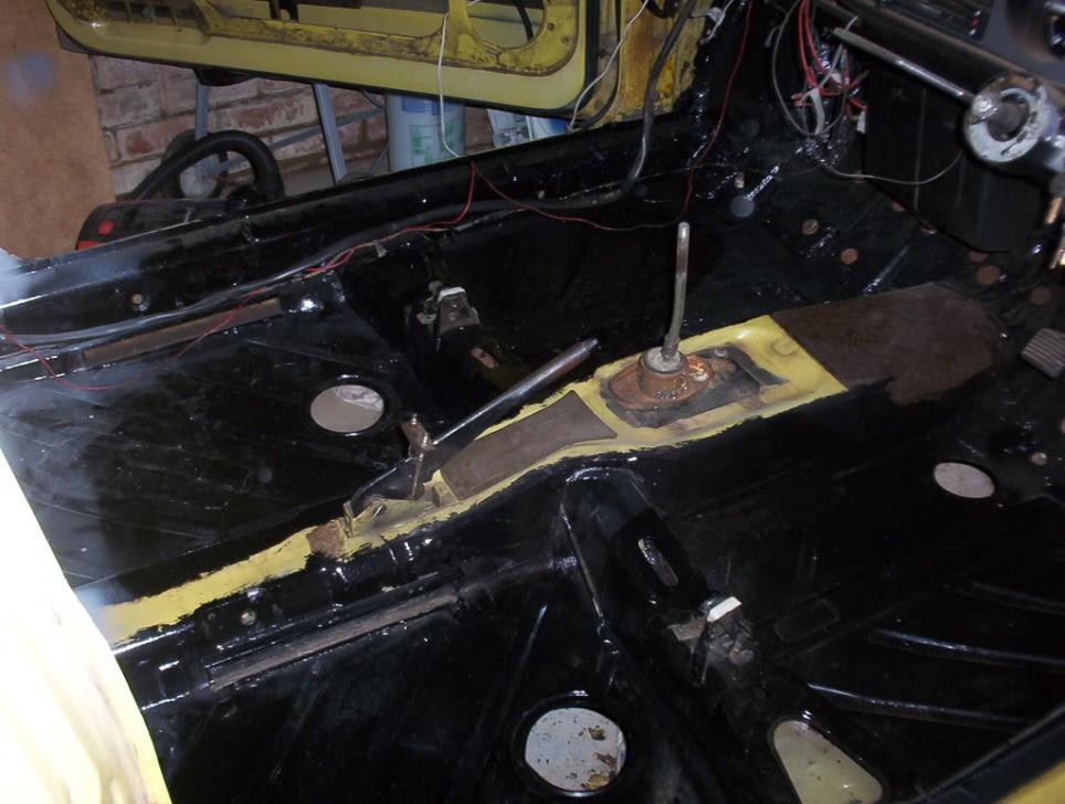

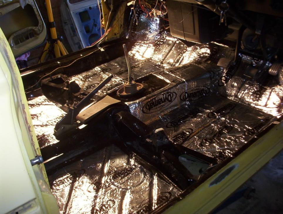

                    • #25

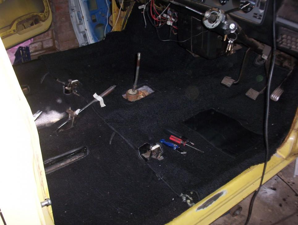

                      Some updates
                      Floorpan is done, how nice the POR15 coating is
                      Soundproofing
                      Some leftover for doors and quarter panel
                      New carpet
                      Will take some break this weekend before cleaning up the shell .
                      • #26
                        It's probably seam sealer. Ask your local panel beating supply shop. I got some for a Beetle I'm restoring from the Body Shop.(No - not Anita Rod****'s franchise - the panel beating supply chain.)

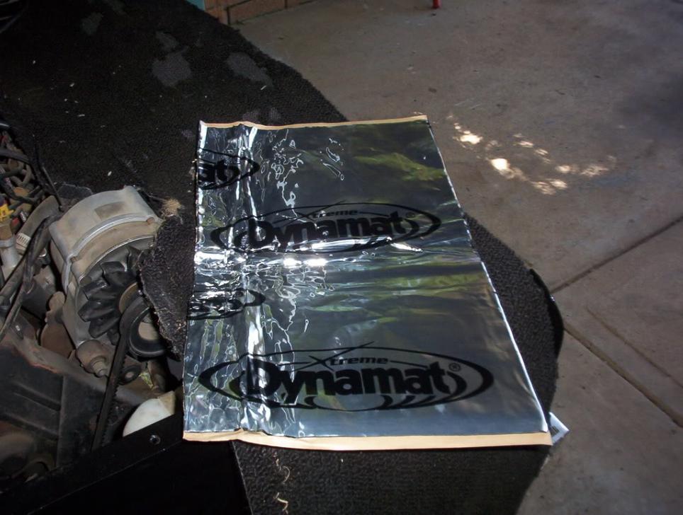

                        • #27
                          Lookin good mate!!!
                          What thickness is that Dynamat? did you get the 36 sq feet pack?
                          1986 MkII Golf GTI 16V (Sold), 2005 MkV Golf GTI (Sold), 2007 Polo GTI (Sold), 2011 Polo 66TDI (Selling), 2012 Passat 125 TDI Bluemotion, 2013 Scirocco R (Due October!)
                          • #28
                            Originally posted by anarchycamp View Post
                            Lookin good mate!!!
                            Dynamat Xtreme 8 sheets pack, still got plenty left over for other area.

                                WHOA!!!!!!!
                                Don't remove all the seam sealer!!!!! n:
                                IF you remove it all, it's VERY difficult to get the bonnet flat again!
                                You really should leave that to a smash repairer. It might cost you a couple of hundred, but it'll be worth it. Otherwise you bonnet will end up looking like the surf at manly!
