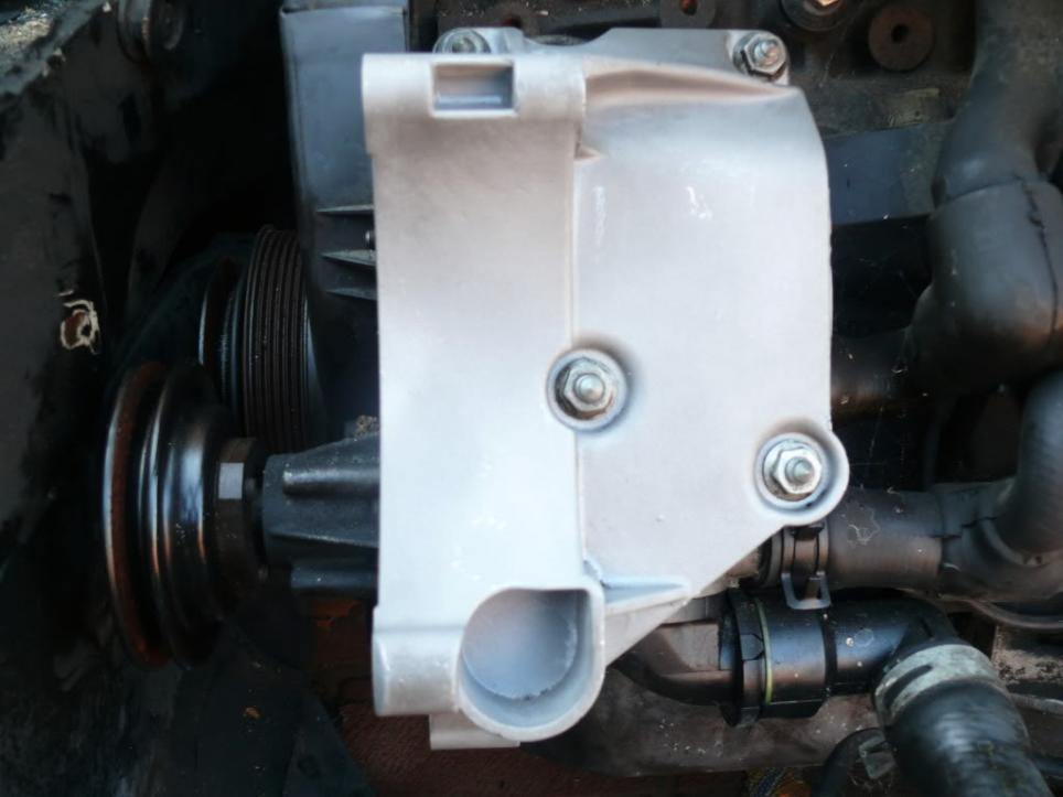

finally started some work on the abf engine today. i remove the p/s pump,a/c compresor,alternator,belts and various brackets etc. in with the new alternator bracket for a test fit and find out that the original alternator can not be used with it. bracket is original vw for abf non a/c. does anyone know what alternator should i look for?

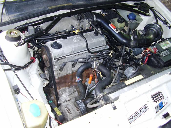

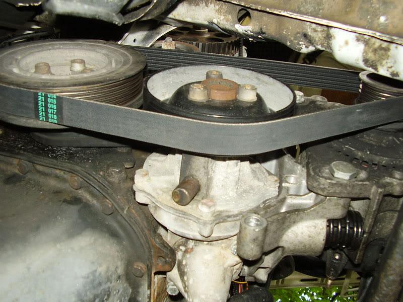

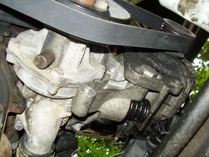

Notice the spring:
That's what tensions the alternator.You loosen the pivot bolt,and the 19mm tension bolt,and let the spring tension the alternator,then you just tighten the bolts and roll!

Either approach will work. The way I did it leaves the alternator quite high up in the bay which might interfere with the inlet side of things on a 16v. Other issue with my approach is that the tensioner interferes with the chassis rail unless you make a few adjustments.
Mounting it in the low position will be getting close to the front panel work that the radiator sits on. I'm not sure just how close.
I'm thinking of a very different approach for my 16v when I finally get around to it. Something off the back of the block like a compact hot rod alternator.
Got a feeling some of those parts to mount the alternator in the low position are hard to come by here, but might appear on some T4s.

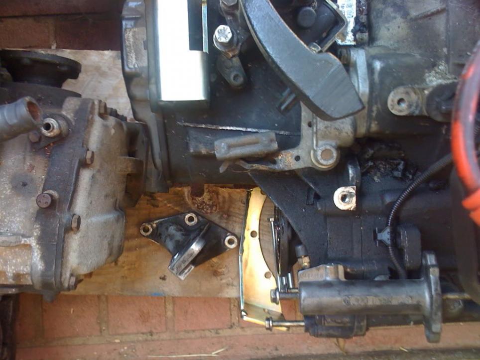

Small update on this

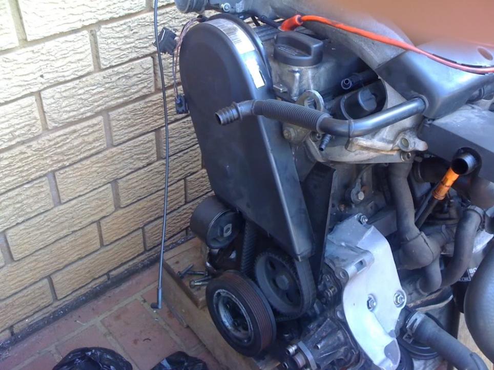

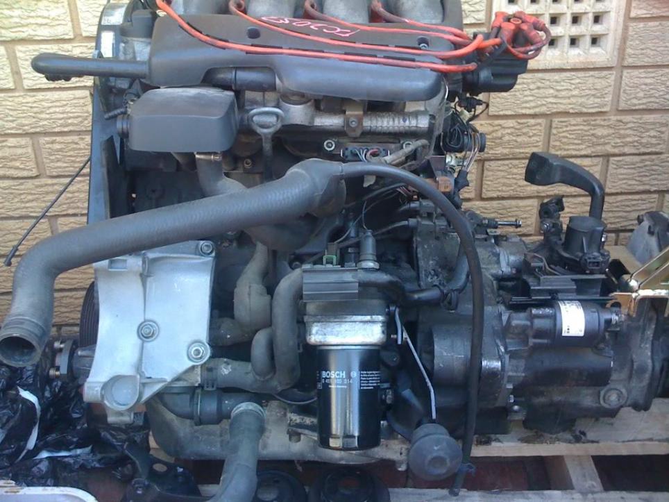

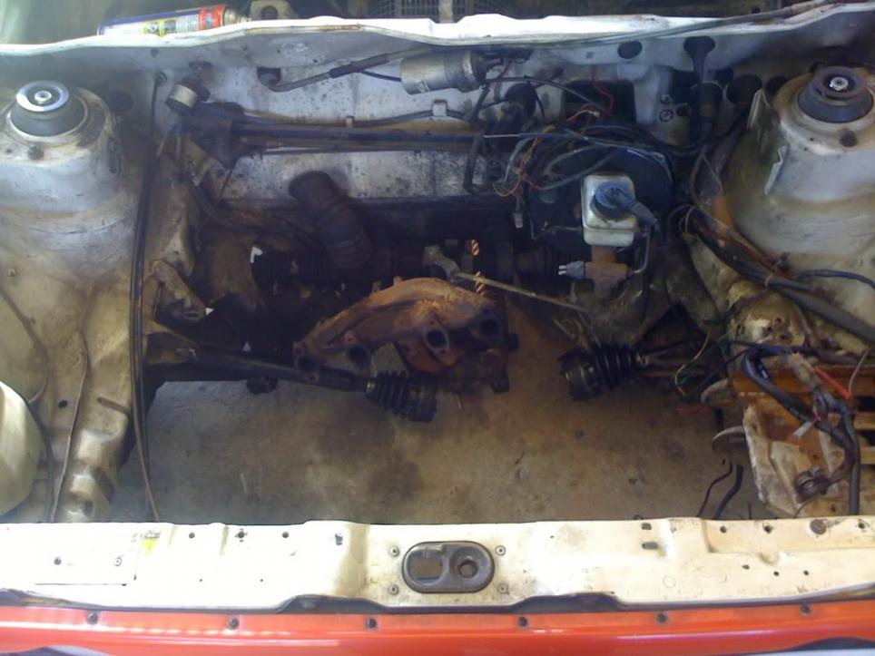

So far engine is out from mk3 and all mounts have been removed and replaced with mk1 mounts.Have decided to keep the 02a gearbox and have bought custom mounts to fit.The driver side mount need some spacer for two bolts as the mount does not sit flash with the engine.I have replaced the hydraulic gearbox mechanism with cable one.Engine is out from the mk1.Things look good just needs a good clean and tidy up-maybe respray.
Looking to buy some good rubber mounts inserts and the alternator to suit the set up. So far the hunt for the alternator has been unsuccessful.Also need to buy vr6 water pump pulley.I will be attacking the mk1 engine bay and trying to sort out all the wiring.

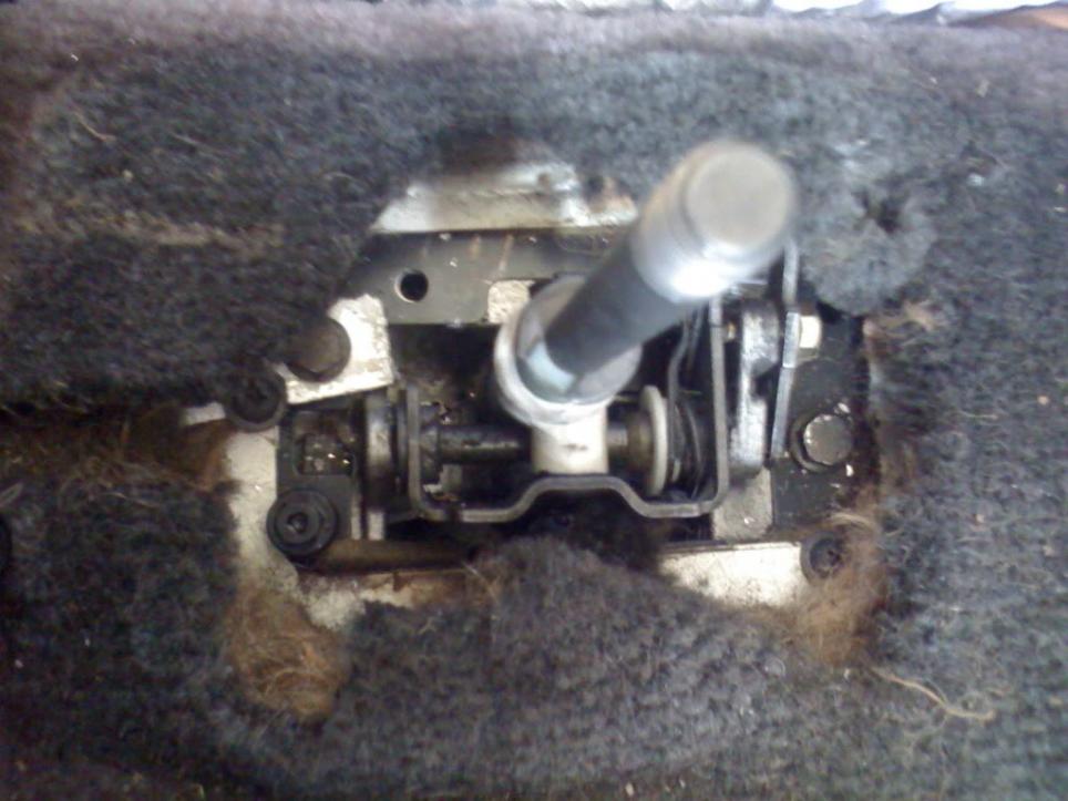

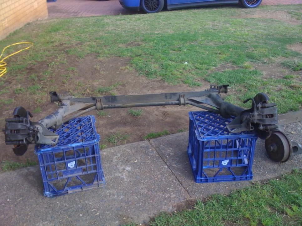

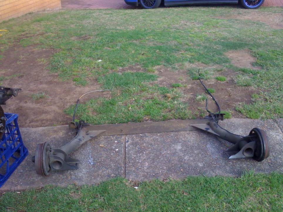

done some work . not staff that i was planning to do today but due to missing some tools work got diverted into other area.i installed the cable shifter,replace the fuel tank,rear brake upgrade and new handbrake cable.ordered tt race motor mount kit and try to buy a alternator with no luck.if i don't find alternator by the end of the week i will go for other set up like Peter Jones did with his car
