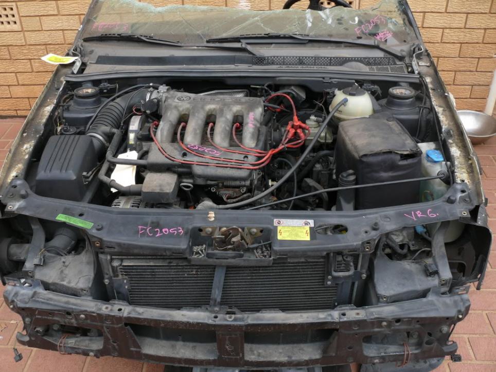

my project is looking much better after arrival of "japanese vr6" today. they call them this name as they are purchased and send from japan as a vr6. i believe this has happened i few time before.looking great with 60000km on the clock.have a look http://photobucket.com/wheels_03

curious to find out more about getting a half cut from Japan? where did you source it from if you dont mind me asking?
thanks mate, currently in talks-negotiations with Matt from Camden GTI so he may be doing this conversion due to lack of my time and experience.also car booked with panelbeater for respray as i wont be doing this in the backyard either.in saying that i will still be fixing minor things as i am sure there will be plenty of them to.

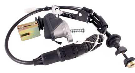

Yes, but the gearbox will still be as heavy as your car and you will have to fit the cable shift mechanism too.
Plus the massively long cable clutch will be really heavy and will pull through the bulkhead on a Mk1.sigpic Camden GTI Performance. VW / AUDI Specialists
I think what Matt is trying to say is "Use an 020 instead".Originally posted by Golf Loon View PostYes, but the gearbox will still be as heavy as your car and you will have to fit the cable shift mechanism too.

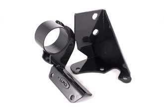

The block is only 10mm taller. Valver had/has a Mk1 with a Seat ABF in it...Originally posted by jayjay View Postis that an engine mount to lower the motor?

Nope, that's what's needed to bolt up the 02A Gearbox to the MK1.Originally posted by jayjay View Postis that an engine mount to lower the motor?
