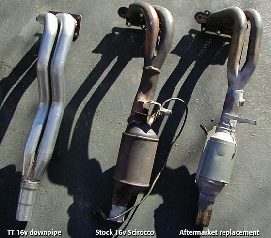

                      Will this downpipe fit a mk1?
                      It doesn't seem to have the lateral curve that most other mk1 16v downpipes have.

                              I bought the downpipe pictured above, turns out it does have a lateral curve just not obvious in the pic.
