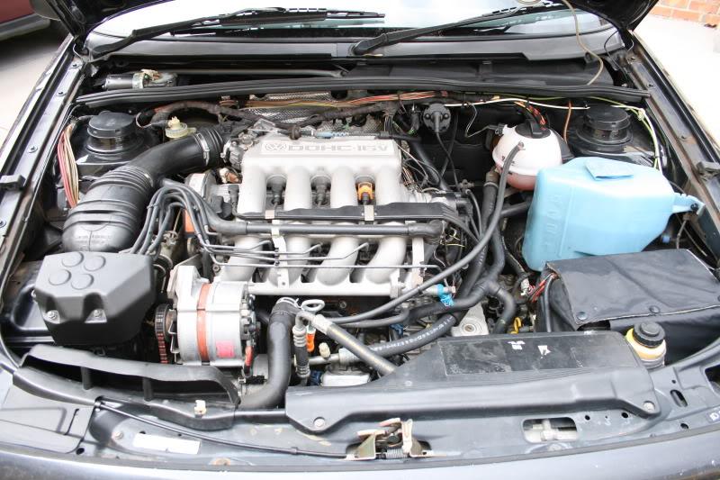

    basically i got the car pretty neglected, the car was 4k overdue in service, the timing belt was 2 teeth out making the 3rd gear top speed of a blistering 60kph and the paint is in less than average condition..... a plus side is that the interior is immaculate! except red dust EVERYWHERE!!!!
    anyways, basically the last few weeks were just getting the old girl running good again, so a major service and a complete filter change including all the belts ect was changed

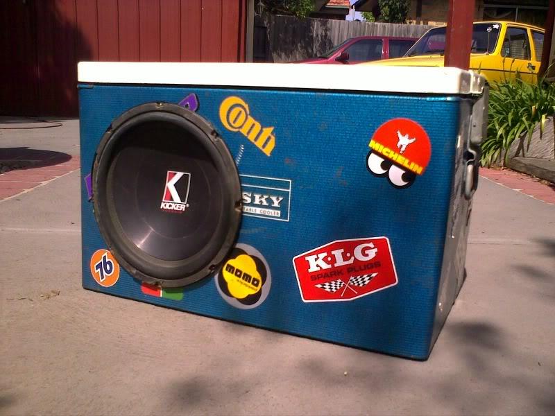

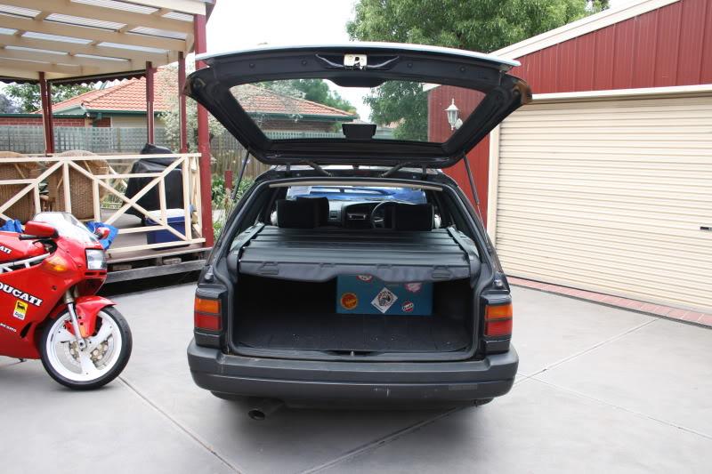

    then on the same weekend i installed my stereo system, its not crazy but does the job, i was sick of putting a carpeted black box in the boot making it look like its obviously got a subwoofer in the boot, so i chopped this up and turned it into my sub box

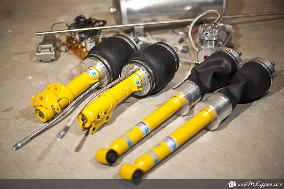

    i chose bagyard air bags because of their reputation and build quality
    ive chosen an 8valve bag system, that means no more airbag bodyroll as air does not transfer from one bag to another when turning, each wheel has an "air-in" and "air-out" valve, hence 2 valves per wheel, if it were and older style 4 valve system, 2 valves per front and back of the car, only 1 "in-line" and 1 "out-line" controlles both front OR rear struts, and ill also be dog legging with an individial wheel control system, in other words, front, back and side to side!
    bagyard air struts are made of specially build bilstein shocks re-dampered for air bag "springs", the shocks are also damper adjustable, same as the airbags obviously.......
    this is where people sometimes get confused and claim airbag struts dont handle well, this isnt the case no more due to new shock/valve and airbag technology, this will handle and ride just as well as coilovers if not better than some cheaper coilovers, obviously if its not slammed all the way down and if the shock dampers are set right, but isnt that the case for coilovers too?..... anyways.... the bag's ill be getting..........

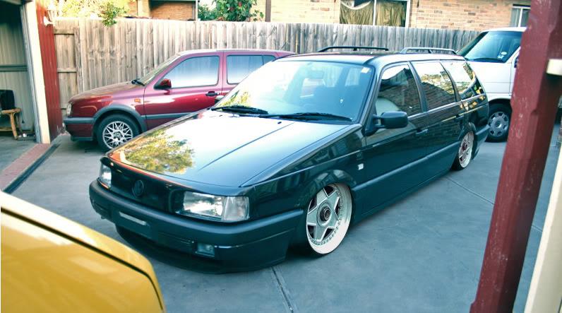

    an artist's impression thanks to "anth" on the forum who also runs buildthreads.com

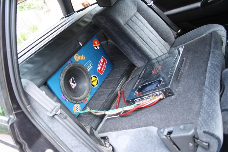

    an out of space on the first post to put my system installed pictures so here they are
    the plan was to hide everything as much as possible and to make out like there is no system at all, ive used all the OEM speaker grills and bought high quality speakers the same size/dimension as the original speakers.......
    here is the sub box installed along with the amp and cables all hidden behind the esky

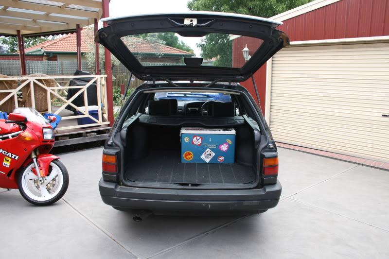

    also a pic of the leather boot cover closed, you wont see the sub box with the tailgate closed

      AHAHAHAHA that esky is BEST!!!!

        the maddest esky ever!!!

                That should look awesome on its guts, love the esky.

                    Esky is the shiz aswell

                      love the smooth grill, i have always wondered about this grill and cooling but it obviously works, must pull air from the lower bumper section??

                            btw nice ducati in those pics

                              as for the grill, the VW badge is a cooling system, when you open up the bonnet, you see a few plastic fairings that lead to the airbox
