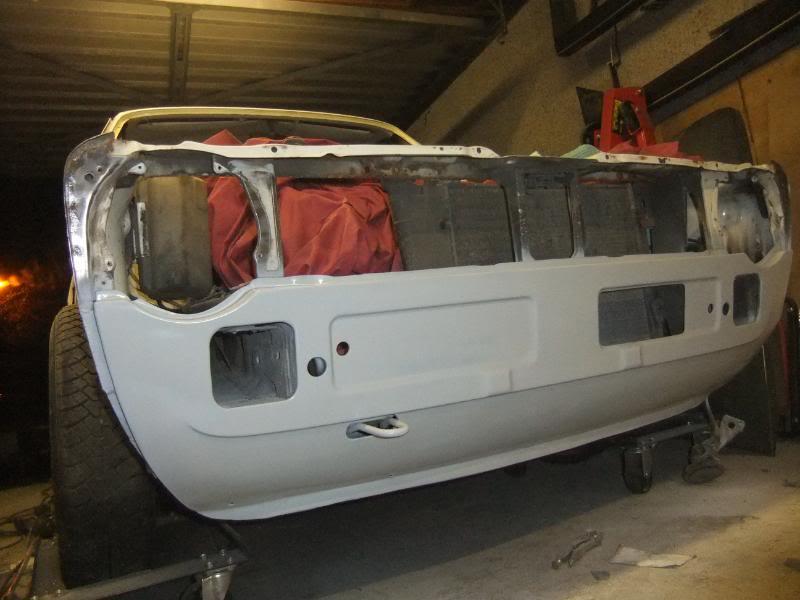

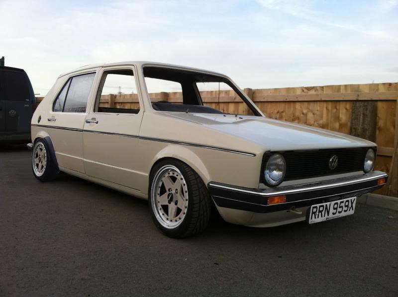

I found a caddy in the colour Im painting mine. This is olde english white.
And heres what im after. Photoshop FTW
I think it keeps it looking retro. Fully polished is nice but doesnt look as retro I dont think. Plus they are winter wheels so they will be ruined in no time!

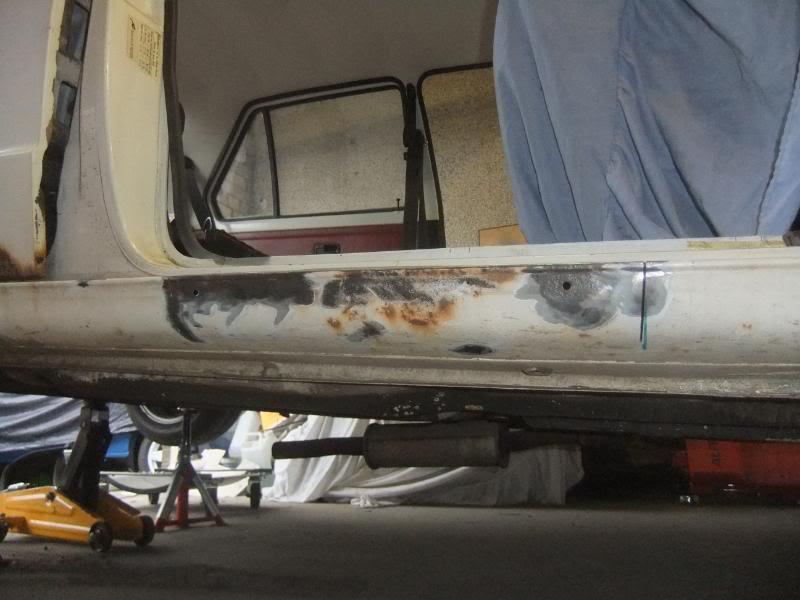

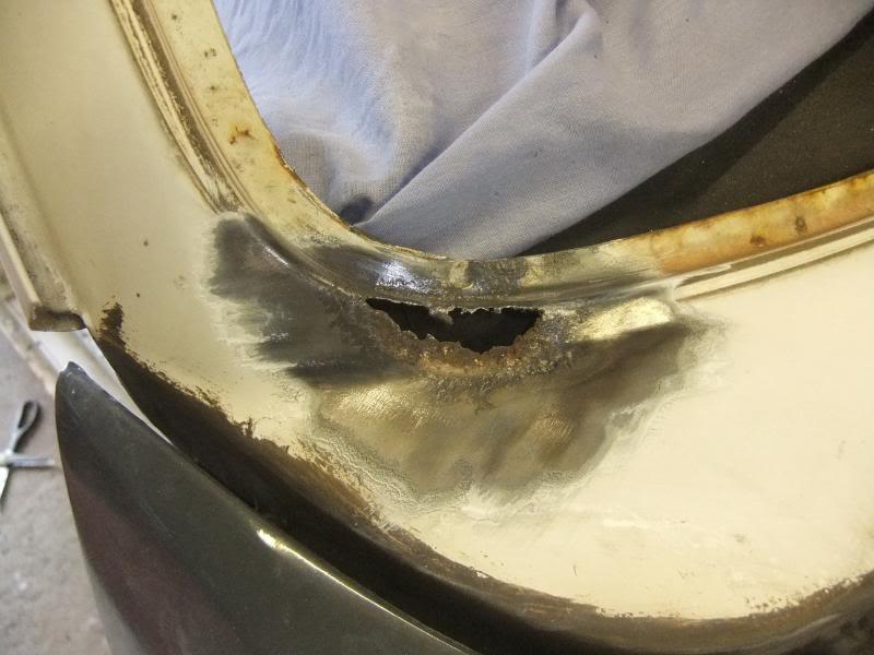

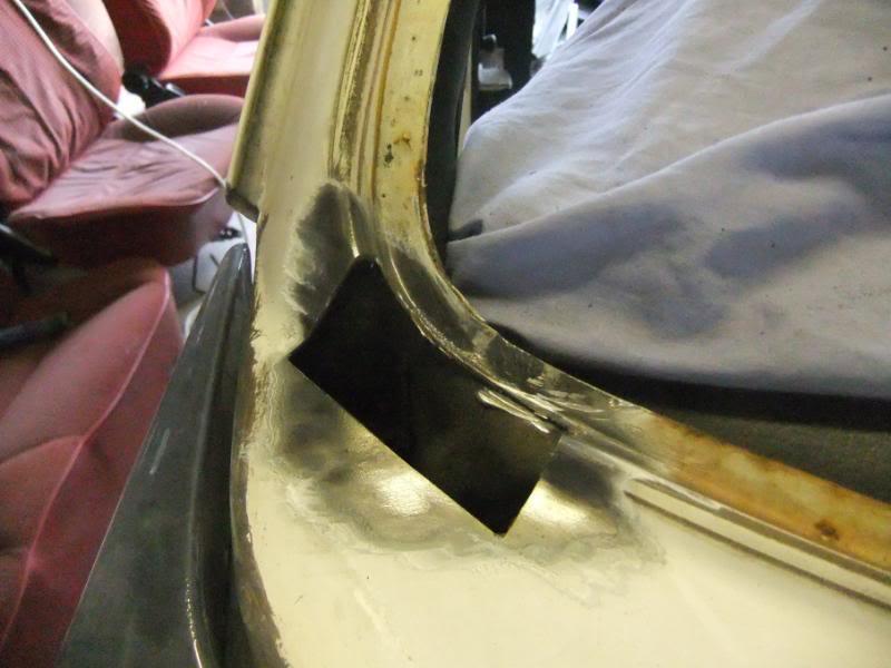

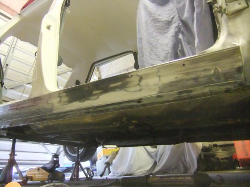

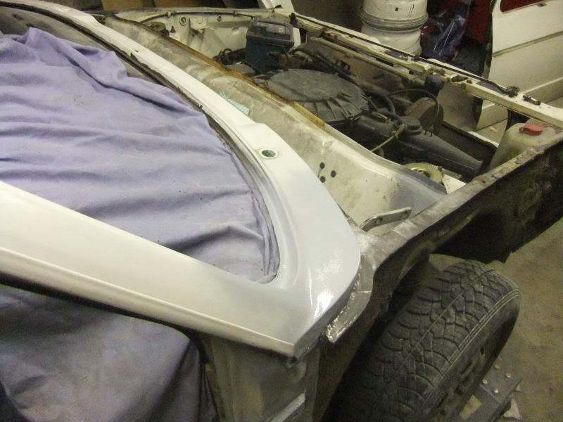

IM AMazed at your patience with al those rust spots to work on!!
your putting many of us to shame LOL All the best! i like that color as well! its a little creamier than what ive been planing paint the Caddy
Cool tread on those tyres hey

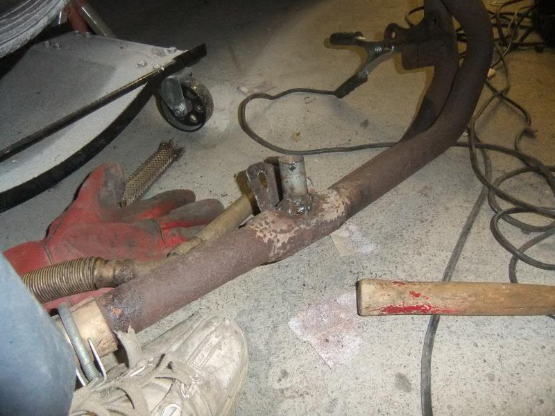

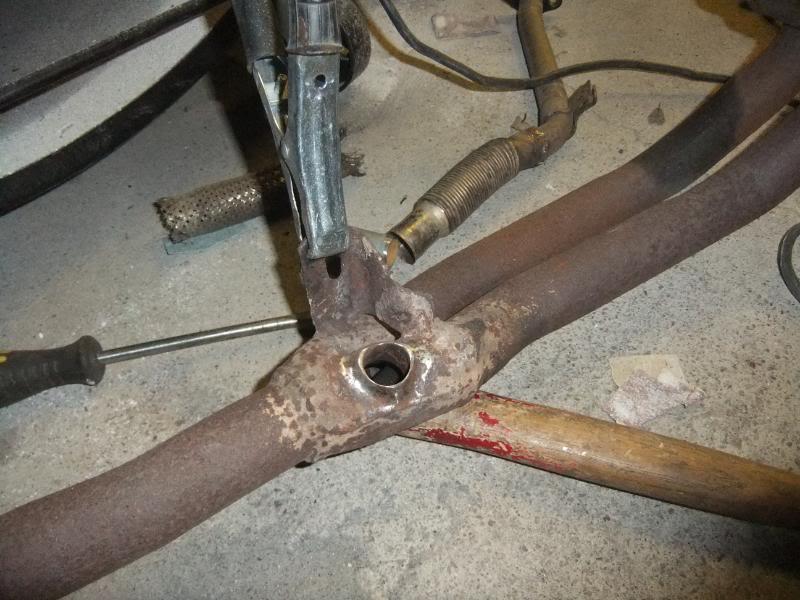

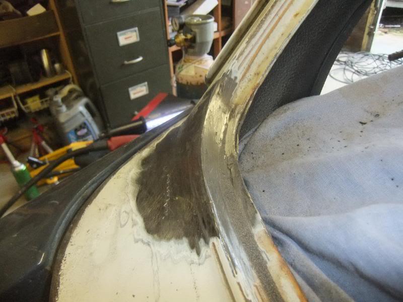

Then I moved onto the exhaust. All the hangers had rusted and fallen off, 3 manifold studs had snapped and the recirculating pipe had rusted off completely from the downpipe so I basically needed a whole new system but thought Id see what I could do.. So for the downpipe I cut up a steel pole from our old gazeebo and welded it on Perfect diameter
I welded the hangers back on and drilled out the manifold studs and re tapped them. New gaskets came in the post yesterday so its all ready to fit

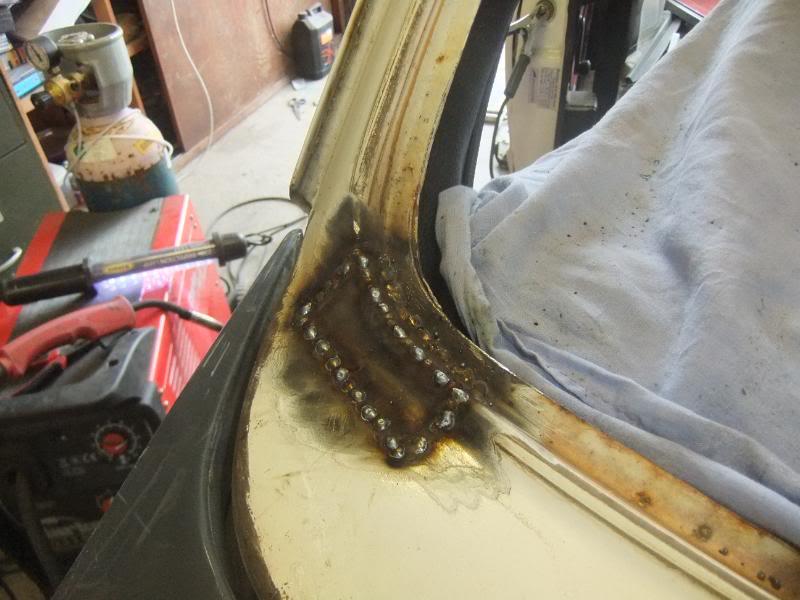

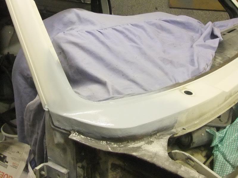

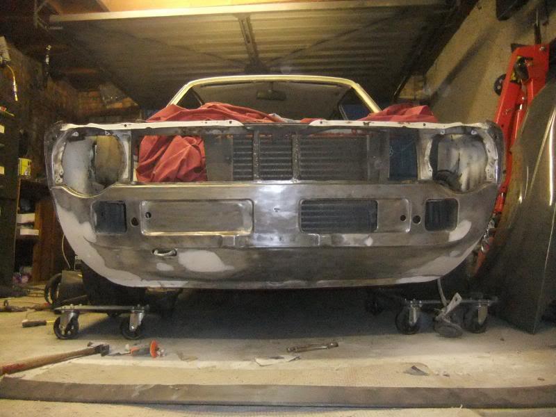

Yea nice work there Ross. Its great to see some serious body reps being done and put up on here. Its something i'm gonna have to do soon so I'll be going back over this info later
