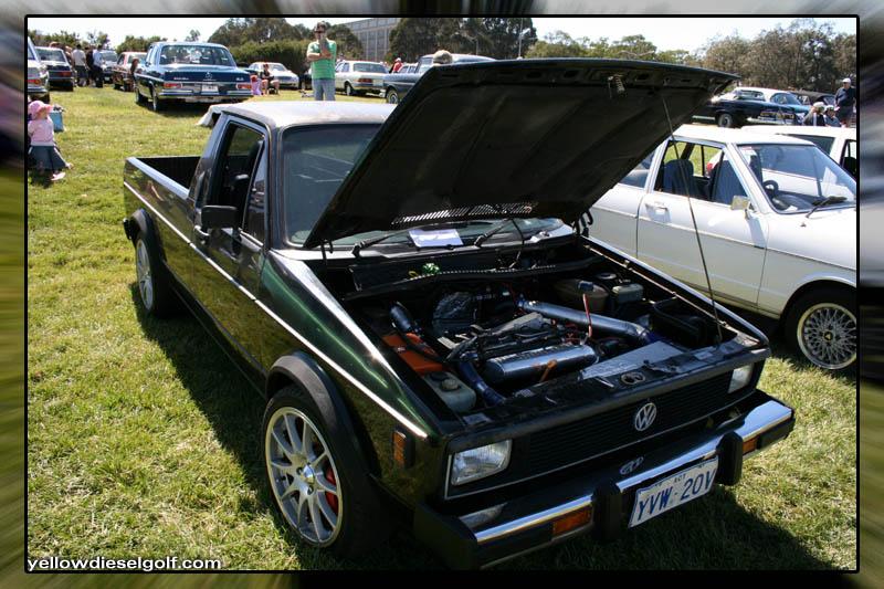

Nice Pic Yellow Diesel Golf.
My favorite Caddy.
